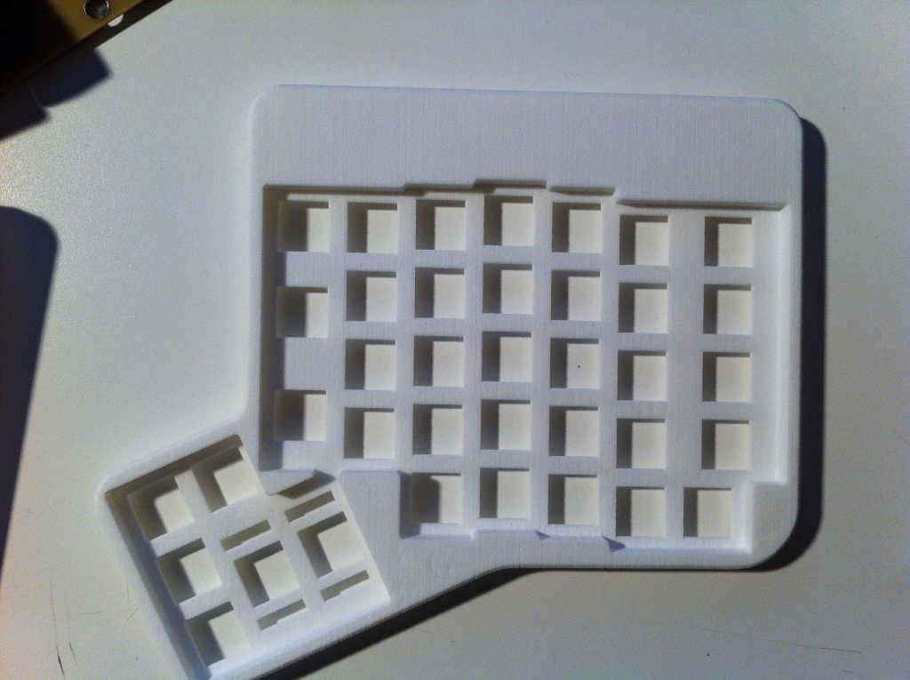

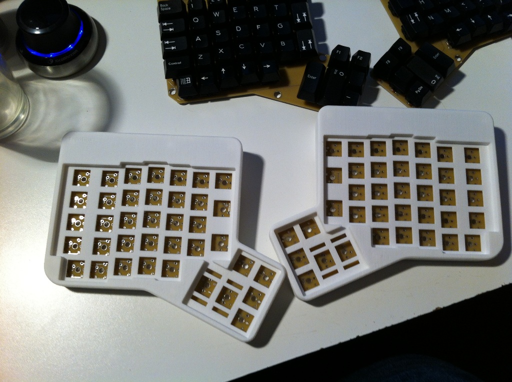

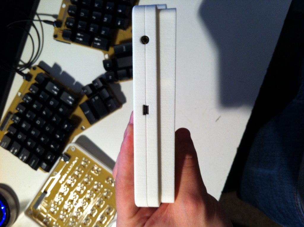

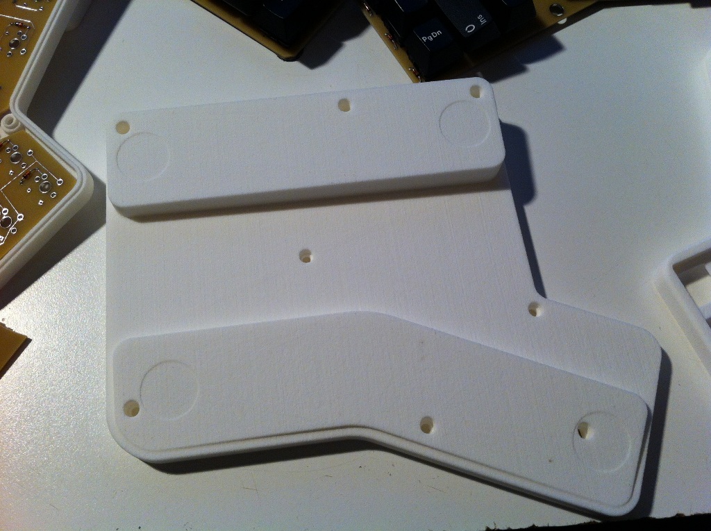

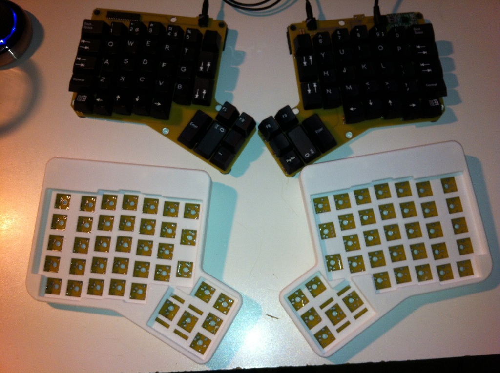

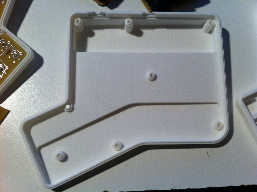

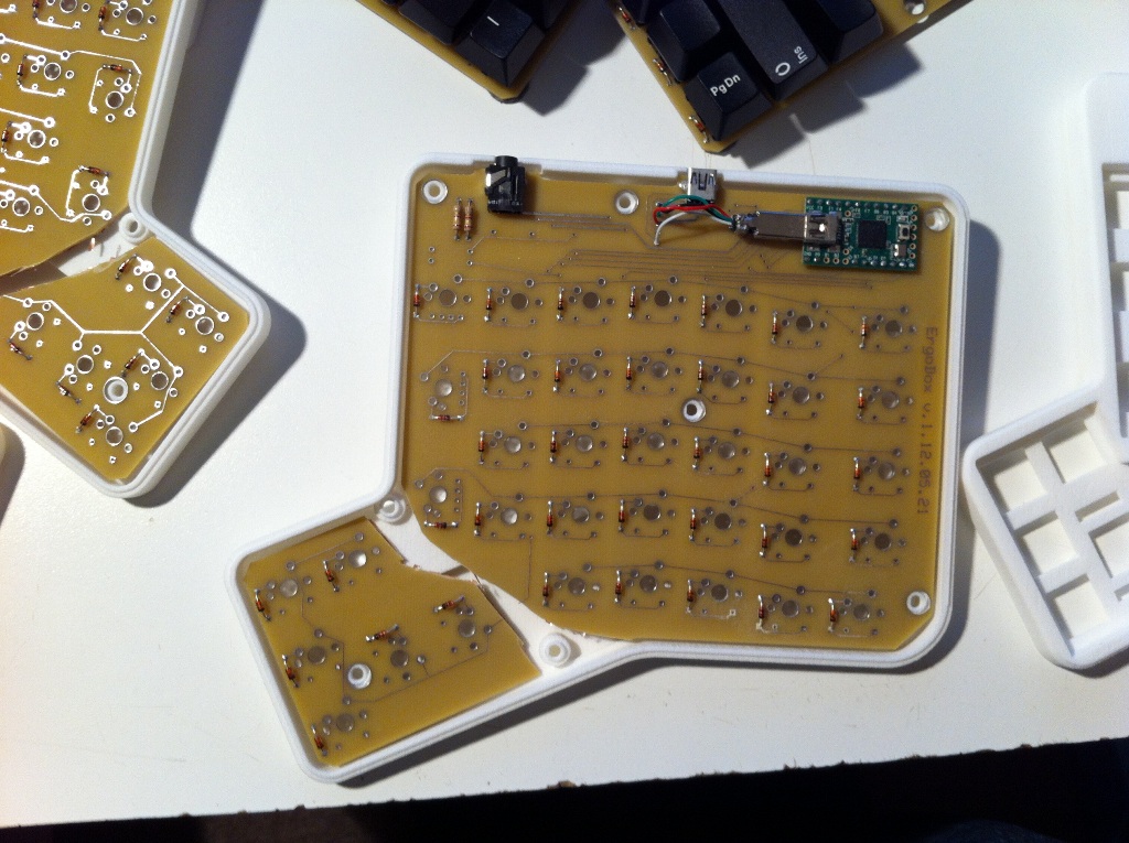

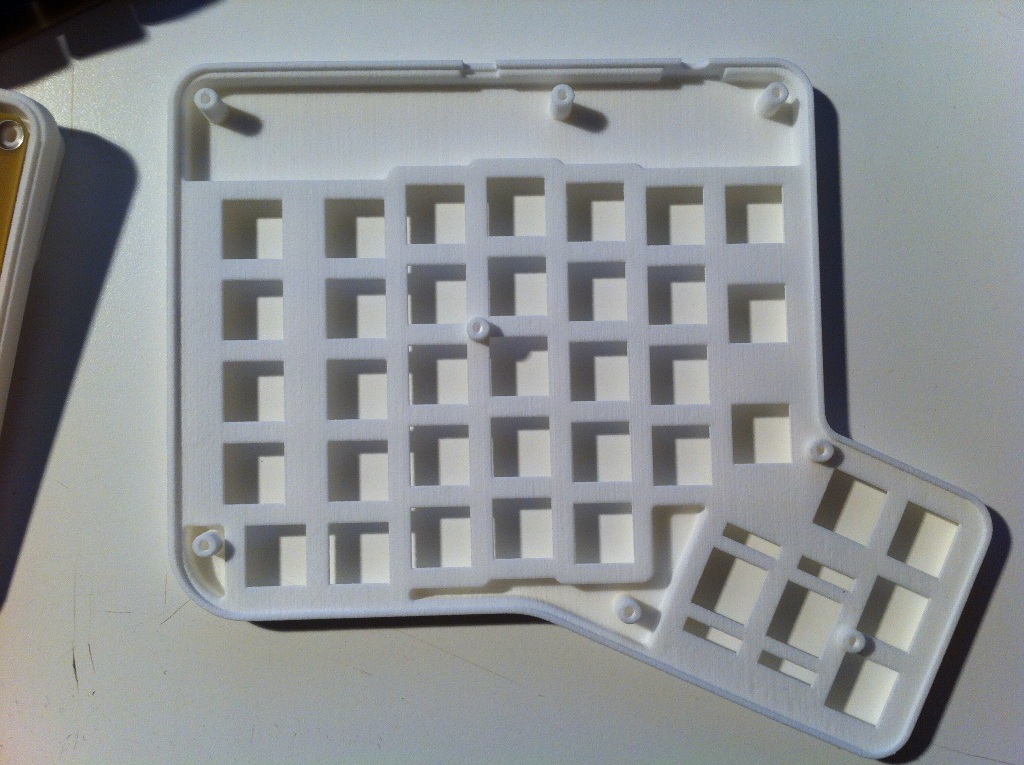

Pictures!
10 Jul 2012, 00:24
Oooh, that looks very nice!

dorkvader
10 Jul 2012, 05:18

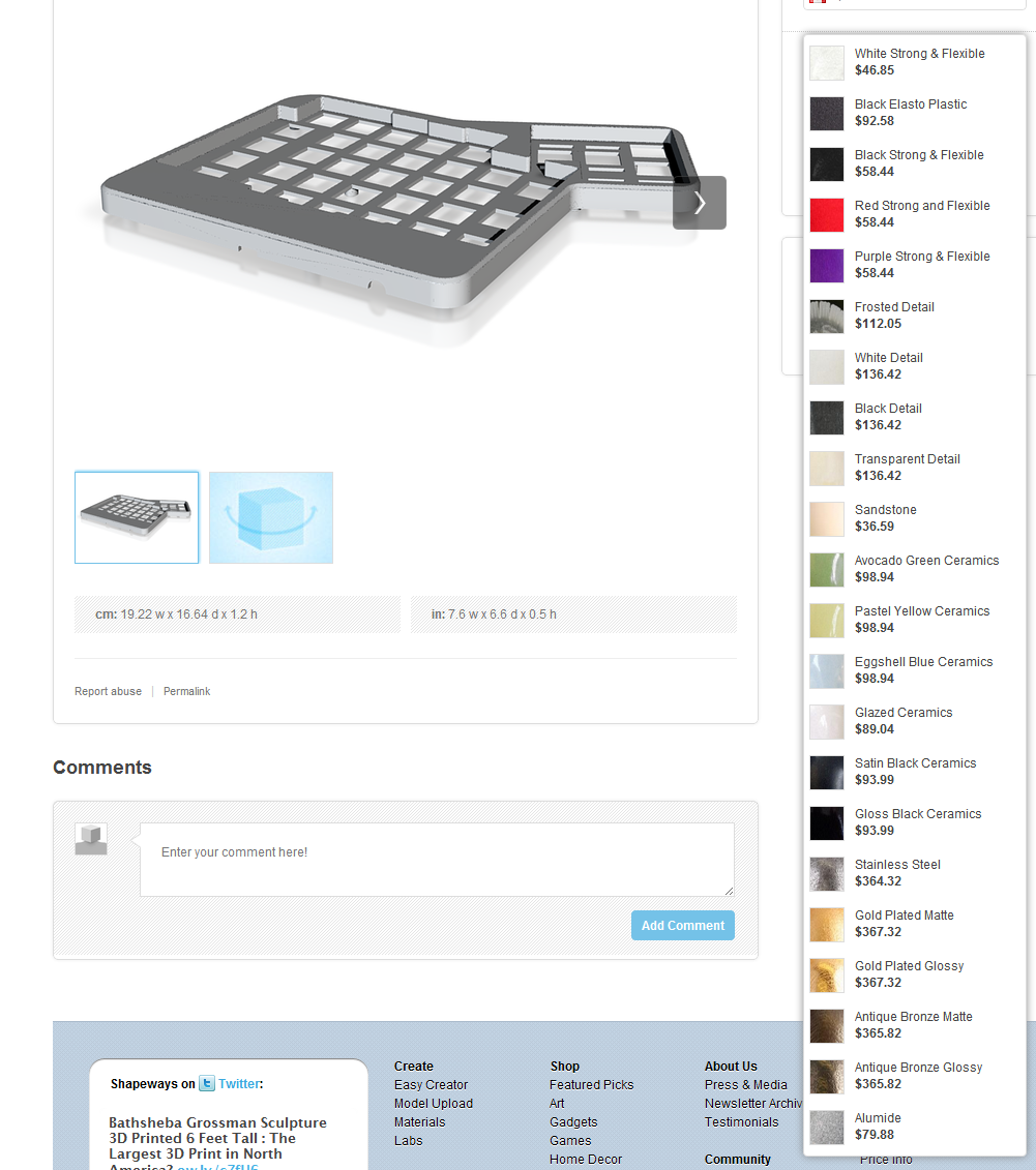

Yeah, that shapeways case isn't half bad! I wonder if we can also do it in cermaic, though.
Of course the metal stack is the best option, but we need to find a place that can do it cheaply enough.
Looks excellent, DOX!
(List will be updated shortly)

Ceramic is possible, as well as gold plated stainless steel.

Really like the glazed ceramic look.

Yes. Yes. Yes... I can't believe how well the case has turned out.

Dox very well done, how do those cases discount with scale? 50 orders, 100 orders, does the price decrease by much?
I worry that glased ceramic may be a little brittle. The Alumide but polished may be a good compromise.

dirge wrote:Dox very well done, how do those cases discount with scale? 50 orders, 100 orders, does the price decrease by much?
I believe we won't use this service for the alu case, this is just to make the prototype.

Fair enough the price is pretty high. Just that Alumide/Polished looked pretty close to being a metal finish and wasn't too expensive. Would get these on desks sooner too ;)
But the prototype does confirm that his case design is spot on. Really is a stunning bit of work.

Did you consider using one double sided board layout and simply flipping the board over for each side?
Depending on volume you could make a significant saving on the manufacturing costs of the boards that way.
I am not sure which CAD tool you are using but it should be pretty easy to load 2 different netlists in PCB (gEDA), perhaps not at the same time though :-P

I've been discussing making the PCB flippable with DOX only a little. I think it should be done, I don't know his stand point any more. I understand if he wants to stay with the design as it is now not to delay the project any further. I have also made a very rough KiCAD setup as a proof of concept. That would need some more work though.

So flipable PCB would that lower costs as it makes them all the same but also allow for people to use one board as a game controller for the left hand?

Making the PCB flippable is quite straight forward. It would require two jumpers to connect ground and +5v correctly, but that is all I think. Benefits from having a flippable PCB
  • Lower costs since all the PCBs are the same (price decrease settles at higher numbers so this would be most important in low numbers)
  • Easier sorting and handling
  • Each one could choose to have the USB cable coming out of the left or right part (not very important probably)
  • A single PCB could be used to make either a left or right hand only keyboard (with a non-flippable PCB only a right hand keyboard is possible).
pingbat
10 Jul 2012, 20:59
Quickly thinking about it you might not even need that jumper. If you use the USB for power, any LEDs could just be installed backwards if needs be.

Is the whole thing charlieplexed? Looks like the plug for the second board is just a headphone jack. Are you using 1 Wire and a 3 pin jack or i2c and a 4 pin jack?
