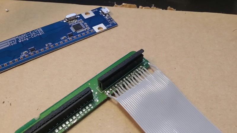

When I first started to solder leads to the small piece I harvested from the original IBM controller I had some issues because they were un-tinned solid core copper. So I took an old ribbon cable and spent some time dressing up the ends and was able to successfully attach it to the little header board. Everything checked out electrically but I wasn't happy with the solder work and it was very bulky.

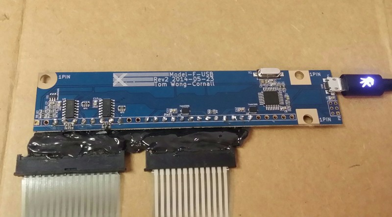

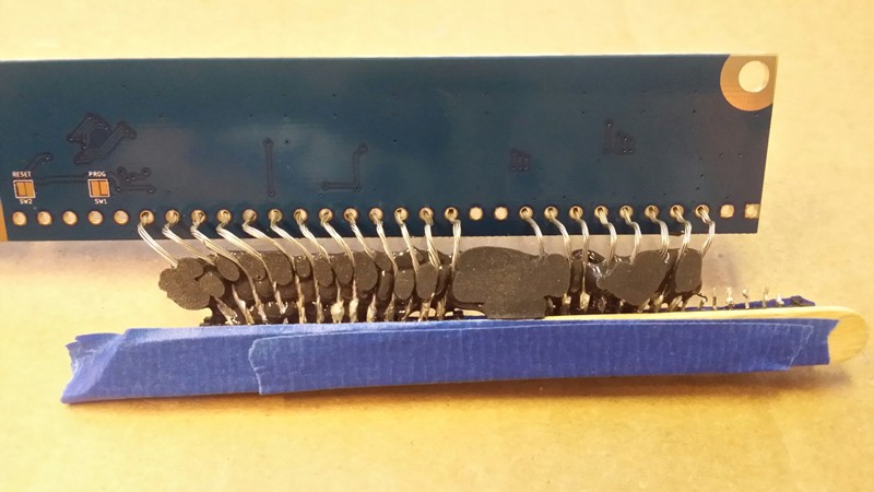

After fiddling around with how everything would lay out in the a case it was clear that unless I wanted my compact board to resemble a bigfoot I needed a different plan. The membrane leads are very long as the original controller had been mounted up inside the typewriter it came from. The membrane leads need to wrap down and around the mounting plate with the controller on the bottom of the keyboard in order to keep it compact. The solution was to harvest the membrane connectors and build my own adapter to the xwhatsit. I then soldered some bare leads to the the salvaged connectors and then dressed them out into their appropriate positions on the xwhatsit. Once I was positive about the positions I potted the leads with a strip of epoxy.
header 4.jpeg (80.9 KiB) Viewed 3515 times
After the epoxy setup I trimmed the leads to the proper length on the xwhatsit side of the new adapter and added more epoxy to fully encase the leads and finished soldering everything up. It's not real pretty and if I ever do something like this again I will make up a small form and pour a less viscous epoxy into it for a cleaner result. Otherwise I am pleased with the result. The connection is solid and it is serviceable as the epoxy is not bonded to the xwhatsit.

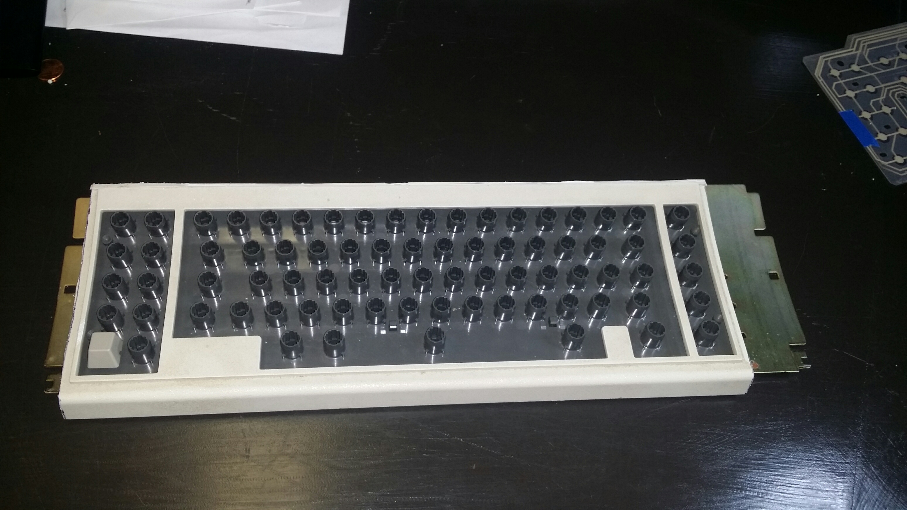

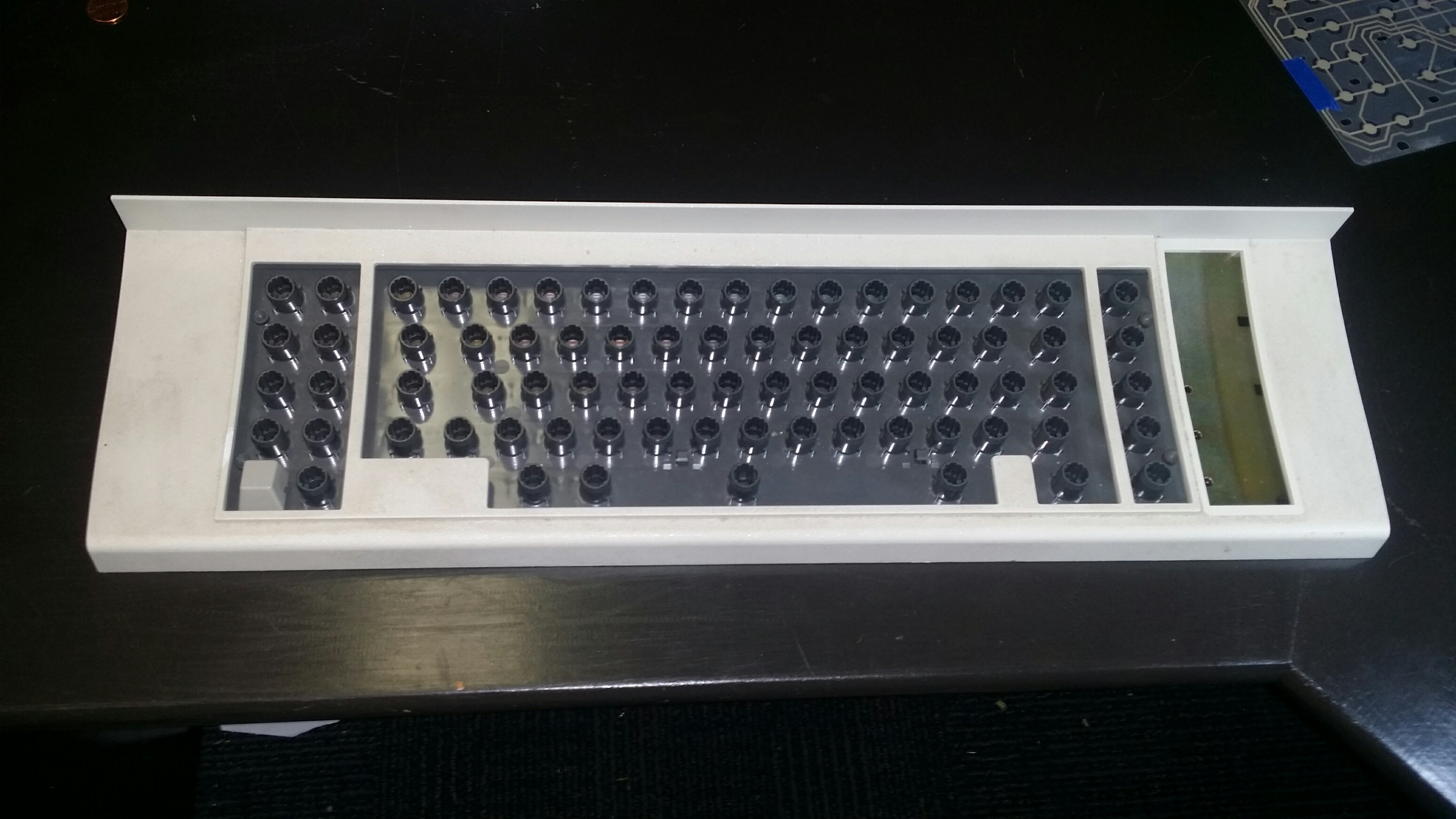

Started working on the case and decided I would hack down the original as a starting point by lopping off over 4 inches in the width. I will need to cut down the metal plate as well. I did test some scraps and they appear to be solvent weldable so I will reuse the ends after they have been trimmed and filed to a minimum. Because the keyboard originally came from a typewriter there is no base plate or cover for the topside and those will need to be fabricated. I may be able to find some suitable material in my stash of old rubber domes otherwise I will do something with composite materials.
Ends trimmed and top flange removed.

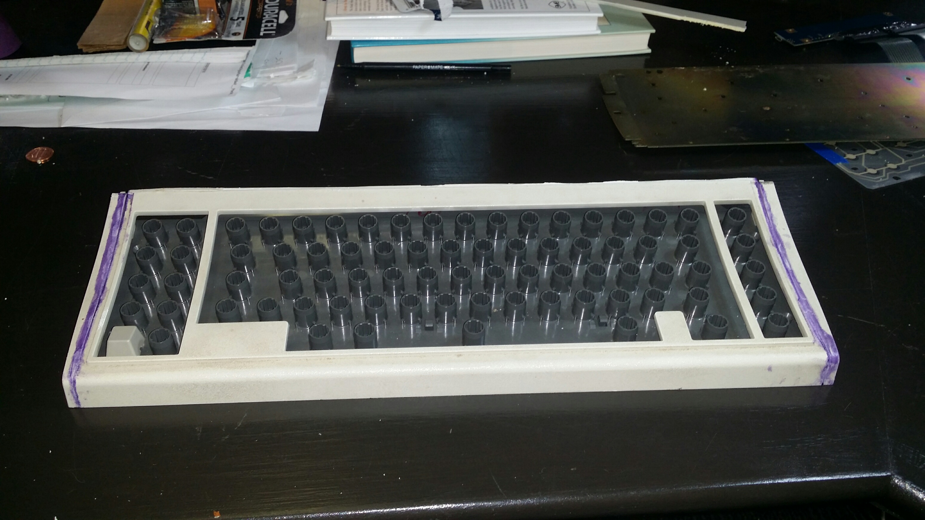

Got the ends trimmed, edge sanded and glued during my lunch break.The case is starting to take shape. :)
Can't hardly wait to see what this little board is going to look like with some SBS caps on it.
[ XMIT ]
22 Jun 2017, 20:42
Model M cases are made from PVC plastic so it doesn't terribly surprise me that these are solvent weldable. That's a good trick to know! I had a Wheelwriter typewriter keyboard with the full case assembly and I tossed the assembly. D'oh! But this is still encouraging to know for Model M chop projects.
