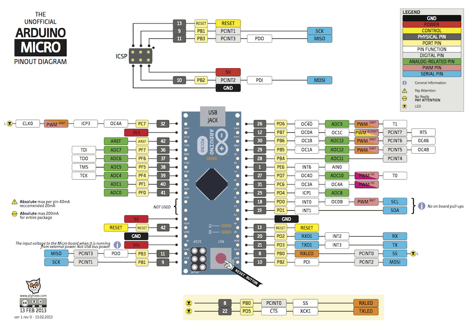

The Model M uses an 8x16 matrix, 8 rows and 16 columns for the max possible of 8x16=128 keys. However, since the keyboard controller connecting the membrane for this Unicomp is located on the right side over the numpad, cutting the numpad means there will be no membrane connectors. There are 24 lines, 16 for columns and 8 for rows that need to be intercepted somewhere on the membrane. I use copper tape to reroute the membrane circuit out to its new controller as seen in some of my pictures.
4. The controlling:
I actually started with this step. I have been making converter and controller using AVR controller, atmega32u4 in particular for years. Teensy 2.0 is always a preferred choice and easiest to programming with. For me, an Arduino Micro is just as good and a bit cheaper. Anything with atmega32u4 chip with enough i/o pins (24 port pins in total) should work. Beware that the Sparkfun Pro Micro, being the cheapest atmega32u4, doesn't have enough i/o pin for Model M, though.
Arduino Micro Pinout, notice the i/o pin names, pc7, pb1,pb3, etc.
Arduino Micro Pinout.png (365.57 KiB) Viewed 3712 times
For the firmware. I'm a big fan of Soarer. So, my Unicomp SSK has Soarer's controller under its hood. Please see details here: workshop-f7/soarer-s-keyboard-controlle ... t6767.html
And here is my Unicomp SSK config file for the Soarer's Controller:
The i/o pin names correspond to the pinout diagram above.
