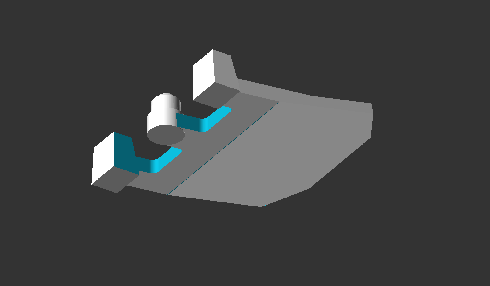

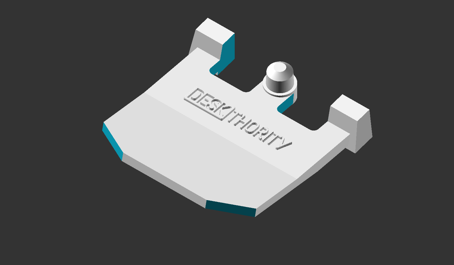

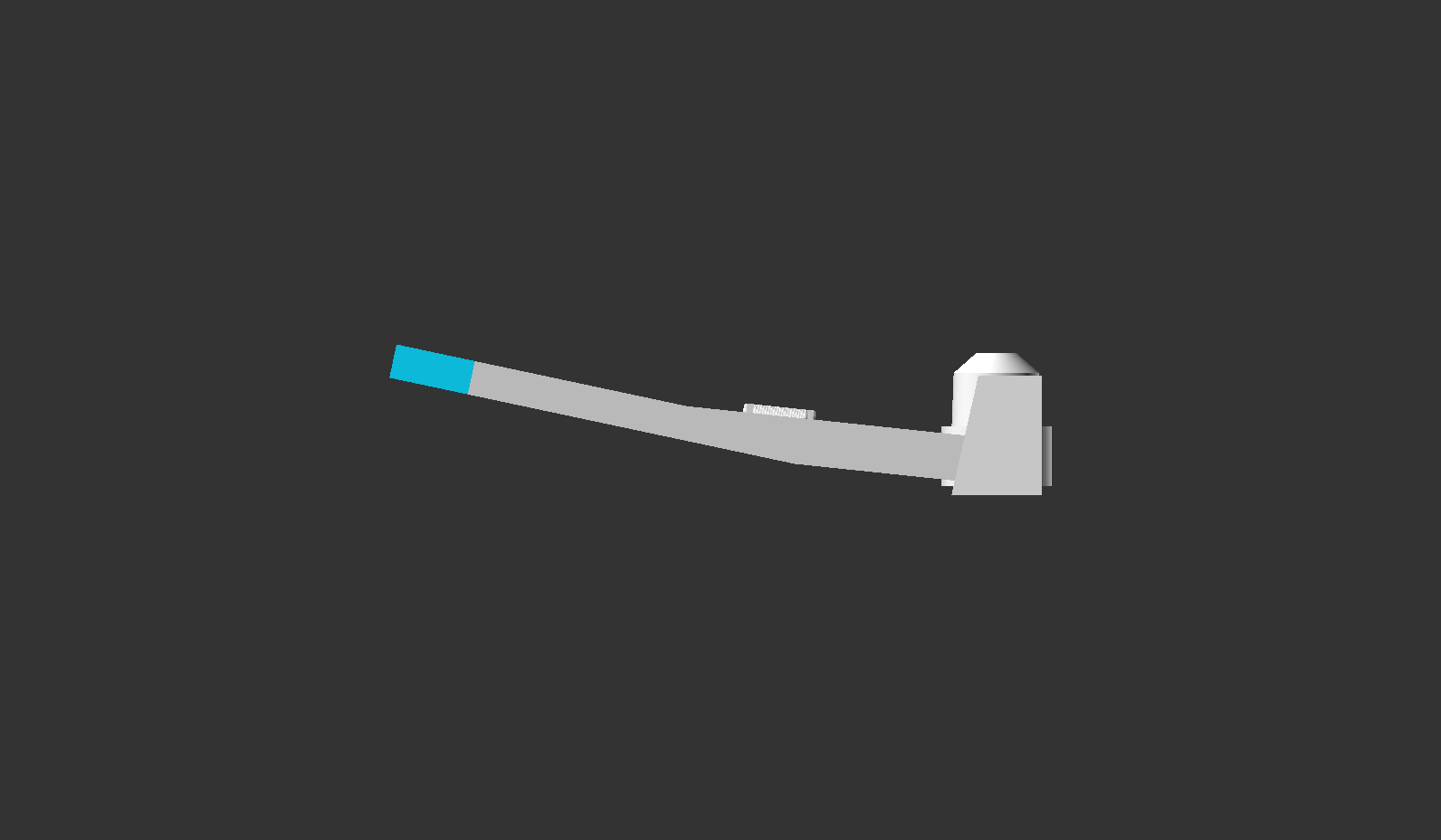

Now that we have the PCB, does it make sense to do a real investment (time not money) towards a replacement backplate, metal top plate, barrels, foam, and spring/flippers? We are going to want the flippers anyway since it is the point of this whole projects in its current form. I have the flipper designed, and ready to be prototype printed. The top and back plates are really basic to CAD design, and the foam is almost identical to the top plate.
I would vote for something that screws together versus the tab and slide approach... It's a pain to assemble in my mind, and less secure than screws with spacers spread in strategic spots. You would need significantly less points of contact between the plates than the current bolt mod since the metal top plate (spacer spot welded onto) is significantly more rigid than the janky plastic barrel frame.
The barrels themselves would be easier to design than the flippers (or as easy), and could be molded at the same time the flippers are.
With that, you would have a full F replacement drop into an SSK case (worry about that replacement later). It is tempting, but significantly more expensive than what we have considered so far, but FAR less than the F62/77 project (this would truly be non-profit).
Welcome thoughts... This would need significant interest as part of a group but too even be viable though

I like the idea of an full metal case. also voting for screw it
(the second option is basically a normal SSK case out of metal, or?)

Let's face it, we are about to copy Ellipse and make our own brand new SSK's with model F characteristics such as all metal case and square badge.

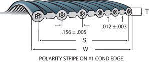

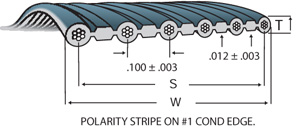

What will give the mini controller for advantage ?
I realy do not like the current trend to push on people like hey we need the mini controller fast help help help.
I mean do the "normal controller" not work great enough ?
As for Ribbon cable, we have people who have access to recycling center, have them take 50 ribbon cable from there and send it to the person in charge ?
Does that not work ?
Have a nice day
Alkhar
Have a nice day
Alkhar
- lot_lizard
- Location: Minnesota
- Main keyboard: Indy SSK Model MF
- Main mouse: Logitech Anywhere MX
- Favorite switch: Beamspring
I have zero issues with current controller (actually prefer something proven). I had just finally looked up the cost of the 3.96 pitch cable... It is not easy to find, and the cost was NUTS for a 100 foot spool. Plus I never found in anything bigger than a 24 core, and we need 30 if we are trying to look nice. That was the only real reason. If you have access to used, I would love 2 right now for the current PCB that i$ is sending out.
@Phenix... The current model F uses a metal top plate and bottom plate that sandwich the barrels, foam, and PCB (ours would as well), but the two plates are attached by compressing the foam and sliding several tabs laterally to lock in place. Then one of those metal tabs is bent over to hold the lock in place. It's a mess. Screws would be the new "dreamed up" approach. I would wait on the metal replacement outer case until this inner part had been worked out

Ok, yeah me too, i prefer something proven.
For the ribbon cabble, do you not have a computer shop near you ? Or jyst friends who have computer laying around ? Pretty simple to source them for cheap.

Here are the differences. .156 (3.96mm) pitch (spacing) is what we would currently need. It is very rare and expensive because of its lack in modern times. The original IBM 4704 keyboards (think Kishsaver and the like) used this, so the xWhatsit controller was designed so it could replace the existing controller. .05 and .1 pitch would be common today. Hopefully this helps

I need a battery on my micrometer to finish the barrel (I cheat and use a digital one), but thought I would post the flipper. The barrel should be ready to print as well in a couple of days, and I will send both off to test the results. Again, eventually these become castable wax for some mold

I am impressed.
If we would know a company doing injection modding I am sure that they could produce them.
Regarding the material it shall be conductive. Ellipse wrote:
group-buys-f50/brand-new-f62-kishsaver- ... al#p240564
We could ask him ...Also I got some advice from one potential supplier regarding the recommended plastic. ABS PA-757 is both smooth and strong according to this web site: http://www.chimeicorp.com/en-us/products/plastics/abs/
They recommend 18% carbon infused Torayca ASHT-18A plastic for the flippers instead of electroplating (electroplating appears to be much more expensive).
Barrel
Material: ABS POLYLAC PA-757
Flipper
Material: Torayca ASHT-18A

Thanks... It might take a couple of attempts to get the weight, angle, and feel identical, but we are within .1 mm now I believe
The barrel is pretty hard to screw up
... the flipper, not so much. After the barrel is the top plate, foam, and back plate. Getting there
Conductive plastics are a dark art to me. I think I would like to find some company that is domestic (for either me or you) for the molding vs China in bulk. This is super critical to get right, and turnarounds from China take too long if we have to experiment with different plastics for conduction/weight/sound/etc variances. My two cents... especially since this will be the cheapest part to produce in terms of material needed per part

I think the flippers are either made of graphite or plastic coated with graphite for conductivity.
