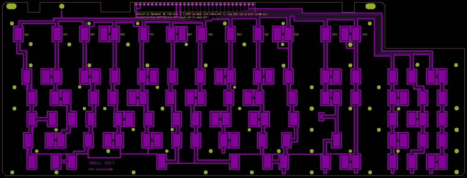

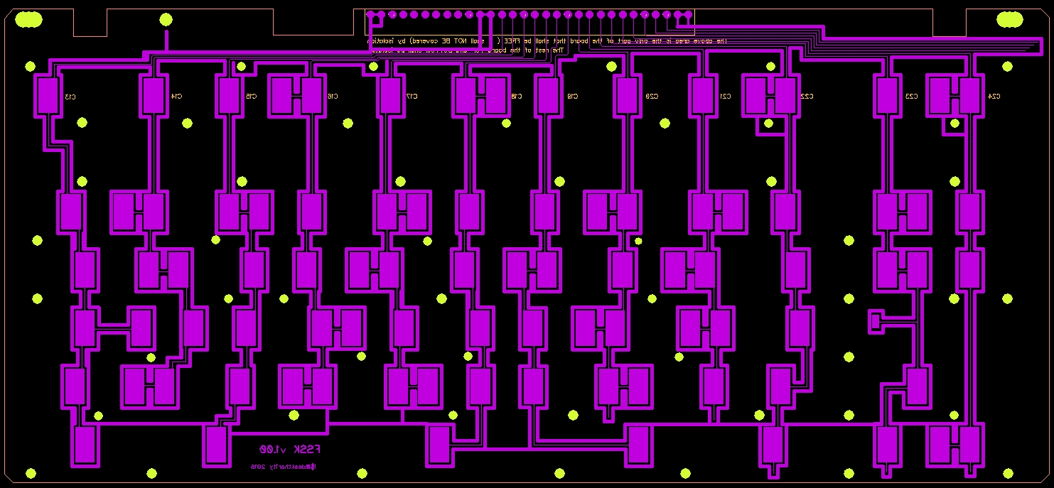

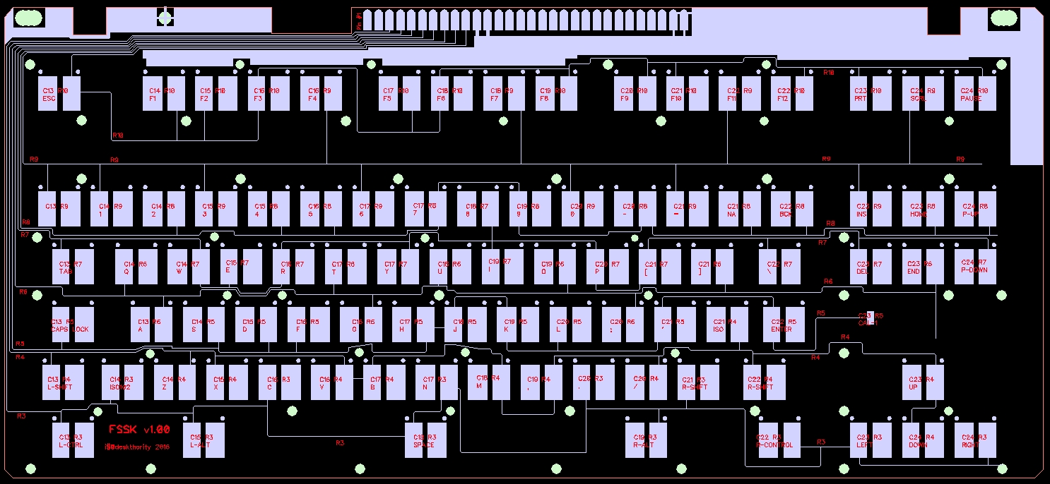

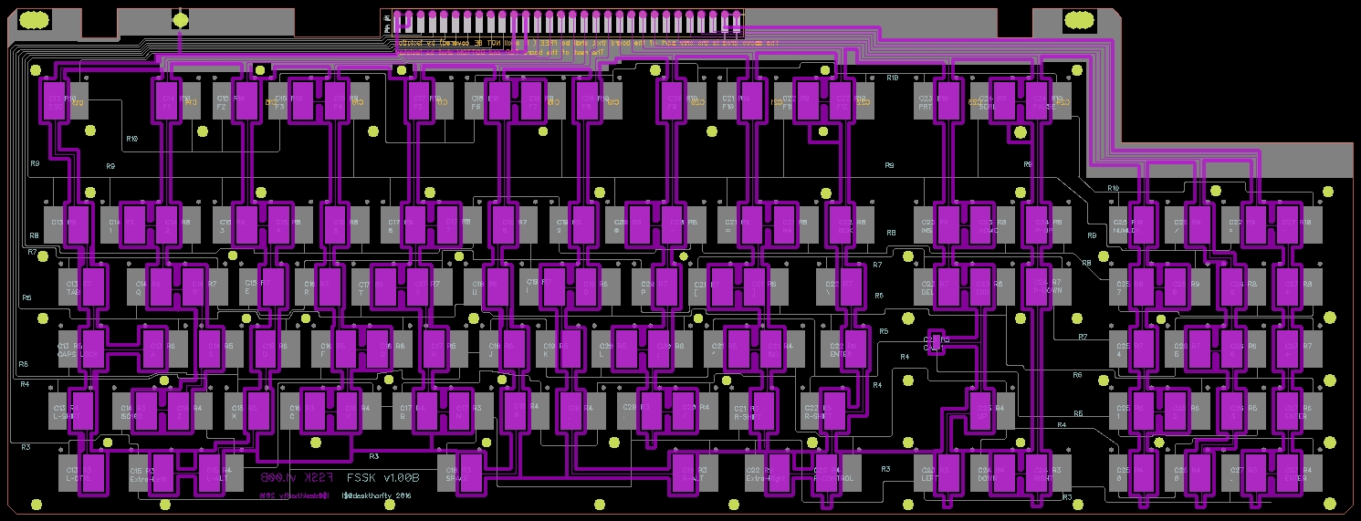

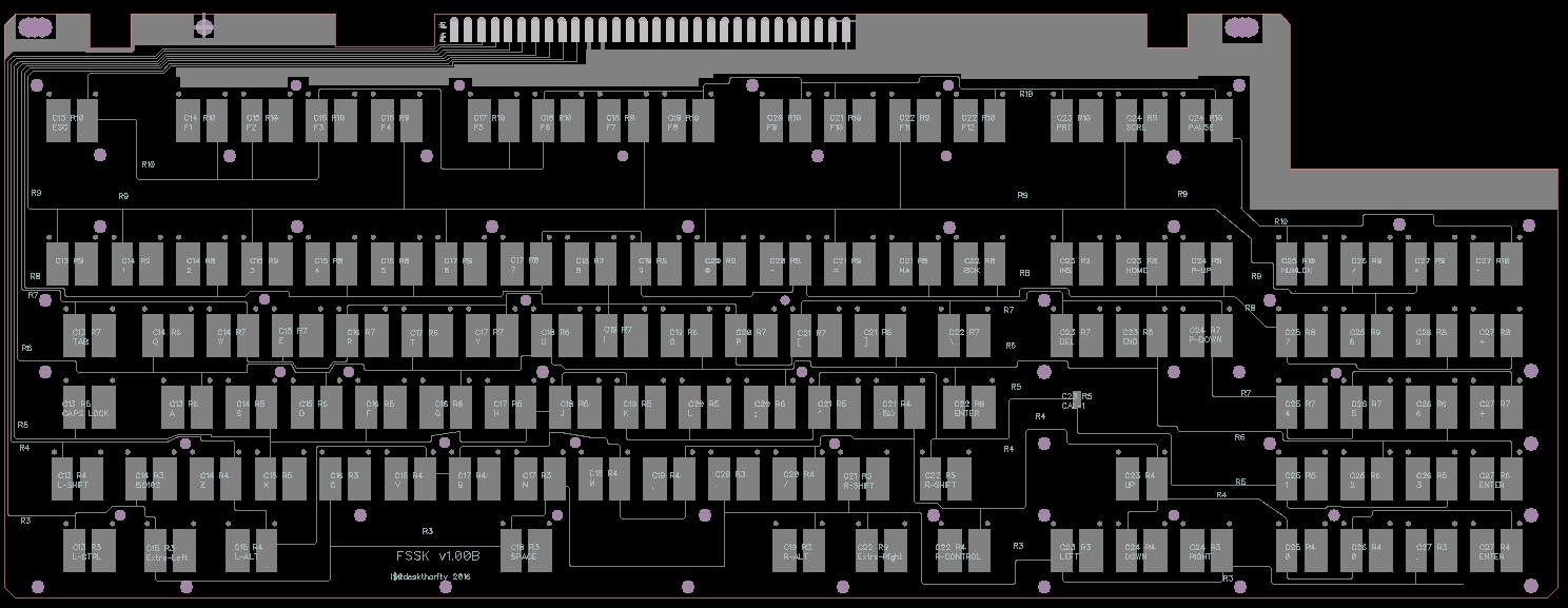

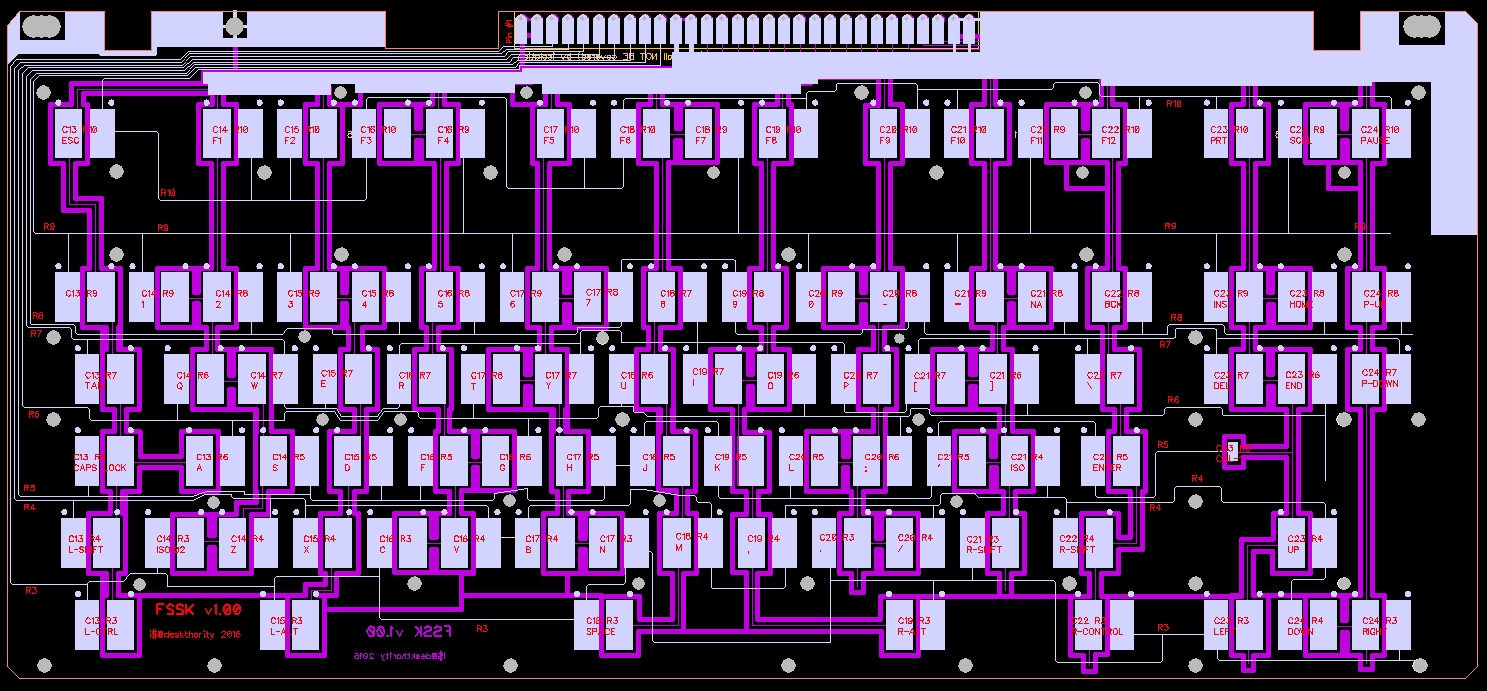

by idollar
All,
I am ready with the updated version of the FSSK. It is called V1.00
Notes on this version
  • It is the same version as the prototype one with corrected errors.
  • It does not have the extra keys that XMIT suggested. This change required a redesign of two rows which add risk that I will not take in the production unit.
The pictures from the Gerber follow:
FSSK V1.00 - Top layer from Gerber.jpg (523.98 KiB) Viewed 23026 times
FSSK V1.00 - Bottom layer from Gerber.jpg (422.16 KiB) Viewed 23026 times
FSSK V1.00 - All layers from Gerber.jpg (693.06 KiB) Viewed 23026 times
Posted: 01 Apr 2016, 20:38
by idollar
All,
FSSK v1.0 - Top layer from Gerber.jpg (363.74 KiB) Viewed 23022 times
FSSK v1.0 - Bottom layer from Gerber.jpg (356.58 KiB) Viewed 23022 times

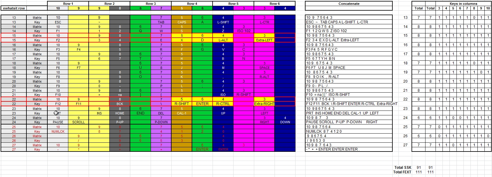

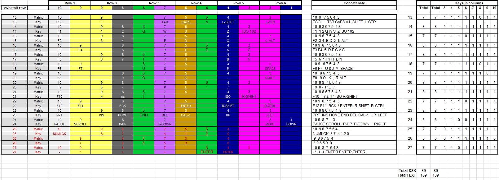

For those interested in the differences between the new Version V1.00B and the V1.00, following you can find the tables that I have used to check the design:
FSSK V1.00
FSSK v1.00 - Matrix table.jpg (643.52 KiB) Viewed 22935 times
FSSK (=FEXT) V1.00B
FEXT v1.00B - Matrix table.jpg (641.42 KiB) Viewed 22935 times
The keys that have been changed are marked in a different color.

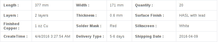

Hello,
Ther version 1.0 of the PCBs (with and without B) will be RED.
The order has been submitted for review to pcbway.
