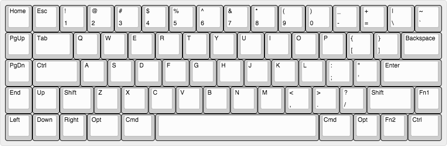

Muirium wrote: How about breaking the mold and adding the extra keys to the *left* of a the 60% block instead? Sixties are already right-hand heavy. Why add to that lopsidedness? Why follow!
Great Idea. I don't mind a cluster on the left, even if it's a little bigger. But I want mah arrows on the right >: (
Khers
25 Feb 2016, 13:03
Muirium wrote: Spoiled!
2539C64A52DF22F3039DC9
See how the J key almost lines up with the middle of the keyboard? Argh! Assymmetry!! Home position is way off to the left, and so will be a TrackPoint.

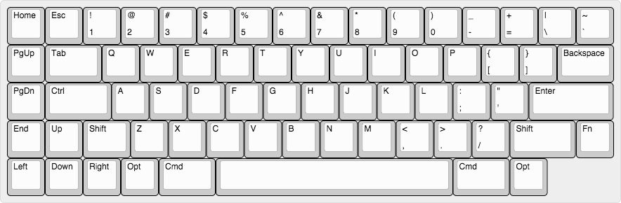

Interesting idea Mu. I did a quick and dirty test in keyboard layout editor and came up with this. I ran out of ideas towards the right of the bottom row, but maybe something like this:
It might be a problem for some that the left edge of space is pushed further to the right. I don't know if that causes any issues with split spaces and whatnot.
25 Feb 2016, 13:18
Inverse ISO left Shift: I like it!
Think 1.25u on the bottom row too, and you're on to something. Plus an extra mod on the right. Because left arrows = right side mods when using them.

25 Feb 2016, 13:29
With a 6u (or 3+3u) spacebar and some 1.25u mods, I could add two extra mods:
keyboard-layout (2).png (35.55 KiB) Viewed 6951 times
6u spacebars are not that common though. And neither it 3u... Remove .25 on one of the mods to fit a 6.25u spacebar and it starts to look like too many keys of similar size on the bottom row imo...
25 Feb 2016, 13:54
Yeah. As I always say: everything between 60% and TKL is a compromise. I'm happy with 60%, of course, so perhaps I'm not the ideal person to lead design on a 65%. With an HHKB style Fn layer, I wouldn't need the arrow keys. I'd just use it as a 60%. I even do that on my TKLs when the Fn key is easy to reach.

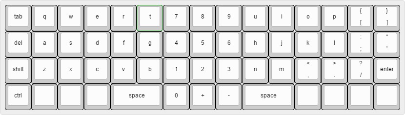

I am just throwing a crazy idea out there although Ill back this what every layout and I love the HHKB with the 2.5 space.
keyboard-layout (5).jpg (50.46 KiB) Viewed 6757 times
vivalarevolución
formerly prdlm2009
28 Feb 2016, 15:29
mastermachetier wrote: I am just throwing a crazy idea out there although Ill back this what every layout and I love the HHKB with the 2.5 space.
I recommend throwing this idea out to Ortholinear Keyboards, if anywhere.
mastermachetier
28 Feb 2016, 18:14
Not a bad Idea, it needs some work for sure before its ready as well.

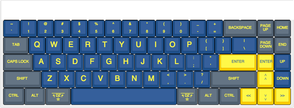

* 65% layout..
heck why not add that 1% or just a little more 5% hahaha... :lol:
* the Case
Just what you need..Perfect would be enough room to house a couple extra LED’s
on the right side.. Or place does LED’s under a key that you can see on your right side..
No idea how one would accomplish that hahahah...
Don’t u just hate putting on a third party key-cap set and not seeing your caps-lock light anymore? well i do ..Filco really has that one licked..
For me this is the dream layout..All the keys i need..small and no hassle with different key-cap size..
70% dream layout
