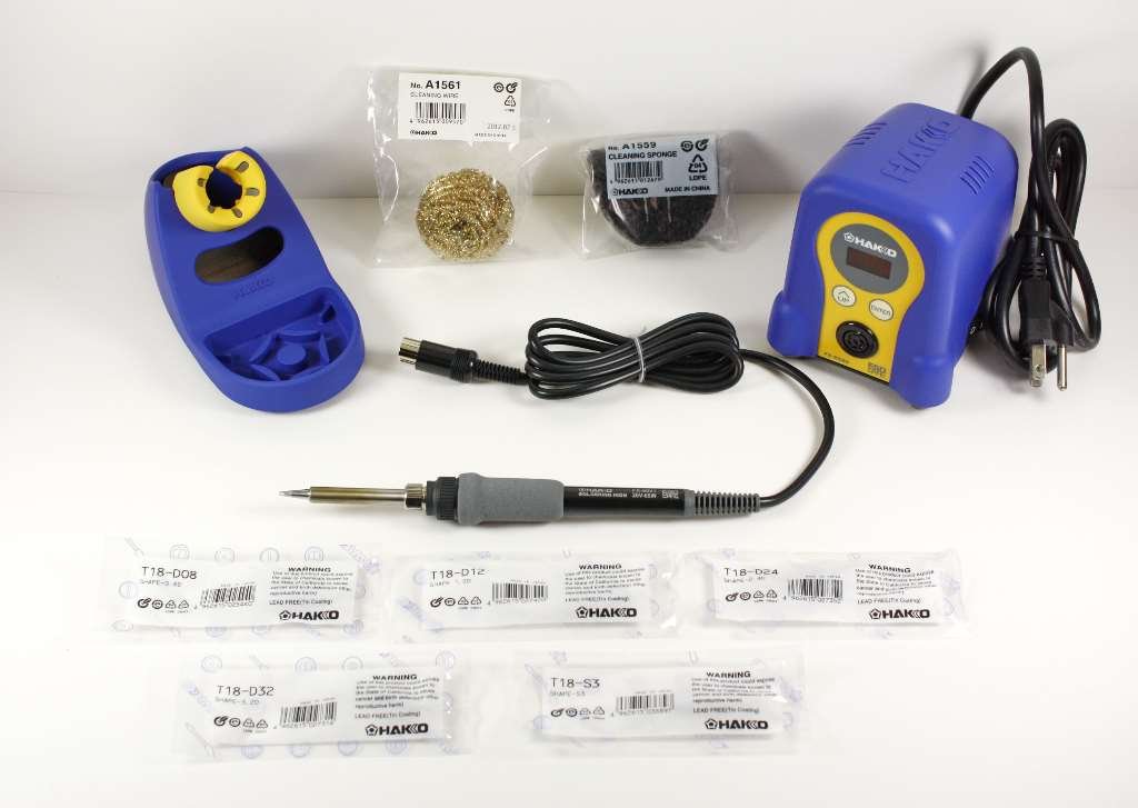

How about some real Hakko?
http://www.hakko.com/english/products/hakko_fx888d.html
http://www.amazon.com/Hakko-T18-D08-D12 ... ords=hakko
$100-200 for a core tool isn't too bad, he reckons. What'dya think?

Nice! But if this is the 110V version, is it not a hassle to get it to work here in Europe ?
I remember that an Italian webstore was selling the genuine 220V version for slightly less than 100€ a few weeks ago, but I can't find the link again.
edit: got it http://www.batterfly.com/shop/hakko_fx-888d
