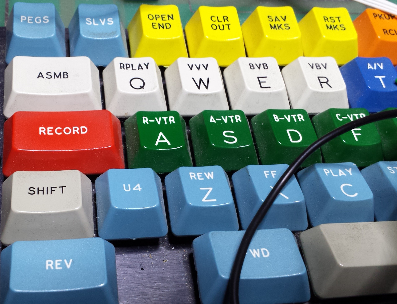

Finally opened 'er up. Not a standard keyboard controller, but rather a microprocessor with a custom ROM. Perhaps it won't be as easy as I'd hoped to interface, not sure yet.

by andrewjoy
Is it just me or does that MX black look a bit ..... long ?
Posted: 12 Nov 2015, 17:58
by klikkyklik
I'd be happy to throw some calipers on it for you.
Posted: 12 Nov 2015, 18:03
by andrewjoy
Dont trouble yourself , i am sure you have seen blacks before and i will take your word for it , but the slider just looks taller.
Posted: 12 Nov 2015, 18:13
by klikkyklik
The slider extends about 4mm from the top of the keyswitch shell.

On one hand, it was the n00b in me that suggested the caps-locking mechanism was handled keyboard-side, and that's why I was observing a capital A instead of a lower-case A. My mistake- this is my first attempt at "talking" to any keyboard. In my defense, this thing is such a custom job that ... I suppose it could happen. :roll:
So yes, the CPU is scanning the matrix and outputting bytes serially. Knowing this, on the letter portion, it outputs what you would expect: A key = 65 ($41), B key = 66 ($42). For grins I mapped out some of the other keys, just to see what it would generate.
ASMB (where a TAB key normally sits) = decimal 39 (hex $27)
RECORD (where CAPS LOCK usually is) = 40 ($28)
Left SHIFT = 41 ($29)
U4 = 42 ($2A)
REV (left CTRL position) = 43 ($2B)
FWD (left ALT position) = 93 ($5D)
PEGS (tilde position) = 245 ($F5)
SLVS (1 key position) = 246 ($F6)
OPEN END (2 key position) = 115 ($73)
CLR OUT (3 key position) = 116 ($74)
SAV MKS (4 key position) = 118 ($76)
RETURN key = 13 ($0D) (ASCII carriage return – nice)
ENTER key (far right on numeric keypad) = 10 ($0A) (ASCII newline)
SPACE = 144 ($90) (not a decimal 32 for an ASCII space? Hmm)
Anyway, this has been a fun experiment and all, and I purchased the board because I couldn't pass up the thing for the price. I originally thought that perhaps standard keyboard signals were being routed to the connectors in back, it might be fun to use on occasion - and it certainly is a conversation piece. Now that I know how it works, it would indeed be possible for me to interface it, but the "problem" I'm having now is whether to spend the time on it. I don't like Cherry MX blacks and I don't care for the layout, so I'm just going to sit back and see if something gels.
