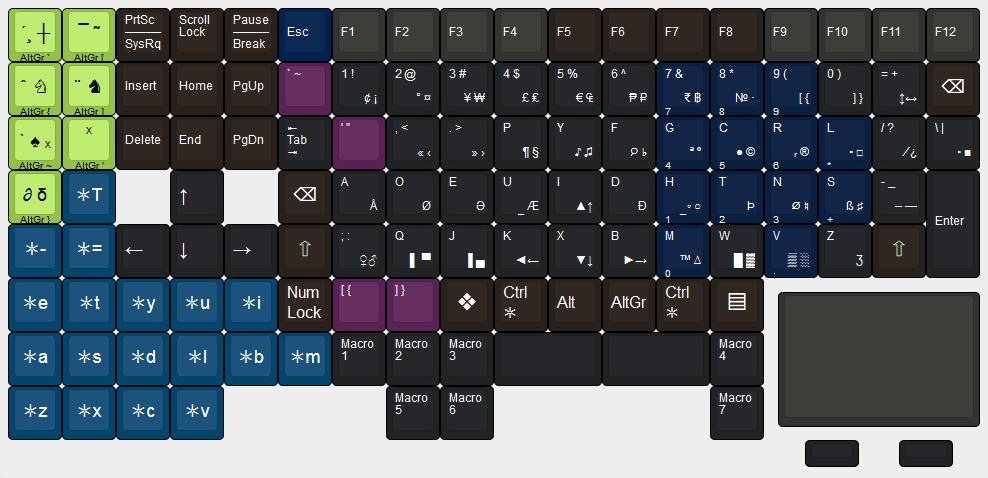

1. Clarinettists have to "train" their pinkies a lot due to the nature of the instrument. There are at least four keys under the command of each one, and often five or six. It helps that most of these are deliberately duplicated in both so that they can alternate duty, but the fact remains that repetitive stress is more of a problem on clarinet than it is on, say, flute or saxophone, because so much of the work is being done by weaker fingers. You can (and will) develop the speed, but that doesn't change the fact that the tendons really weren't meant to do that so much. Violinists (and to a lesser extent, violists and cellists) also have this problem because the pinky is the finger with the greatest reach up the fingerboard, especially once you get past the point where the thumb can sit on the back of the neck.
2. A 1U backspace is easy enough to hit if and only if there is space to the right of it. If there is a keypad immediately adjacent to it, it makes it much harder to get used to. My backspace is 1U, but it's on the far right of the entire keyboard. Over-reaching means an airball. When I had the number pad there, I had to assign that position to Num Lock and put a rubber band under the key to make it hard to press because I was hitting it constantly.
3. It's not the length of left Shift that concerns me. Make it 1U for all I care (both of my Shifts are 1U, I have a matrix keyboard). Just don't move it further out to the side, increasing how wide I have to spread my fingers to use it. If you want to add a key there, add it on the outside. I've seen a few keyboards that did this, and they weren't kezboards. Similarly, if you want to cut 1U off the outside of Right Shift and put a key there, go right ahead. It won't affect my use of Shift one bit. In fact it would make it more stable by virtue of being smaller.
I'm to the point where I kicked [ and ] out of the main alpha area to pull the right side in one column closer (another reason the small Backspace is less of a problem, it's closer), which also necessitated moving =+ back to its QWERTY position in the number row rather than row 2. They're still accessible (in the modifier row), but also AltGr'd onto 9 and 0. Sometimes one is more convenient, sometimes the other. Both are admittedly a bit slower than usual, but the only time I use them is typing pseudo-HTML on forums.
pietergen wrote: 4. Typing shortcuts combos with one hand puts strain on the muscles, may induce RSI. ctrl-z; ctrl-v and so on are better typed 2-handed. Having 'nice rolls' usually means also having more 'akward clusters'
Typing them one-handed is still better, provided they're mapped to dedicated keys which don't require the use of a modifier. That's the best of both worlds.
I am reminded of a lesson I received as a bad golfer. If you want to shave strokes off your score RIGHT NOW, don't go to the driving range, go to the putting green. Optimize what you do the most, first, until there's nothing left worth squeezing out of it. Then move to what you do next-most. That's not to say you shouldn't work on driving, or that it's not fun to whack a bucket of balls to blow off stress, but it's not going to show up on the scorecard nearly as quickly.

What you did with the [ ] keys is not too far off what I did with them. However, I have reason to believe the placement of the Ctrl keys would not work out well at all. I find that any key below my spacebar gets inadvertently pressed at least some of the time, because the thumbs come down rather parallel to the plane of the keyboard rather than poking into it like the rest of the fingers. What could work is to put the spacebar below the modifier row. Also, instead of two adjacent Ctrl keys, why not just one big one?
I understand that you made Space and Backspace the same size so they could be interchanged, but personally I need to press Space with both thumbs: with the right when typing (unless my right hand is out of position), and with the left when gaming. I left Shift in Row 4, but made it equidistant in both hands: one out and one down.
I leave the lenses off the spacebars (they're really the + and numpad Enter keys, rotated 90 degrees) so they sit a few millimeters lower than the modifier row, which means I can thumb any of the center four buttons without being so likely to press a spacebar. The other vacancies are deliberately chosen to avoid accidental keypresses by the heels of my hands, or in the case of the arrow keys, to make it easy to locate without looking. I leave Alt/AltGr closer to center so that either hand can use either one. This neatly dodges one problem of sacrificing Right Alt for AltGr, having to make awkward hand stretches, and does likewise for AltGr, which can otherwise only be done with Left Ctrl and Left Alt at the same time (which can and sometimes does induce ghosting due to a lack of rollover, especially when you need Shift on top of that).
The cursor pad could be off to the right without significantly affecting the core concept, but I wanted to get my normal right hand position as close to the mouse as possible. It also turns out that being able to use the mouse and the cursor keys at the same time is rather nice. I can also hold Shift with my left thumb and highlight selections with the cursor keys, but this would be equally possible to do with the right thumb if the pad was on the other side.
This is not a paper layout or speculation, either. I'm typing on it right now, and have had it set up this way for a few days now. I had a few hiccups at first, mostly pertaining to reaching right for the cursor keys, but I've really gotten to like having them on the left. They're not just taken out of the space between right hand and mouse, they're actually more useful over there.

Mal-2 wrote: This is not a paper layout or speculation, either. I'm typing on it right now, and have had it set up this way for a few days now. I had a few hiccups at first, mostly pertaining to reaching right for the cursor keys, but I've really gotten to like having them on the left. They're not just taken out of the space between right hand and mouse, they're actually more useful over there.
Your keyboard has like twice as many keys as I ever expect to need. :-) I don’t think I could handle the confusion, and I dislike straight matrix boards, but I’m glad it’s working for you.

That I can understand. I still find it quite comfortable to drop the spacebar(s) one row and pull the mods into the middle.
Your keyboard has like twice as many keys as I even expect to need. :-)
Yet it's the width of a normal TKL. It's deeper, but that has zero impact on where the mouse ends up.
You admittedly don't need the green, blue, or Macro keys to make a basic layout, but I have that space and I see no reason not to use it. The green keys are particularly specific to my needs, but they could be used as still more Ctrl+something keys or longer macros.
jacobolus wrote: I don’t think I could handle the clutter/confusion, and I personally despise straight matrix boards, but I’m glad it’s working for you.
It doesn't have to be a matrix, though that certainly makes the concept easier to implement without having to roll your own from scratch.
As for clutter, all you need are the red and yellow boxes, and the cursor section would probably be on the other side for most people.

For me, the ideal keyboard needs about 60 keys (I could get by with <50 probably). That’s all that can be comfortably reached without moving the hands. The overall physical dimensions (assuming I’m using this on a desk and not carrying it around in my bag) doesn’t really matter too much.
Your keyboard has 120 keys, or 90 in the red + yellow boxes. That’s way too many for me. :-)
More importantly, any key which requires hand motion IMO must be easy to feel out, without needing to look at it. Big undifferentiated grids of keys are in my opinion the absolute worst, especially when the keycaps are all uniform and reasonably flat. Instead, functional groups should be limited to about 4–6 keys each, and separated by lots of space.
If for whatever reason you absolutely need a gajillion extra keys, they should be something like:
(Note: I’m not trying to be too negative or make this discussion personal; as always, people should use whatever suits their preferences. I’m just explaining what my own biases & preferences are. Hope I don’t give any offense.)
Posted: 30 Apr 2015, 03:40
by Mal-2
jacobolus wrote: Big undifferentiated grids of keys are in my opinion the absolute worst, especially when the keycaps are all uniform and reasonably flat.
I agree with you. This keyboard came with nothing but flat-topped relegendable keys. Touch-typing was utterly impossible. It was like trying to touch type on a laser-projected keyboard. It was a uniform wall of keys, I could barely even discern the spaces between them. That's why I had to steal the "real" keys from the other G86 keyboard I have. This makes all the difference in the world. It took what felt like a cash register and made it feel like something designed for typing.
That's also why I have bumps on U and H, the empty spaces in the cursor pad, Escape standing 3 mm higher than everything else, lenses on just four of the Function keys (so I can feel the groupings without having gutters), and a piece of cardstock in the crack between the cursor pad and the alpha area (so I feel it instantly if I wander too far over). The separator card was a lot easier to see when it was a piece of a credit card and wasn't black, but that first attempt was too thick and caused the adjacent keys to make scratchy noises. The current separator is a bit too thin and has a tendency to rise up out of the crack. I still have yet to find the ideal separator, but it's the best I can do without having a gutter. A gutter would be preferable (like .25U) but since I didn't build the keyboard from the ground up, there's not much I can do about that unless I want to leave an entire blank column. (I tried that, the card works just as well and saves reaching.)
My "non-optional" keys number 90 versus your 82. I don't see that as dramatically different. Three of them are PrtSc/ScrollLock/Pause which you have omitted. One more is a duplicate Backspace. That means I'm really only incorporating four more core keys than you are. One of them is due to splitting the spacebar, which I do mostly because I don't have any 4U keys. That reduces the number to three.
I've tried to make the point that despite ending up in considerably different places, we started out with many of the same intentions. Different opinions on how thumb keys feel and should be used led us to invert them relative to one another. You don't like a matrix. I thought I wouldn't either, but found it to be completely natural once I centered it properly. The alpha area of a normal keyboard, even a TKL, is pushed out to the left. This makes the stagger help to compensate for the fact that all reaching is itself slightly slanted, so it feels somewhat natural. Once I squared up the alpha section dead in front of me, the lack of a stagger felt natural in a matter of hours. In both cases, I raise my elbows to reach up the keyboard, and lower them to drop down.
I've toyed with the Function keys being on the left, AT-style (except twelve rather than ten). I've played with them being in a 3x4 group, a 4x3 group, and a 2x6 group as you have them. Frankly, they're all acceptable. The reason I have them where they are is simply that I have twelve spaces there that I'm not otherwise using, and nothing else fits neatly into those twelve spaces. If I needed to drop a row off the top, moving those to the left would be a quick and easy way to do it, but I don't need to.
