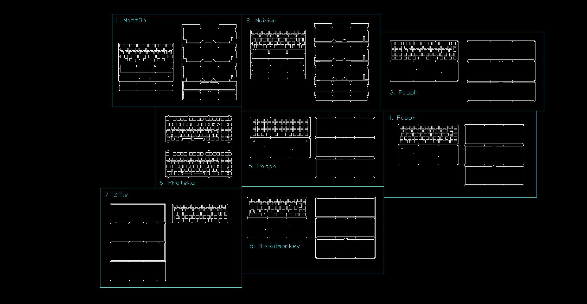

I finally figured out how to get dimensions out of .dwg files in DraftSight! (Yes, I'm slow.)
So the angle of my stepped case is determined by the triangle ABC:
<---------------------------- Overall Depth (d) ----------------------------->
|                                                      Upper deck height (u) |
|                                    A---------------------------------------B
|                                    | Lower deck height (l)
+------------------------------------C
<------- Mezzanine Depth (m) -------->
d = 101
m = 50.5 <-- Currently the mezzanine is 50:50, at 101/2
u = 12 (3 layers of 3 mm plus 2 layers of 1.5)
l = 7.5 (2 layers of 3 mm plus 1 layer of 1.5)
The angle I'm interested in is ABC
tan ABC = AC / AB = l / d-m = 7.5 / 50.5 = 0.148514851485
ABC = 8.5 degrees
Just got out a protractor and measured a couple keyboards. (An Apple Aluminium and a Model M.) They both look about 7 degrees, or a sliver under, in their incline, measured at the side of the case. I use all my keyboards sitting flat, without feet extended, so this angle is quite important to me. I'll do some more measuring…
I might push back that split in the mezzanine a bit. There's a lot of room in there!
-[°_°]-
01 Sep 2013, 15:59
consider that you can reduce the angle with the feet.
01 Sep 2013, 16:07
True. I just want it as low to the desk as it can get. 6-7 degrees looks like what I'm used to. I'll figure something out.
By the way, opposite the USB hole, there's a similar reduction in thickness in the bottom side layers' corner wall. As in: top left = USB hole. Top right = what? I don't get it. The switches should all be cosy upstairs.
Moving the step back:
10 mm = 7.1 degrees
15 mm = 6.5 degrees
That's the zone I'm interested in! So instead of the split at 50.5:50.5 mm, does 35.5:65.5 work?
Yes, I'm haggling over half a degree here!
-[°_°]-
01 Sep 2013, 16:14
Muirium wrote:As in: top left = USB hole. Top right = what?
for the sake of symmetry
01 Sep 2013, 16:19
Right. I do indeed like that. I'm not sure about strength, though.
-[°_°]-
01 Sep 2013, 16:32
Muirium wrote:Right. I do indeed like that. I'm not sure about strength, though.
once closed and screwed you can use it to cut diamonds. only issue might be during shipment, but my nuclear winter safe packaging is famous all over Europe.
01 Sep 2013, 17:02
All right, there's 25.55 mm of open space in the lower deck, so to speak. (At its narrowest point. It's 46.5 mm elsewhere) I'd like to push 10 mm into that, so the step is a shallower angle.
A new .dwg and .pdf of this (plus the feet holes) to review would be splendid!

you want to reduce the box to 36.5mm? you know that the 1.2a and 2a batteries are about 40mm?
01 Sep 2013, 17:23
Sneaky…
-[°_°]-
01 Sep 2013, 17:31
I just checked my 1a battery is actually 35mm, the power module 37mm. your call here. more room is always preferable but if you really need a smaller step I can reduce it.

I'm more talking about these https://www.sparkfun.com/products/8483 (the 2a actually is 54mm)

Anyway, point taken. That space is better off uncompromised. Thanks for thinking ahead.
-[°_°]-
01 Sep 2013, 19:31
I updated the DWG in the first post. This is the preview.

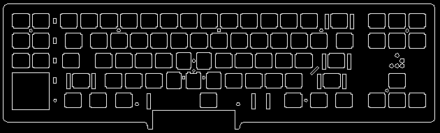

01 Sep 2013, 22:55
My final design is attached. :D Hope I'm not too late!
If you see any errors matt3o, please let me know.
For the 3mm layers, either aluminum or steel is fine, but I would prefer steel if it's significantly cheaper.

Here's an update without the risky IBM logo. Went with a version of the glider emblem instead:
