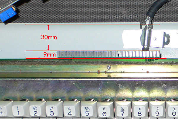

xwhatsit wrote:I think in total the board will be about 40mm max high, including the connector depth. If anybody has a Displaywriter and is able to tell me, please let me know. Otherwise I will modify it to use the 90° system.
Borderline. It's difficult to measure exactly, since the case tapers forward slightly. The measurements to the inside back here are a little conservative, and 40mm might actually fit, but a 90° mount is probably safer.
xwhatsit
15 Apr 2014, 02:36
Cheers kps!. I'll modify it then. Thanks very much :)

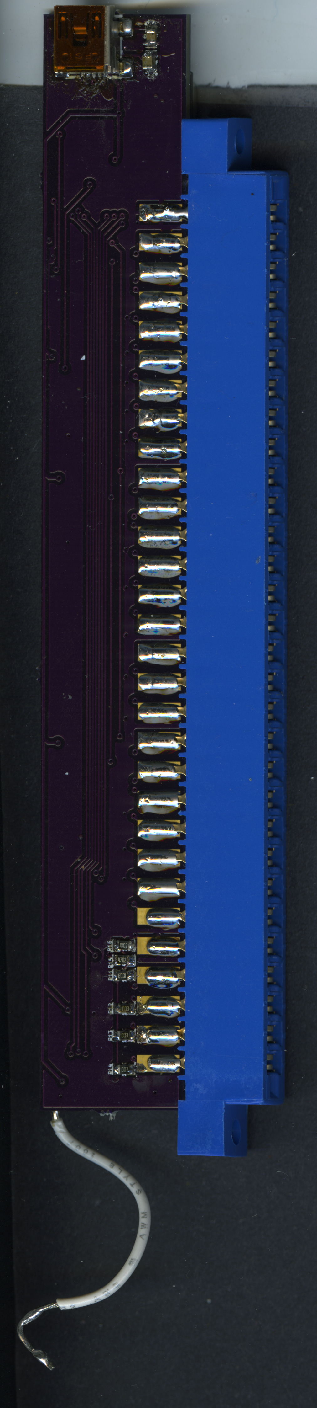

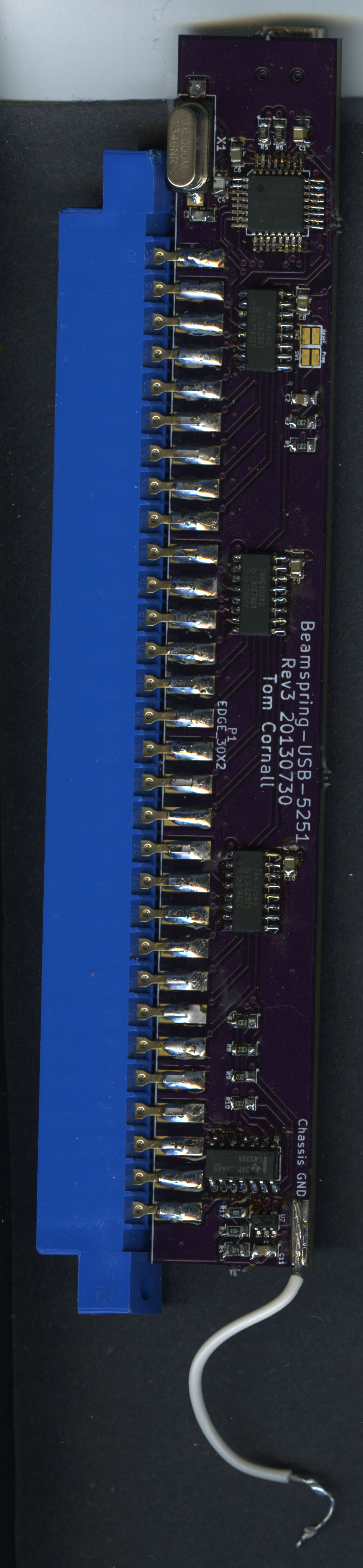

Here two picts of my board, I put it in the scanner at 600dpi:
tantalizingly close but not fully there yet !
nourathar
19 Apr 2014, 21:38
DUH !
in order to answer my own question:
No, it is not the right part, I've been using the DAC of a previous version, because I was confused at first when I ordered the parts. Now I hope I also ordered the right ones....
and it explains nicely why it doesn't work....
apologies for the confusion and the noise !

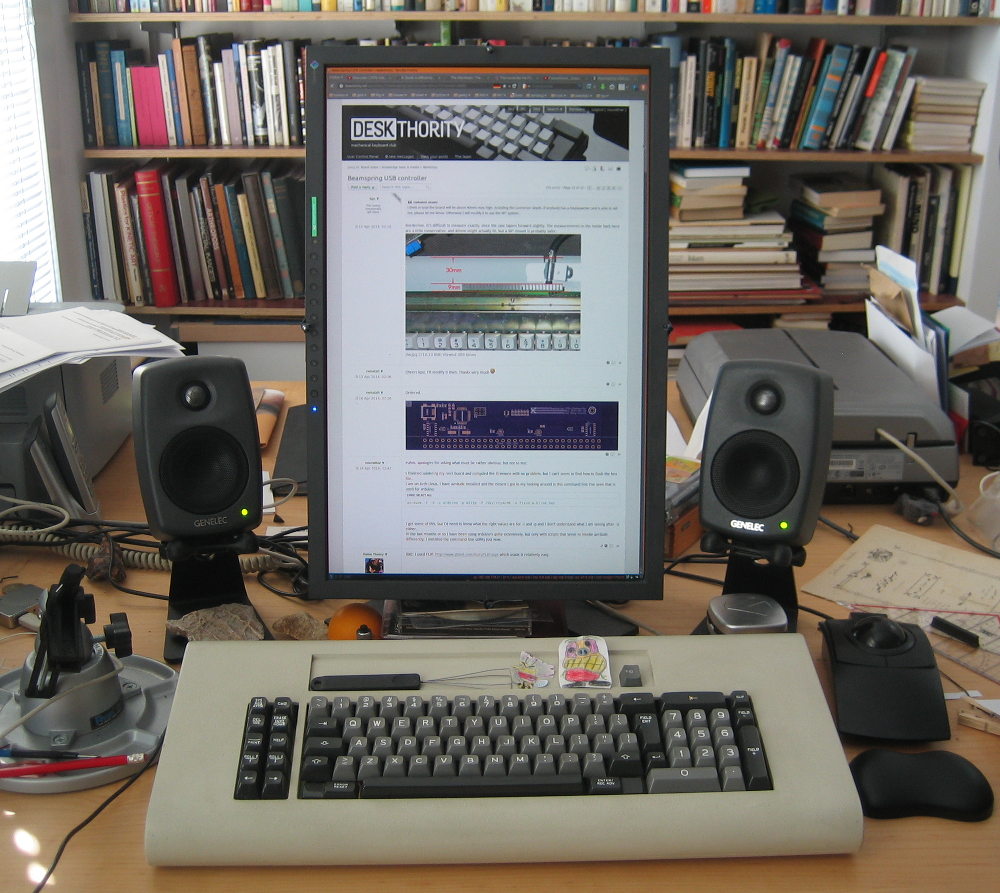

I see somebody else with VMS (vertical monitor syndrome). I'm 50% in remission for that (dual monitors, the other one is horizontal :) ). Jealous of the trackball. Suits the beamspring rather well I think.
