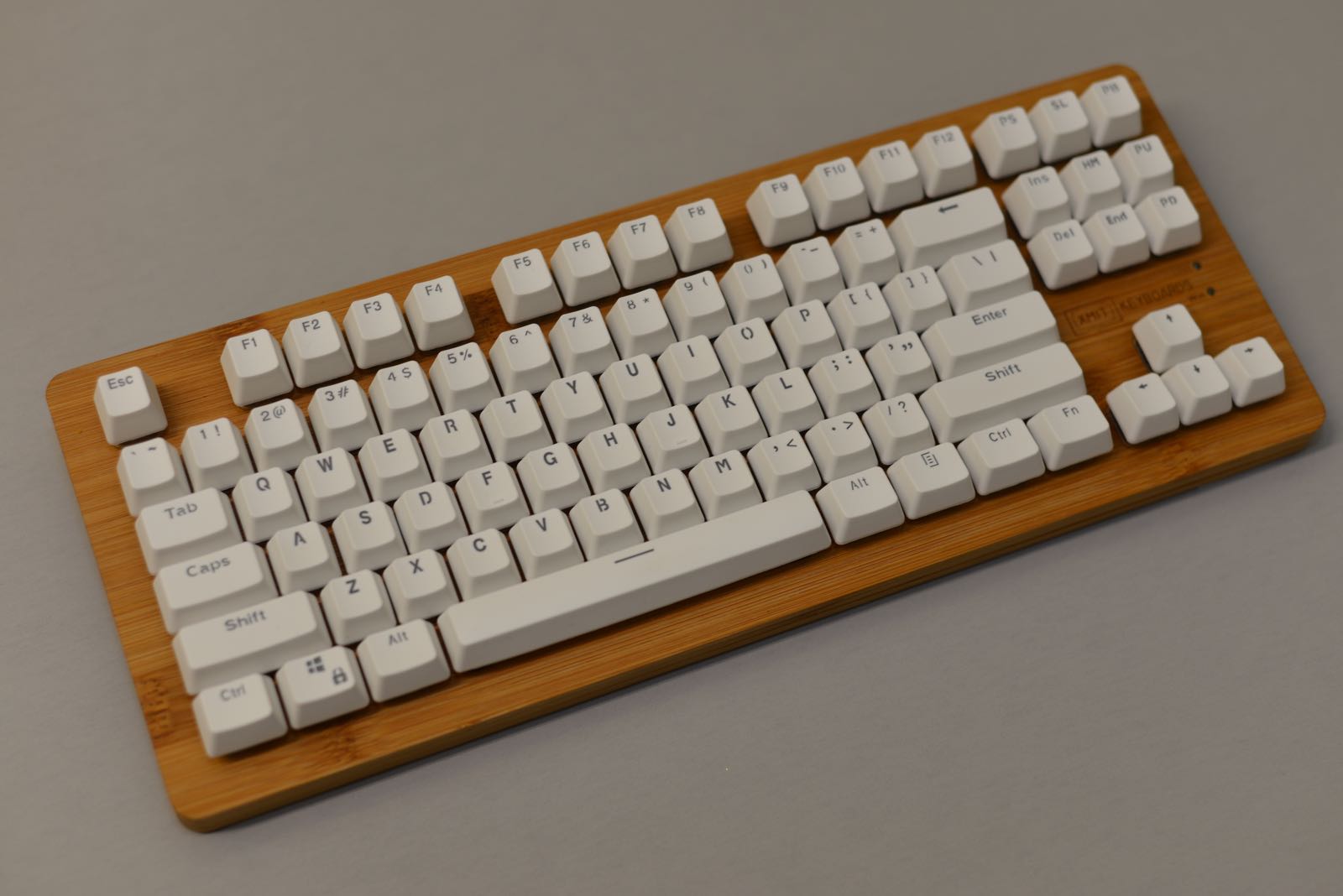

03 Nov 2016, 17:53
Here's a teaser shot of the production ready bamboo case with XMIT Keyboards logo and hidden screws! I'll take some more photos tonight.
Many iterations later, the final prototype.
03 Nov 2016, 18:02
Mate that looks amazing, i cannot wait to get one.....so i can put some decent caps on it :D.

looks neat. a bit too higher profile than i expected. any chance the bamboo case can be extended a little for a wristrest
anyone know keycap sets that go well with wooden case ?
[ XMIT ]
04 Nov 2016, 04:51
geostation wrote: [A]ny chance the bamboo case can be extended a little for a wristrest[?]
At this point the design is frozen as we move toward production, so, no, sorry.

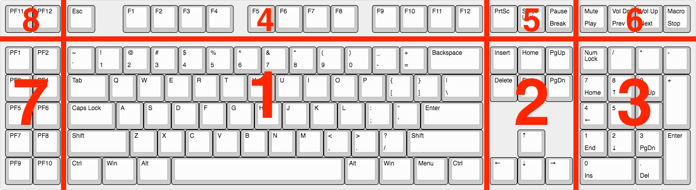

[ XMIT ]
04 Nov 2016, 19:30
So, here's my current thinking: a single PCB design that can be sliced along four different paths creating a whole bunch of configuration options.
The fleXMIT layout.
The fleXMIT layout.
You can imagine a whole bunch of possibilities here: Sun layout, NeXT layout, TKL without Fn row, etc. All with a single PCB design.
Ideally, if I had the time, I'd do something similar for Model F projects as well, but I don't see myself having hours to devote to PCB layout any time soon.
