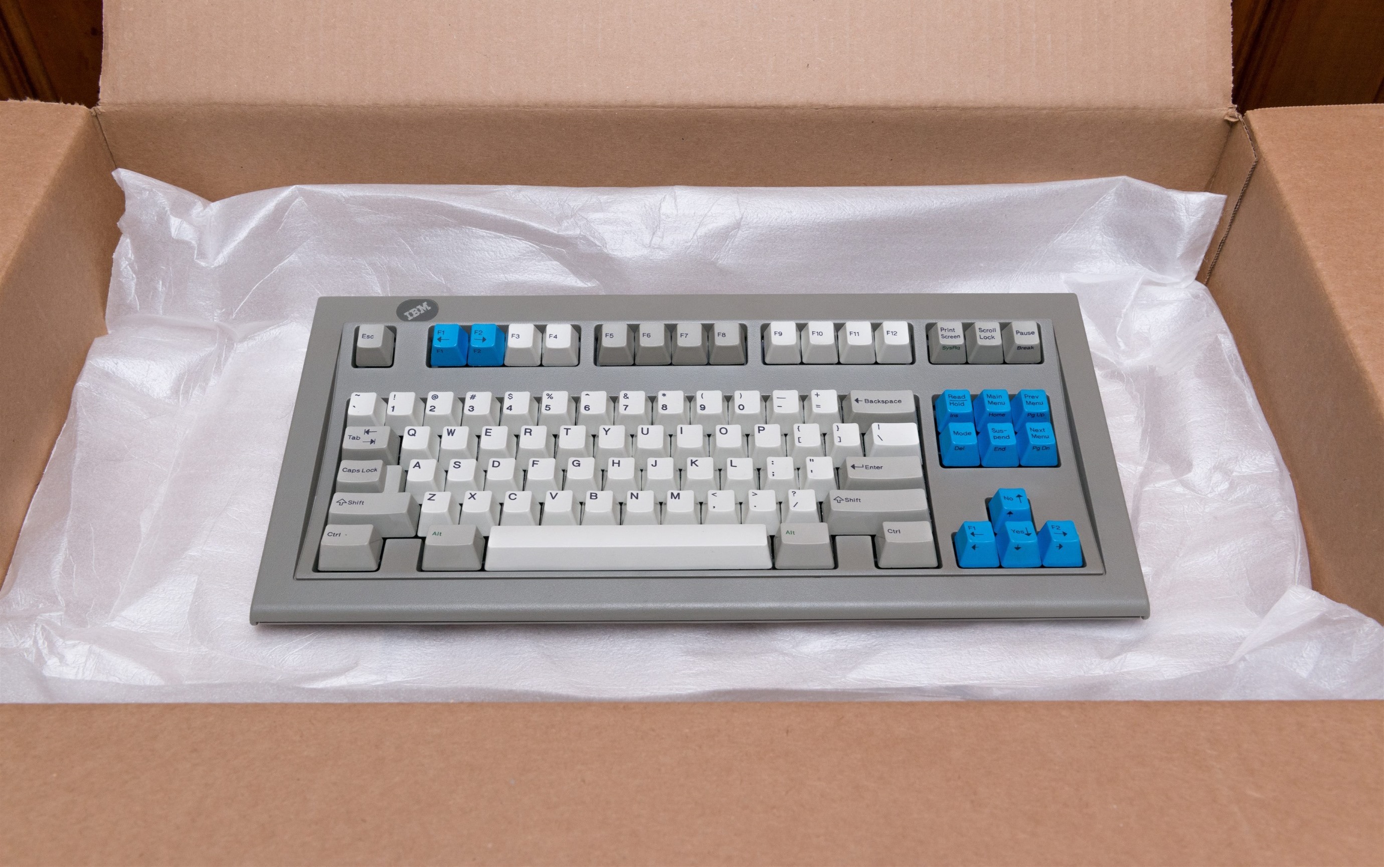

1. What are the dimensions of the cases for both F62 and F77?
2. Is the grey colour option meant to match the industrial SSK like this one? http://deskthority.net/f-o-r-s-a-l-e-f5 ... 10091.html
Case dimensions are around 16.5 x 7 in. for the F77 and 14 x 7 in. for the F62.
Yes the gray is intended to be approximately RAL 7030 which is similar to the bolt modded Industrial SSK I have for sale (this one is another ISSK of mine and is IMO a little more color accurate than the one in your link)

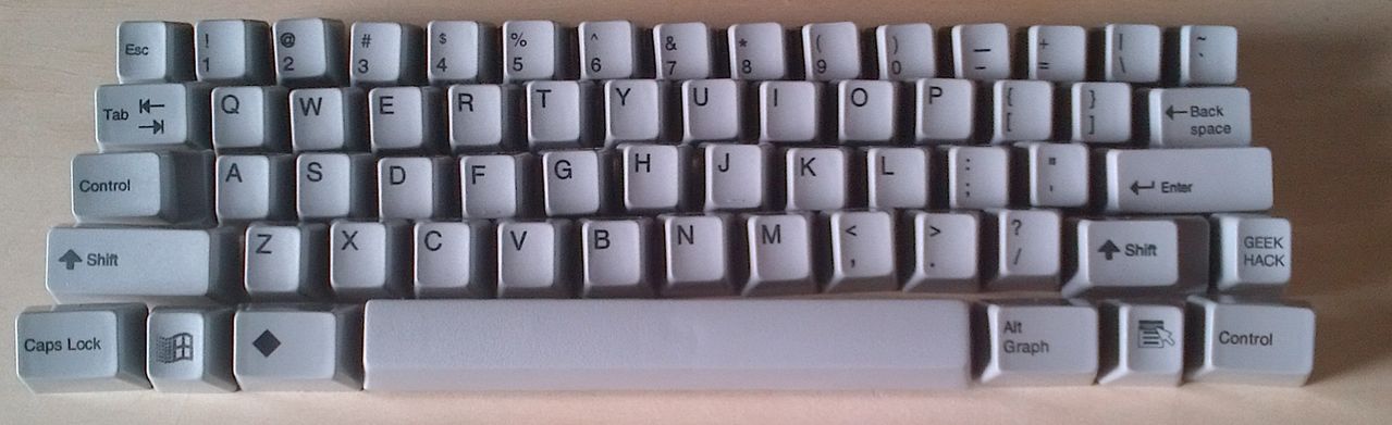

jbondeson - for the HHKB style layout, the stepped caps lock key for the left part of the split right shift key and a regular 1 unit key for the function key (the right part of the split right shift key) is what the HHKB style crowd is asking for. If you don't want a stepped caps lock key in that place, it's my understanding you can buy a full JIS key set from Unicomp for that one non-stepped shift key, or you can just use the regular right shift key.
Allow me to repost an example HHKB style photo for reference:

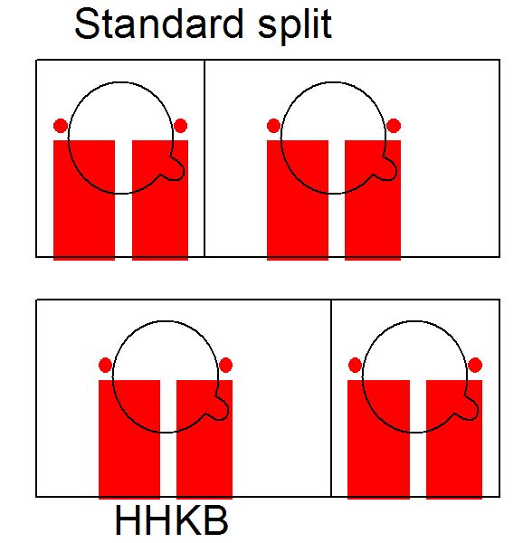

Unicomp Japanese 106 key layout has the normal right shift key barrel positions, meaning a 1x on the left side and a 1.75x non stepped key on the right side. Yes, a normal right shift can replace both of those keys.hammelgammler wrote: -snip-
What we can use a real right shift with the JIS set? That would be fantastic! But could be really use the normal right shift with HHKB layout? Shouldn't the barrels be in different places to even support the split shift? That would mean you have three options with HHKB style: normal, stepped split and JIS split?
The F62 'HHKB' layout in my image above, has unique right shift barrel positions. A 1.75x key on the left and a 1x key on the right. A normal right shift cannot be used with this layout.
Vizir - I am trying to make the powdercoating like on the original 4704 keyboards. Here's an example of the F77 texture and original color. The white balance is off in this photo. For the gray color I hope to approximate RAL 7030 gray like in the Kishsaver of a fellow DT member: http://deskthority.net/viewtopic.php?p=148314#p148314

"HHKB" style will never be possible starting from a "standard" right shift. The right side of a "standard" right shift has the pivot plate centered at the left edge of where you would want to put the Function key. A "Standard" style top plate and PCB can use either a standard 2.75x right shift cap OR a 1x cap + a 1.75x cap. A "HHKB" style top plate and PCB can only use a 1.75x cap + 1x cap (OK - you could use any smaller cap in place of the 1.75x cap, but there will be a gap on at least one side).
