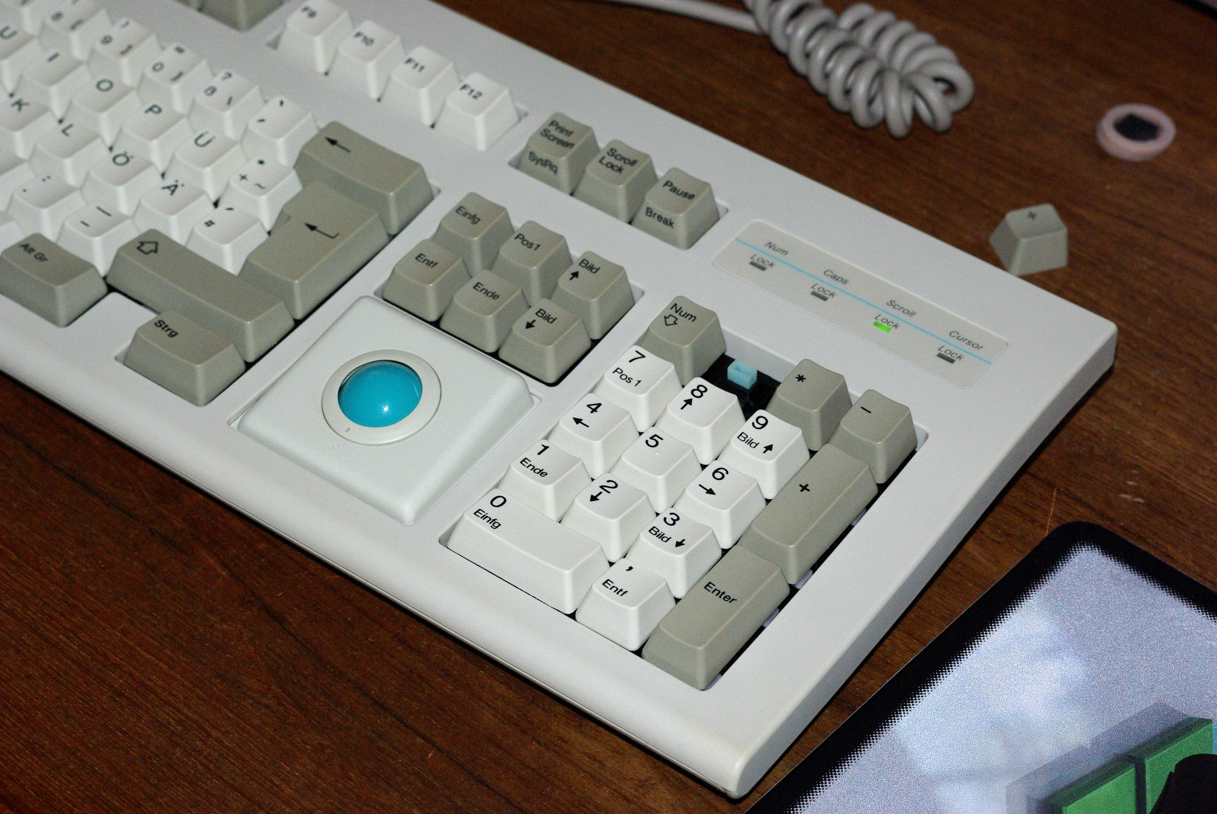

Brot wrote: I never used the numpad enter during my entire life :D
I do, all the time! Especially on this keyboard... :maverick:
Chicony KB-5591 @ SMK Alps mount "Monterey":

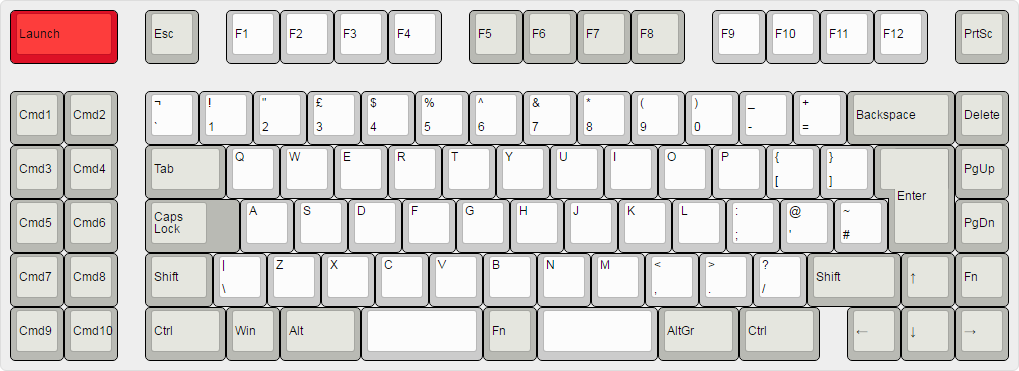

Here's my take on Menuhins layout:
75% plus.png (30.33 KiB) Viewed 8502 times

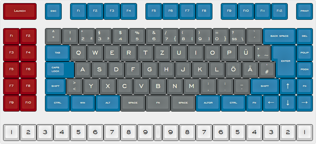

I'll probably build the following one with my (hopefully soon to be here) Round 5 caps, with old angled Cherry M9 switches so the SA profile becomes more of a SS profile. I tried to avoid to stabs as much as possible, also I need a solution for the ISO Enter since my M9 switches have angled stems. Will probably go with ANSI enter and split Backspace there.
75% plus (Round 5).png (79.76 KiB) Viewed 8502 times

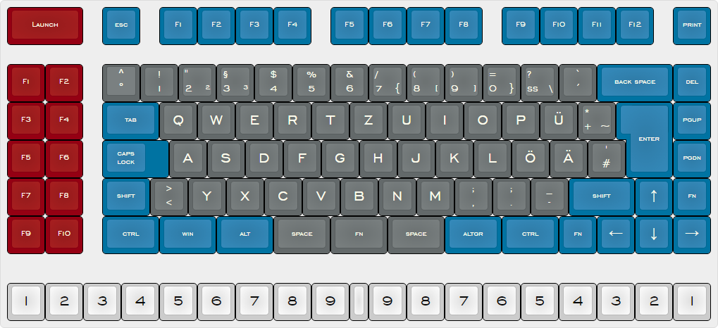

75% plus (Round 5) (ANSI).png (77.75 KiB) Viewed 8502 times
(Weird numbered keys on the bottom are there to show the symmetry of the layout, legends/key functions are of course subject to change)
I really love this layout, it let's you keep your mouse near you while having more keys than a TKL keyboard. Also it has a retro vibe which I think fits very well with SA keycaps.

Round 5!!!
I'm just *starting* to wait for Round 7... :oops:
I hope I'm alive and healthy, and financially and mentally fit in Germany when the Round 7 caps eventually reach me.
I bought a Tipro especially for them because I also really like their pseudo Space-Cadet caps - some of their POS caps that are featuring in Hyper7 kit. In this layout, 'Launch' and the left cluster fit these POS caps well. Of course, Tipro itself is nice and easy to change the layout.
If you are a perfectionist, then you'll definitely try to build your ISO layout first. I understand how difficult it is to accustom to another layout, it's like you're very used to eating your Abendbrot but then in some situations all bread you can get are those nasty soft white bread...
But how are you going to build such a board?
CNC? barebone with steel plates? Or ... printed?
I highly recommend keeping those 0.5u or 0.25u separators / blockers. In usability studies, it is multiple times faster to reach keys at the very corners of a layout, and it is also faster to reach a cluster as a group. But to reach individual keys of a cluster, those keys at the edge of the cluster will be easier to reach, e.g. the arrow keys in G80-1800 are well designed as a cluster, it is easier to hit the up arrow and the left arrow and right arrow than to hit the down arrow, while it is easier to reach the down arrow than say the '5' key in the number pad of G80-1800.
Posted: 10 Jan 2017, 17:27
by Nuum
I would build it from a bend steel/alu plate, similar to those Infinity "cases" and handwire it. I'm not sure about ISO because I anyway wanted to try an ISO-HHKB hybrid like that last layout I posted. I'll look into incorporating a small gap towards the arrow keys, thanks for the tip!

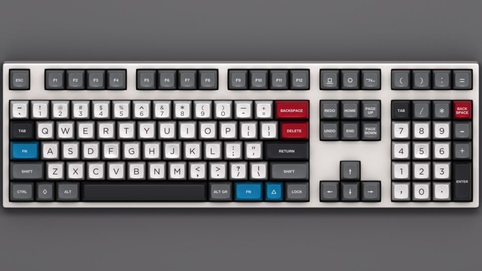

Okay, here's another stab at this:
Notes
I am using Round 6 colors to illustrate functional subsets:
  • White keys generate visible ASCII characters.
  • Black keys generate ASCII whitespace characters.
  • Red keys remove characters.
  • Blue keys configure or activate programmable function layers (primarily for use with the 60% variant).
  • Gray keys are for chording modifiers, cursor navigation, math operations, and special functions.
The numpad is based on ideas gathered from another thread. It was cogently pointed out that with a navcluster present, there is no need to duplicate navigation functions on the numpad, and so NUM LOCK can be freed up for something more useful like TAB. And by reducing the + key to 1u and putting the - key above it, we free up a space for another BACKSPACE key, which can be really handy if you're doing a lot of numerical input.
Having moved the DELETE key underneath the BACKSPACE key, I used its old location for an UNDO/REDO key. I couldn't figure out what function to assign to the key normally legended as "Scroll Lock," so I put a general purpose icon on it as a sort of user-defined placeholder key. I am also not sure what I would want most above the numpad so I just put keys there that I thought would be useful when working in a spreadsheet. Lastly, even though I don't often have use for it, I like the functionality of the ALT-GR key (as used with the "US International" layout). It could be a MENU or META key instead, I guess, but I don't really use the MENU key, whereas I might actually use ALT-GR to generate diacritics now and then.

I really like the idea of using color for functional subset!

I really like the very subtle but crucial changes you made in the 60% area! :)
I think today's 60% should look like this instead.
Reducing the Tab from 1.5 to 1.25, CapsLock 1.75 (now FN) to 1.5, and L_Shift 2.25 to 1.75 give enough space for the Backslash to move from R2 to R4. I think no PCB in the market support this "reduced staggering" arrangement.
But does HHKB JP have some similar?
I also like the color theme - what inspires you to group Enter with Tab?
FN there at CapsLock totally makes sense for modern computing. I still prefer an option for Control over there.
Posted: 16 Jan 2017, 20:58
by zslane
Menuhin wrote: I also like the color theme - what inspires you to group Enter with Tab?
As mentioned, the black keys generate ASCII whitespace characters. The RETURN/ENTER keys generate an ASCII carriage return character, while the TAB key generates an ASCII tab character, both of which are considered whitespace.
That option exists in many versions of firmware. A 1.25u FN keycap and a 1.5u CTRL keycap would take care of the swap. But I wasn't proposing a keycap set, only a layout.
Posted: 16 Jan 2017, 21:16
by Menuhin
@zslane
Forgot to "read the manual" first... :oops:
It's an elegant grouping. Thanks for your answer.

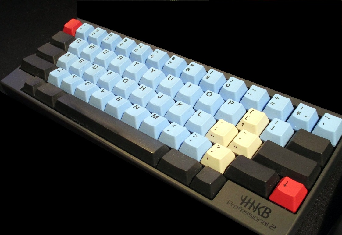

I once had several 84-key (75%) boards, including one with SKCM White Alps. The sound and feel was great, but being a fan of the HHKB, I could never get accustomed to the 75% layout. My preference for form factor is 60% > TKL > Full-size, and for layout, HHKB. Whenever possible, I remap my TKL and Full-size boards to something as close as possible to the HHKB layout. This renders most of the keys redundant, but sometimes it is convenient to have a choice of how to move a cursor or activate a function. The 84-key/75% boards seem like a nice idea, but for me, they occupy the twilight zone of layouts.
My love for the 60% form factor is not all about saving space per se. I have a large desk/worktable. It is more a matter of symmetry -- being able to center the keyboard under my center monitor (3-monitor configuration) and to have the mouse within easier reach than it is with TKL or full-size.
Aesthetically, especially when showcasing an SA-profile spherical-top keycap set, I prefer a full-size board to a TKL. In addition, my recent infatuation with Alps has brought me back to using full-size boards.
Overall, though, for both form and function, I still return to my trusty HHKB (lubed and silenced, and decked out with a custom blend of caps to delineate functional areas -- even if this isn't really needed):

I updated my previous render: the INS/OVR key has been replaced by a REDO key.
I find that I never use the INS key to toggle between insert mode and overwrite mode. Moreover, it is the only key on the keyboard that is a toggle for something that is not tracked by the keyboard itself. It is tracked/used strictly at the application level, if it is tracked/used at all. Since I already put UNDO on my layout, I figured I might as well put REDO on there as well.

Good to have a peek at Hypersphere's HHKB.
3 sets of key caps to achieve this clean and articulated look.
I went with HHKB instead of HHKB JP (I like its arrow keys!) because of its symmetrical aesthetics. I do miss the nav keys when I'm outside of Emacs / vi or the shell. By placing a full size or TKL keyboard so that the homing keys squarely face the monitor, even the TKL will be 'sticking' out on the right hand side.
The default arrow keys setting requires movement of 3 columns to the right. And 2 fingers instead of 3 fingers usage on nav keys. It could be better. (Of course we have Hasu's controller)
