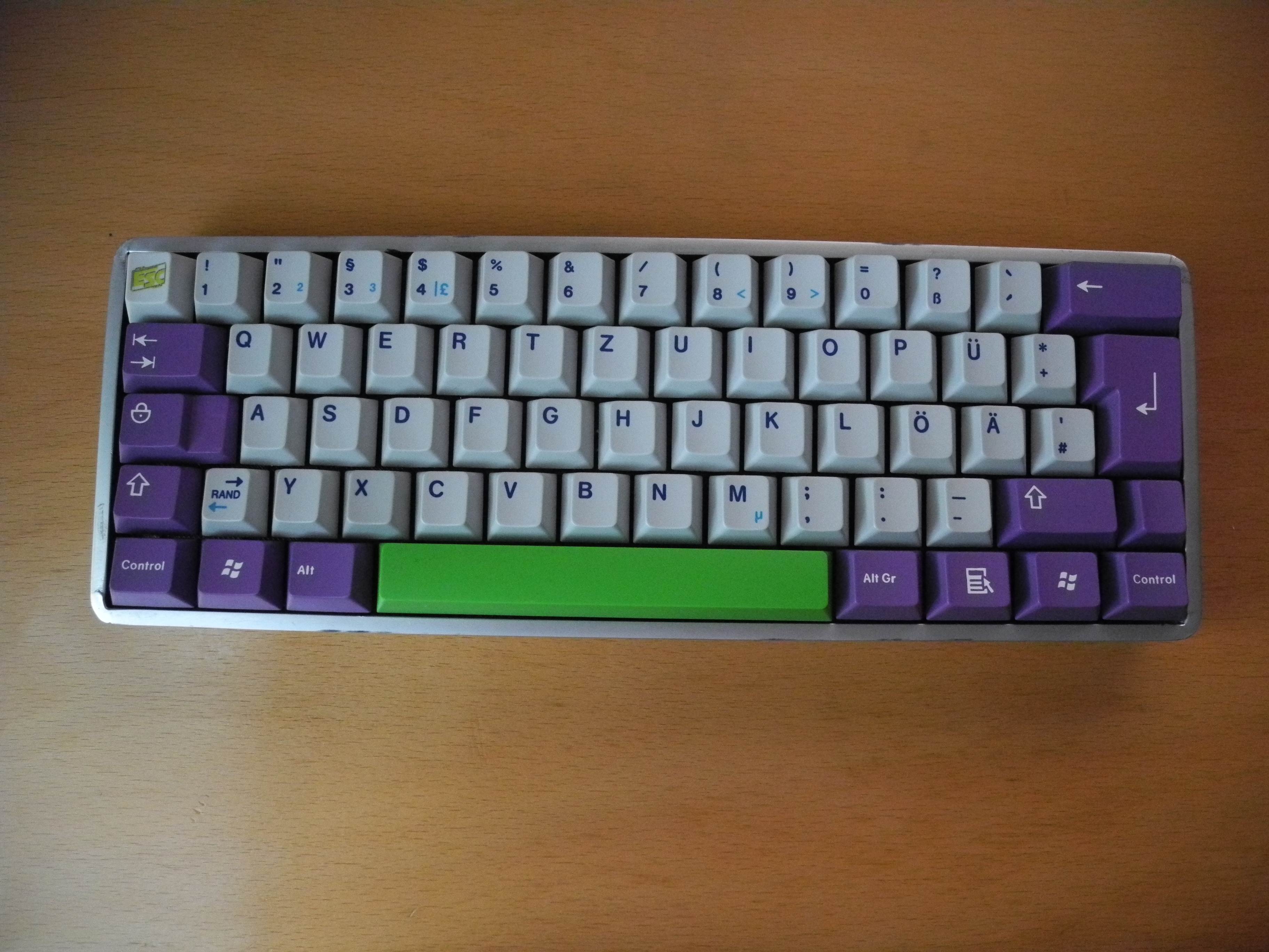

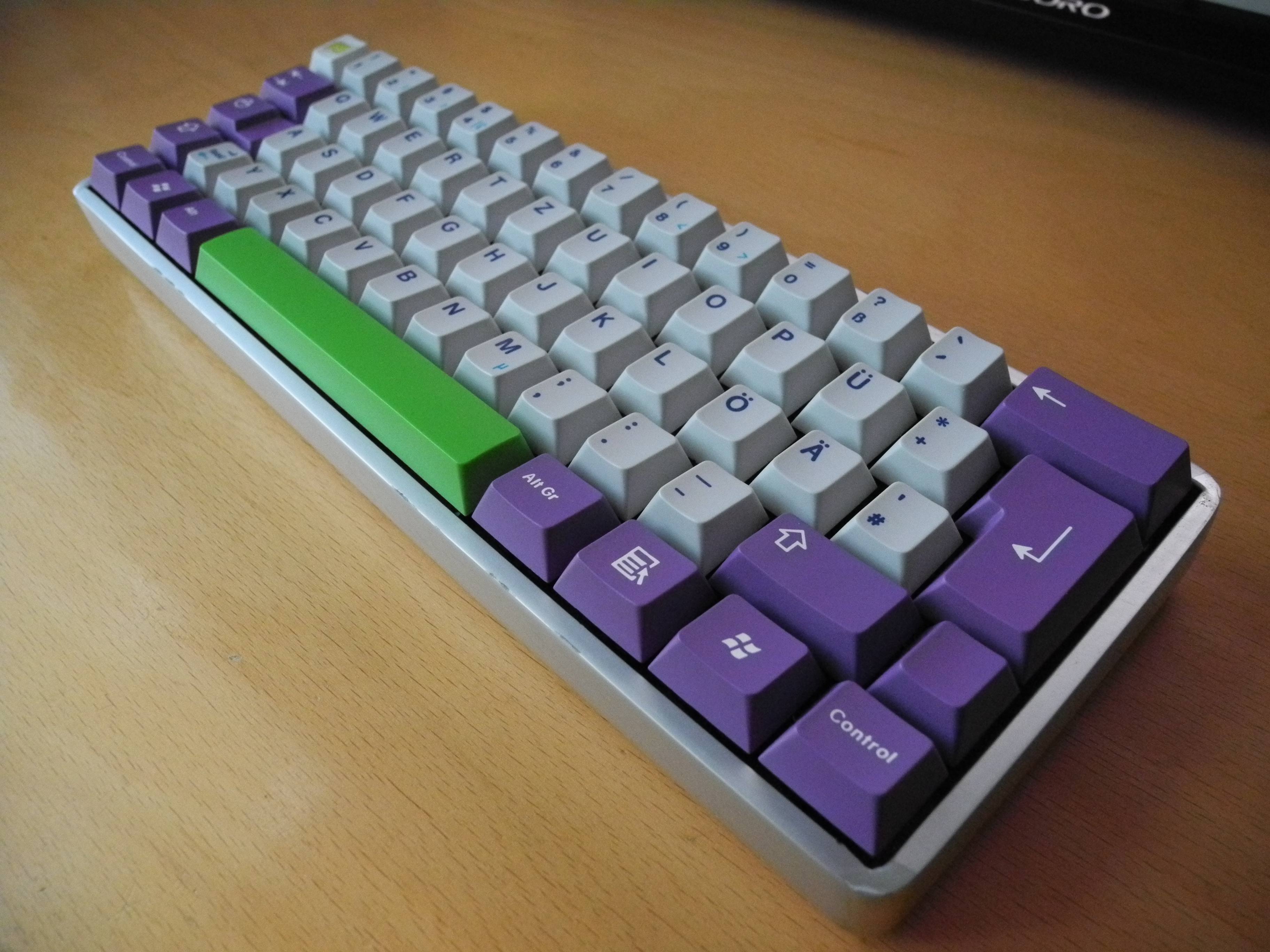

Here are two pictures of my not really working FaceU:
It has 62g Clears, no plate, a Oneproduct aluminium case and it is super heavy and it feels amazing.
But it doesn't really work. :x Everytime I restart my PC or uninstall the drivers or wait for a few minutes and plug it in again it works for a few seconds to minutes. Also sometimes some keys get stuck until I unplug the keyboard. Sometimes keys get omitted. Every other ps2avrU firmware I tried so far has the same problem. It seems like it falls into some kind of sleep mode or the driver crashes, but I don't get any message concerning that.
I've already messed with the Windows energy saving settings, but it didn't help. At least I can get it into Flash mode every now and then. On my laptop it doesn't work at all (Both the laptop and my desktop PC are on Windows 7 64bit). I've tested the USB cable with my Soarer's converter and it works perfectly fine with it.
This way I can't use my FaceU.
Any ideas?

29 Oct 2014, 22:42
Nuum wrote: Here are two pictures of my not really working FaceU:
Any ideas?
Nice board, shame it isn't working properly :(.
When mine freaked out, I had to flash a firmware and then flash a keymap on top of that...maybe you could try doing the same? I removed the driver from Windows and then did this...

Nuum
04 Nov 2014, 23:11
Ok, I got my FaceU working, it indeed was a faulty USB cable, although the one I used works flawlessly with my Soarer's Converter. Maybe it's a power related problem and Soarer's Converter (on a Model F AT) draws less power than the FaceU (No LEDs except Caps Lock) and the power lead of said cable was broken/too thin.
Now I need to accommodate to the 60% layout, so far I like it.
