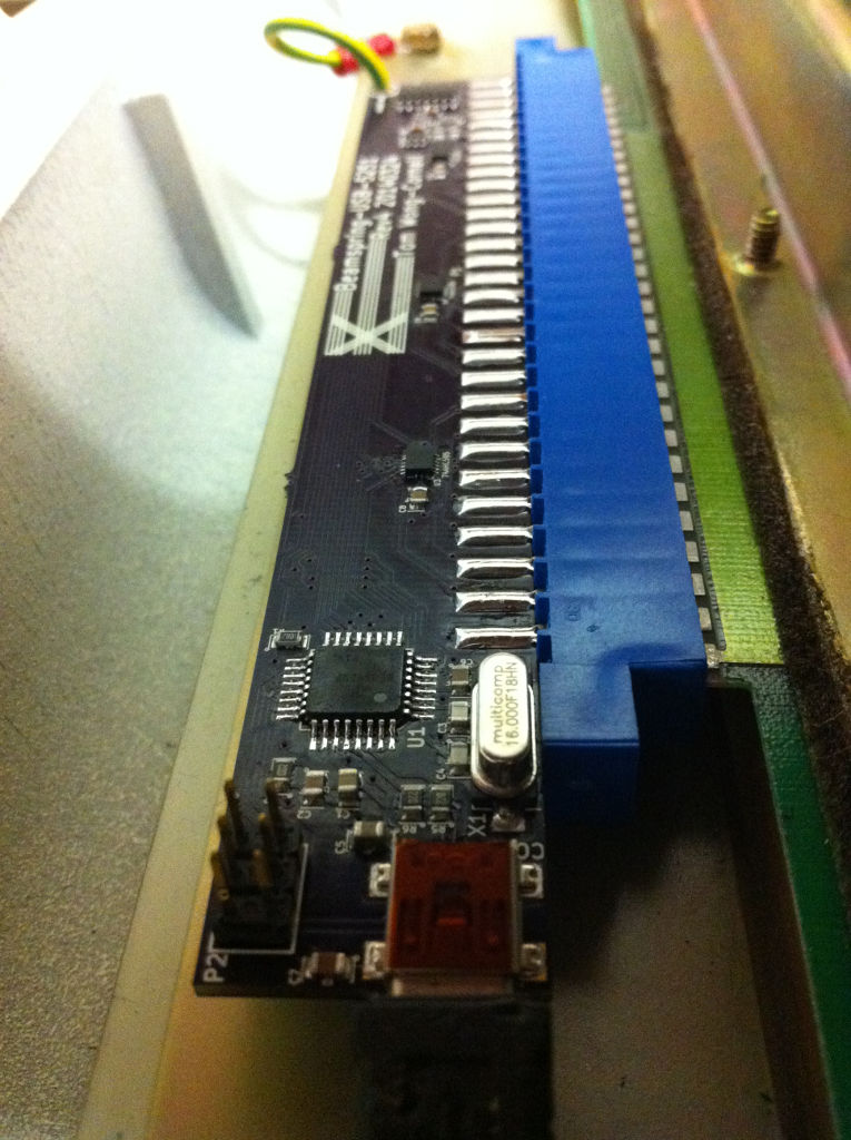

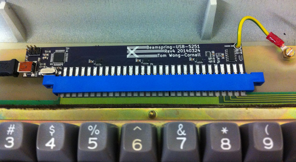

by xwhatsit
First Rev4 all assembled and humming along nicely (I had to thieve a ATmega32U2 from another piece of equipment—swapped it for an 8U2—my damned eBay 32U2s still haven't arrived, lazy Americans and their postal system!):
photo 1.JPG (127.96 KiB) Viewed 9314 times
photo 2.JPG (138.77 KiB) Viewed 9314 times
The AHC-series shift registers seem to have given a little bit more headroom, which is what the aim was by moving to them; autocalibrate is coming out with some bigger numbers than the Rev3 boards, which means there's more space between pressed keys and unpressed keys. I might be able to get things even nicer, as I have hooked up both the output-enable and storage register strobe lines for the 595 shift registers, so might be able to get a slightly snappier pull-down on the other channels instead of leaving things floating for periods with the 4094s. Bodes well for a Model F when I get around to that. Also means I can crack ahead with the Displaywriter board when I get a moment!
I don't have the parts or the boards for the solenoid driver yet, but you can see the header P2 for the external interfacing to it. I made a balls-up with the solenoid driver board, and swapped the pins for power enable and solenoid drive; this means I'll have to handle the solenoid timing in software instead of using the timer compare output to do it for me. Either that or I don't use a ribbon cable and just hook up individual wires, in which case I can swap the pins.
Oh yeah and much nicer assembly with this board being single-sided. Only one trip through the oven!
