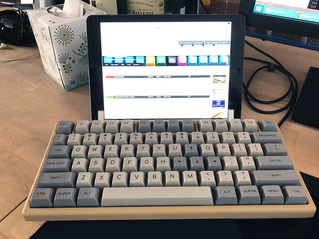

Here's a quick pic of the painted board, which I have nicknamed Plum M075:
It turns out there's no room inside the case for dampening material. The result is that the switches produce a very loud and pronounced thock sound when typing (I am an inveterate bottom-out typist). Now, I know that Topre switches are famous for their thock sound, but I find that in reality, a genuine Topre board has more of a softer fopp sound. The sound of the Plum is kind of satisfying in its own way, but at work I am a little self-conscious about how loud the thock is.

Very nice!
Did you talk about the painting process/what was involved used anywhere that I missed?
I've been thinking about going down that road at some point - Bit too white for my liking at stock
zslane
02 May 2017, 21:06
No, I didn't document the process. But it is identical to the process I used for painting my RealForce RGB case top white.
1. Open case and remove board. (This is actually harder than you might expect)
2. Spray multiple coats of VHT vinyl dye "Buckskin Tan" (10 minutes of drying between coats).
3. Allow 24 hours for dye to fully cure/harden. (I should have waited 7 days, but I just couldn't wait that long to start usingit.)
4. Rub down case with soft cotton rag to smooth out all the surfaces.
5. Reassemble keyboard and case.
One tricky bit is that the little white switch that sets the board's "mode" (Office, Media, Pro) will fall out once you remove the daughter board from the case bottom. It takes a little finesse to get it back into position just right while you re-mount the daughter board when reassembling everything.
