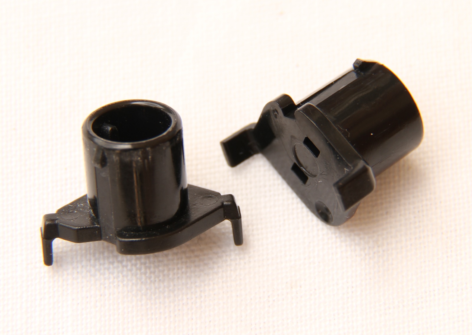

Has anyone here tested the Silencing Rings in the HiPro keyboard? If not, based on what you know about the design, would you expect the rings to work?
UPDATE: I checked the Deskthority Wiki, where there is an image of a standard slider next to a HiPro slider. They are the same height, but the design of the base in the HiPro differs from that of the standard Topre slider. Unfortunately, the base design in the HiPro looks similar to that of the Left Control in the RF87U, and I have determined that a Silencing Ring cannot be used on this particular slider. Based on this, I think that the rings might not work in the HiPro, but this has not been tested directly as far as I know.

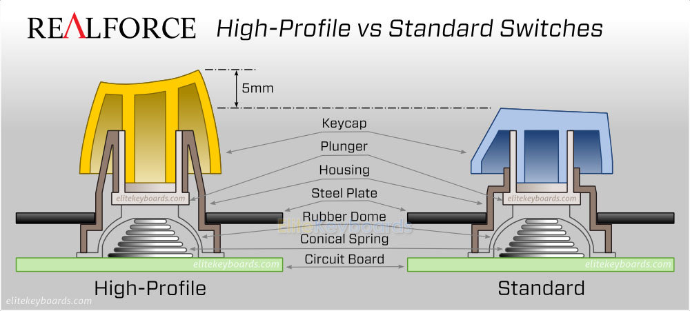

Yes, unfortunately, it appears that the rings might not work on the HiPro. Here is the pic from the DT wiki:
The design of the base on the HiPro slider looks similar to that of the slider in the Left Control switch of the RF87U keyboard, and I have found that a Silencing Ring cannot be used on that particular switch.
I haven't tested a HiPro directly, and I am unaware of anyone else testing one with Silencing Rings. If you like, I could send you a few rings for you to test. If you were willing to do this, it would be valuable information to share, regardless of how it turns out. Please send me a PM if you are interested in pursuing this.

The problem in the 87U's left Control key is the switch housing, rather than the altered slider. I reckon there's still a good chance the rings will work fine on a HiPro. But it definitely remains a guess until someone tries!

Could you show us on the HiPro switch diagram where the keycap is hitting the switch housing?

On the switch diagram above, the bottoming out is the underside of the yellow "keycap" hitting the top of the brown "housing". This is a result of the "housing" being so much taller on a HiPro.
There is a small chance that these rings would help if placed at the position I just described. However IIRC the "plunger" does not protrude from the "housing" enough to keep the rings centered.
If you are willing to invest the time, you would be able to use your 2 extra rings to find out if they are going to work in the HiPro.
Regarding the bottoming-out noise in the HiPro, it looks like it might work to put a conventional rubber O-ring on the stem of the keycap. This is something you could readily test if you have some standard O-rings. I don't think the Silencing Rings would help with the bottoming-out issue.

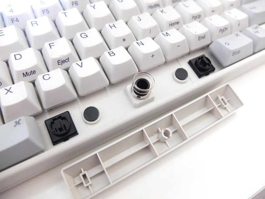

@Hypersphere i know this is basic question but how exactly should you lube the stabilizers? where do you put the lubricant?
when i pull my board apart i want to try to kill as much noise as possible and the space bar is the main offender.
is the self adhesive rubber available online? i dont suppose you took a picture of where you installed it? :)

@roboticus: The lubing of keyboards seems like a religion, and you will find varied advice on what type of lube to use for switches or stabilizers and how it ought to be applied. There is a guide for Cherry mx keyboards at the following site:
http://imgur.com/a/lhLqo
Although this is for Cherry mx, the same principles apply to other types of keyboards.
In general, I apply a small amount of a lubricant grease such as MechLube 2, Krytox GPL 205, or SuperLube grease to points of contact between the stabilizer wire and plastic -- wherever there is a potential point of friction.
For the foam strips, I use a product from a Carpenter Brothers hardware store (USA) called "Doit" Foam Strips, 1/2 x 2 3/8 inch, approximately 1 mm thick. They are self-adhesive. I cut 2 squares of the material about 3/8 inch on each edge. I found a very similar product (possibly identical, as it had the same part number as the material I used) listed online:
https://www.doitbest.com/products/anti- ... d?q=241059
I apply these under the space bar. On the HHKB, I put the squares on top of the rubber circles that are already under the space bar on each side of the center spacebar switch.
On other keyboards, I center each square about 2.5 cm from the center of the central spacebar switch.
