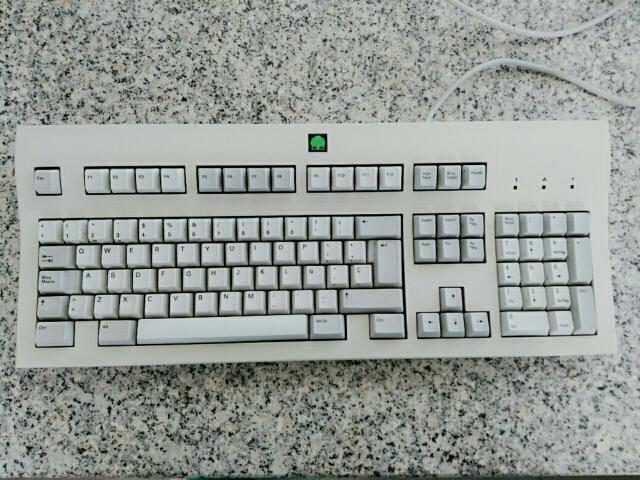

Can anyone identify the teal switches in this image? Looks like they might be some kind of Omron B3G-S clones but don't remember ever seeing them before.

Blaise170 wrote: Can anyone identify the teal switches in this image? Looks like they might be some kind of Omron B3G-S clones but don't remember ever seeing them before.
P.S. Anyone know where the orange SMK switches come from? I don't think I've ever seen a keyboard with them.
The teal switches should be
Dai-Ichi_CL-1145_Green
