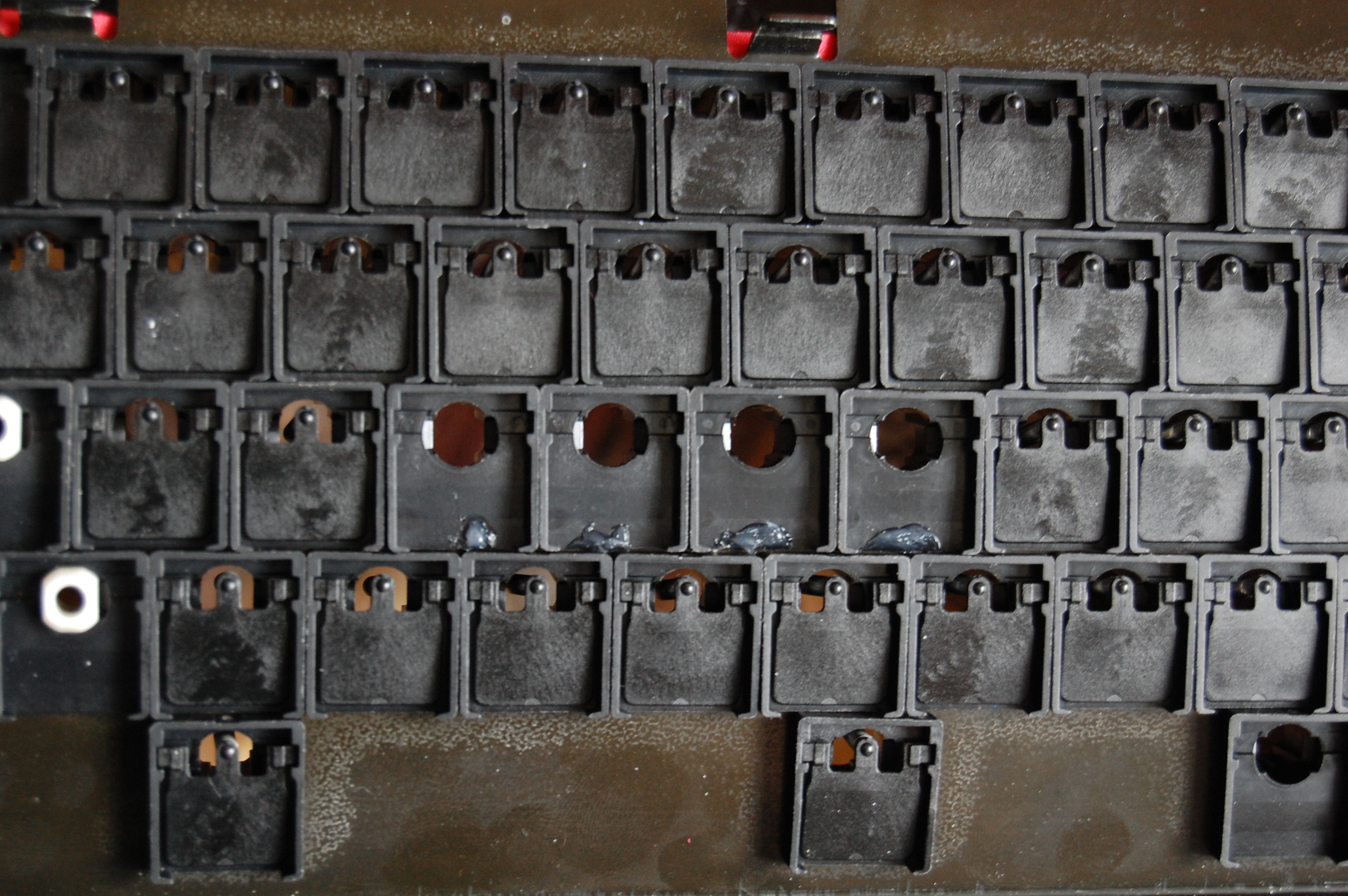

Re: (Model MF) Remodeling the Model M (aka.. the Mara)
Posted: 30 Jul 2020, 23:47
by ppCircle
In case someone is interested, this is how the flippers look on the Polish ICE (Model F AT clone)
It's probably easier and cheaper to get metal flippers made

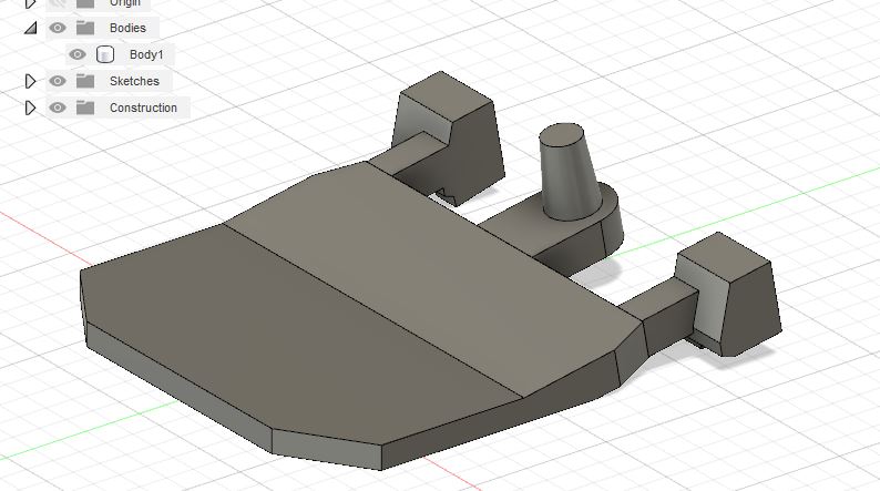

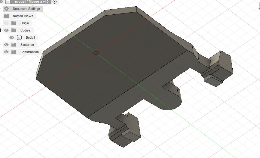

Posted: 31 Jul 2020, 22:15
by SneakyRobb
Hi,
This model is not optimal/may not work but its my progress so far. The dimensions do need to be edited. It is untested and may not exactly work/fit yet. So do not take this as a working model. It's just my current draft.
I think the nubs on the "ears" are not optimal and extend down too far.
I just got the resin printer for making beamspring parts so I'm not very good at it. I will try printing the flipper again. The first attempt didn't work at all. The resin... had some issues.
When I get more experience I will just add 20% graphite to the resin and see if that works.
Robb
flipper untested.zip
(46.37 KiB) Downloaded 317 times
Posted: 02 Aug 2020, 02:20
by SneakyRobb
Hi,
Okay it needs refinement but I managed to make a new model f flipper in resin. Very exciting.
Dunno if work. Seems a bit wide. Regardless happy with results.

@SneakyRobb: The shape of the flipper looks good. However, does it have capactitive properties? The model F flippers have either carbon black or short carbon fibers added to the plastic to impart electrical capacitance. Have you added either of these ingredients to your resin?
Posted: 02 Aug 2020, 18:20
by zrrion
I imagine you could adhere some foil to the flipper to make it capacitive without having to mess with custom plastic flavors
