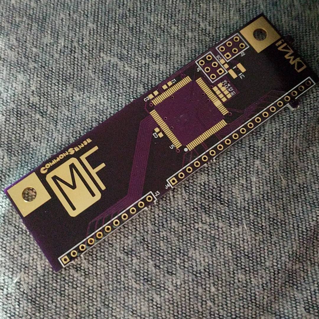

Posted: 16 Sep 2017, 04:15
by DMA
Thought I'll leave this here. Got this in the mail today.
Re: [Progress]CommonSense controller - better capsense.
Posted: 16 Sep 2017, 06:15
by Techno Trousers
Wowie wow wow, that is one gorgeous piece of hardware!!
Posted: 16 Sep 2017, 10:58
by drevyek
fantastic! Really great looking board.
