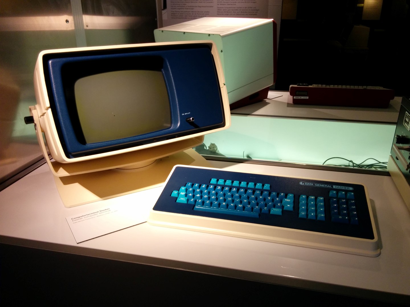

2 moody shots for motivation:
IMG_20141227_155645 (Large).jpg (236.9 KiB) Viewed 6179 times

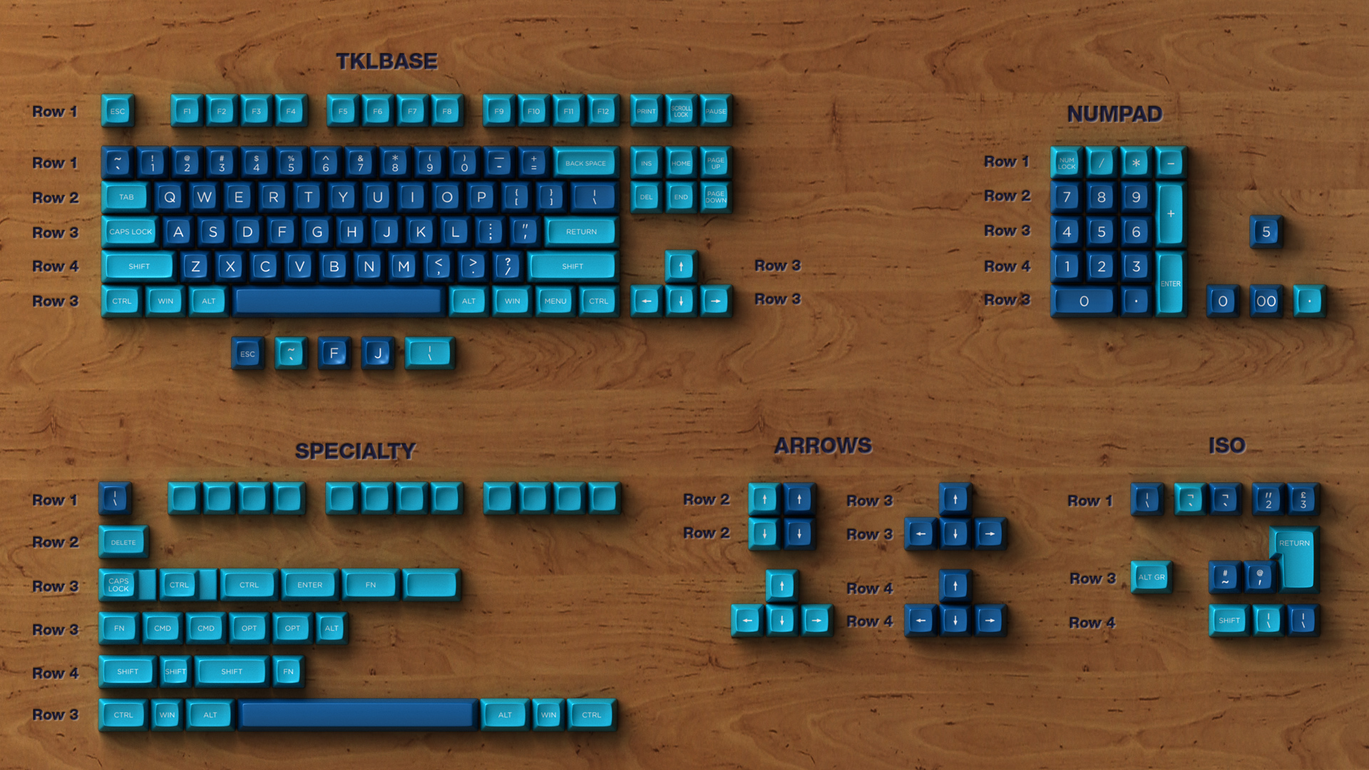

Here is a new render of all the kits. I've added the necessary keys to the ARROWS kit. I added a 2.25u Shift key and a set of R1 blanks to the SPECIALTY kit.
I'm still struggling with the lack of photorealism in my renders, but I have my new computer now and will work on lighting experiments over the holidays.

Do we feel that these five kits, as shown, are ready for taking out onto the campaign trail?
16 Dec 2015, 19:52
zslane wrote: BTW, I figure I don't need to put extra spacebars up in these renders. I think we can just assume that any GB for this set will include ala cart spacebars as a "kit".
Yes, except that what you call a TKLBASE is actually a TKL. TKLBASE would be just everything without the alnum keys (mainly the dark blue stuff).
Also: You should swap WIN by SUPER.
:o
zslane
16 Dec 2015, 19:57
Ah, I see. Thanks for the tips, 7bit!
