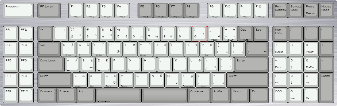

Hi!
This is still a work-in-progress.
The background image is just for contrast. In reality it would just be black.
Its influences are the keyboards of the Amiga, Mac, Sun and others!
Please let me know what you think! Feedback would be grateful!
Posted: 31 Oct 2016, 10:08
by Scarpia
Incognito wrote: Yes well - I'm no big fan of standard either - I much prefer something akin to CP/M machine keyboards - the challenge, of course, is to find matching keycaps. I have refined my previous design and who knows - some day I may have time to build it?
That is a sexy looking layout - I wish standard DK keyboards looked more like this, with easily accessible semicolons and brackets/braces for coding.

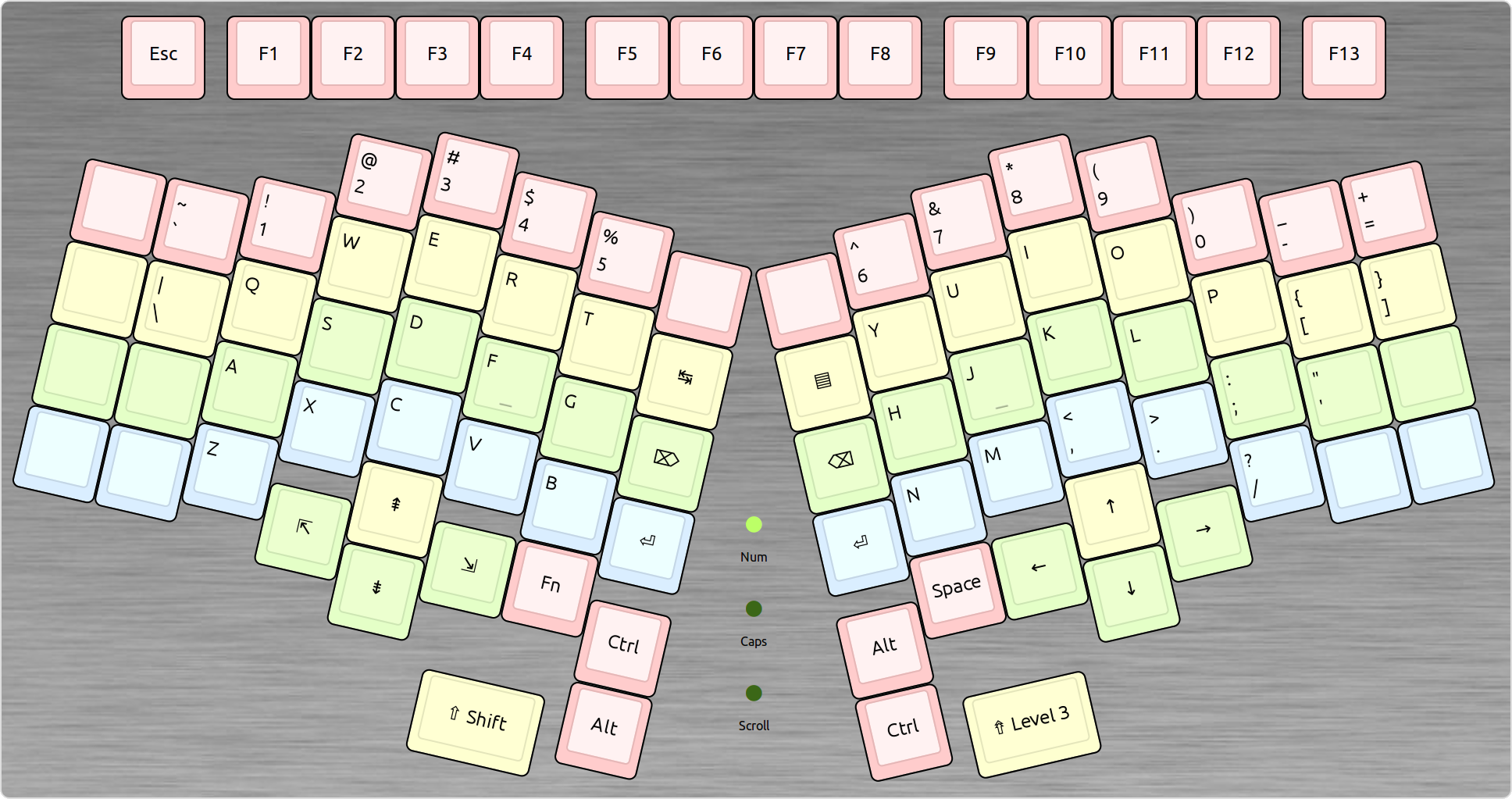

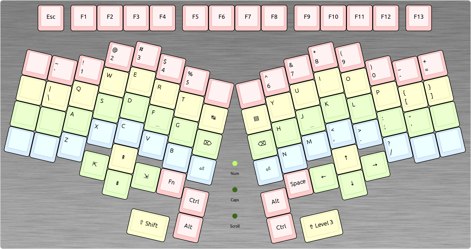

I’m starting a DIY keyboard project and I came up with this layout. Keycap color indicates DCS row; the actual keycaps will all be white and blank. Key assignments are tentative and subject to change.
It is heavily inspired by Truly Ergonomic (symmetry + column stagger). Changes I introduce:
  • Matias Quiet Click switches instead of Cherry MX Brown
  • More aggressive column stagger (based on highly scientific lay-hand-on-grid-paper measurement)
  • Wider split angle
  • Two editing key columns in the center instead of one, because I notice that I only use my right hand when pressing them
  • Arrow/navigation clusters in their intended columns
  • Moar thumb keys! (Somewhat inspired by Keyboardio.)
Two off-pinky columns on each side because minus and plus wanted to be adjacent (zoom gesture) and so did brackets (for entering them together). Remaining keys in these columns will be populated with characters that are heavily used in programming but ordinarily require Shift, such as: underscore, colon, double quote, maybe parentheses and angle brackets.

Yuri Khan wrote: I’m starting a DIY keyboard project and I came up with this layout. Keycap color indicates DCS row; the actual keycaps will all be white and blank. Key assignments are tentative and subject to change. [...]
Cool layout. The space key is going to be a big pain, but other than that looks pretty good for a flat one-piece keyboard with lots of keys.
I recommend prototyping with paper printouts, then making a bunch of laser-cut acrylic switchplates and popping switches and keycaps on (no need to wire things up) to iterate a few times on the design before you settle on building a working production keyboard. Make sure the design works for the shape and comfortable movements your hands and fingers.
Posted: 07 Nov 2016, 08:10
by Yuri Khan
jacobolus wrote: Cool layout. The space key is going to be a big pain, but other than that looks pretty good for a flat one-piece keyboard with lots of keys.
I see two potential issues with the space. It’s small, and it’s surrounded by other keys. That may make it difficult to hit when not already in typing position. That’s a valid concern, but I think enlarging any one thumb key will either make other thumb keys less accessible or require moving the arrow/navigation clusters outwards which I’d like to avoid because on Truly Ergonomic I tend to hit arrows with the wrong fingers. Right arrow on the pinky is especially bad.
Do you think putting a differently shaped (DSA?) or differently colored keycap will mitigate the aiming problem?
Maybe I’ll end up with an additional space and/or Enter as tap actions on the shifts, which are on the edge and of slightly larger size.
jacobolus wrote: I recommend prototyping with paper printouts, then making a bunch of laser-cut acrylic switchplates and popping switches and keycaps on (no need to wire things up) to iterate a few times on the design before you settle on building a working production keyboard. Make sure the design works for the shape and comfortable movements your hands and fingers.
It means more roundtrips to the laser cutting facility, but it’s ultimately a good idea.
