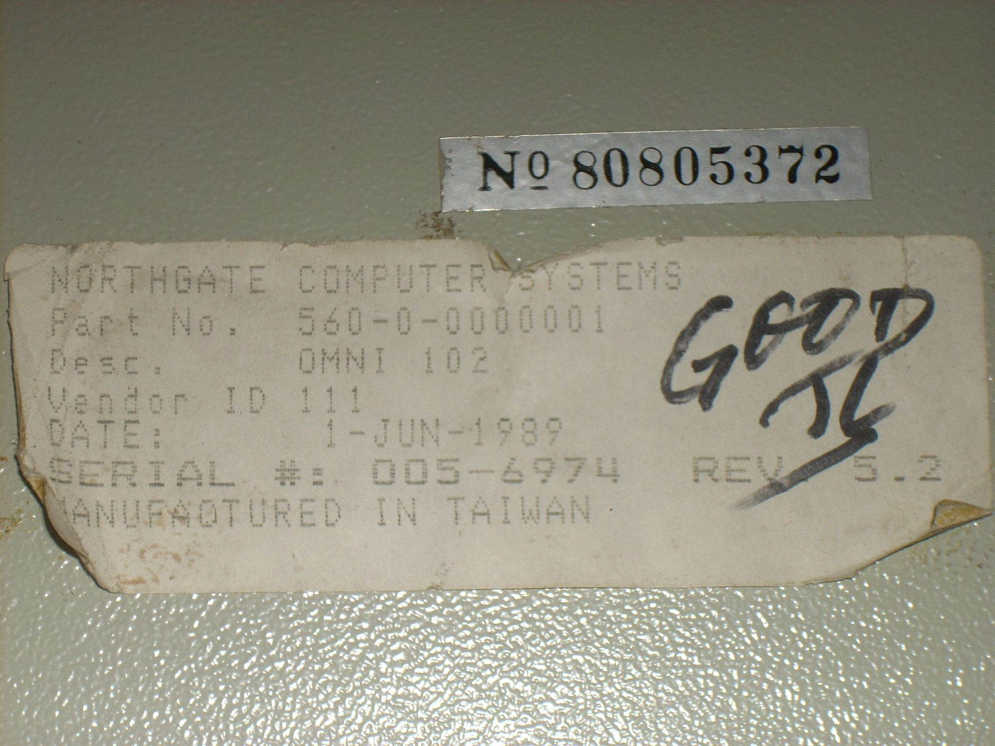

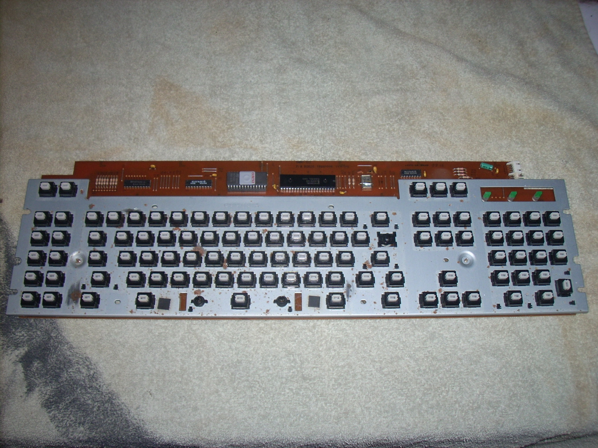

Quick update on the white Alps switches. Photo attached, sorry for the bad quality, it's a three dollar camera. These are from a June 1989 Northgate keyboard, just after the transition from blue to white. Unbranded upper housings, Alps oval logo on the bottom like blues.Daniel Beardsmore wrote:
Two more candidates for wiki entries. Also, it raises the question: short white switchplate blue Alps, or, long white switchplate white Alps?
(One assumes that the model number changed with the change in slider material and corresponding change in pigment, but this isn't actually confirmed. And then there's SKCMCQ, the unknown clicky switch on sale in 1999. Same spec as white Alps, but a different part number. Tentative evidence suggests that bamboo switches kept their pine model numbers.)
Although we can think of Alps switches as having generations, the transition from first to second generation was fairly protracted. With enough such examples in the hands of the right people, it should be possible to determine exactly which modification resulted in the change in the force curve. It's going to be at least one of the springs (click leaf, actuator leaf and return), possibly two or more of them altered (e.g. one spring lighter and the other heavier to compensate).
- DSCN9910.JPG (793.63 KiB) Viewed 7258 times
- Daniel Beardsmore
- Main mouse: MS IMO 1.1
Curious, a date mark on the PCB. I don't associate that with Focus, but I'm not sure I've ever seen the top of a Focus PCB before. (We don't know that Focus were involved with the Omnikey, or whether Northgate's OEM shared one or more suppliers with Focus.)

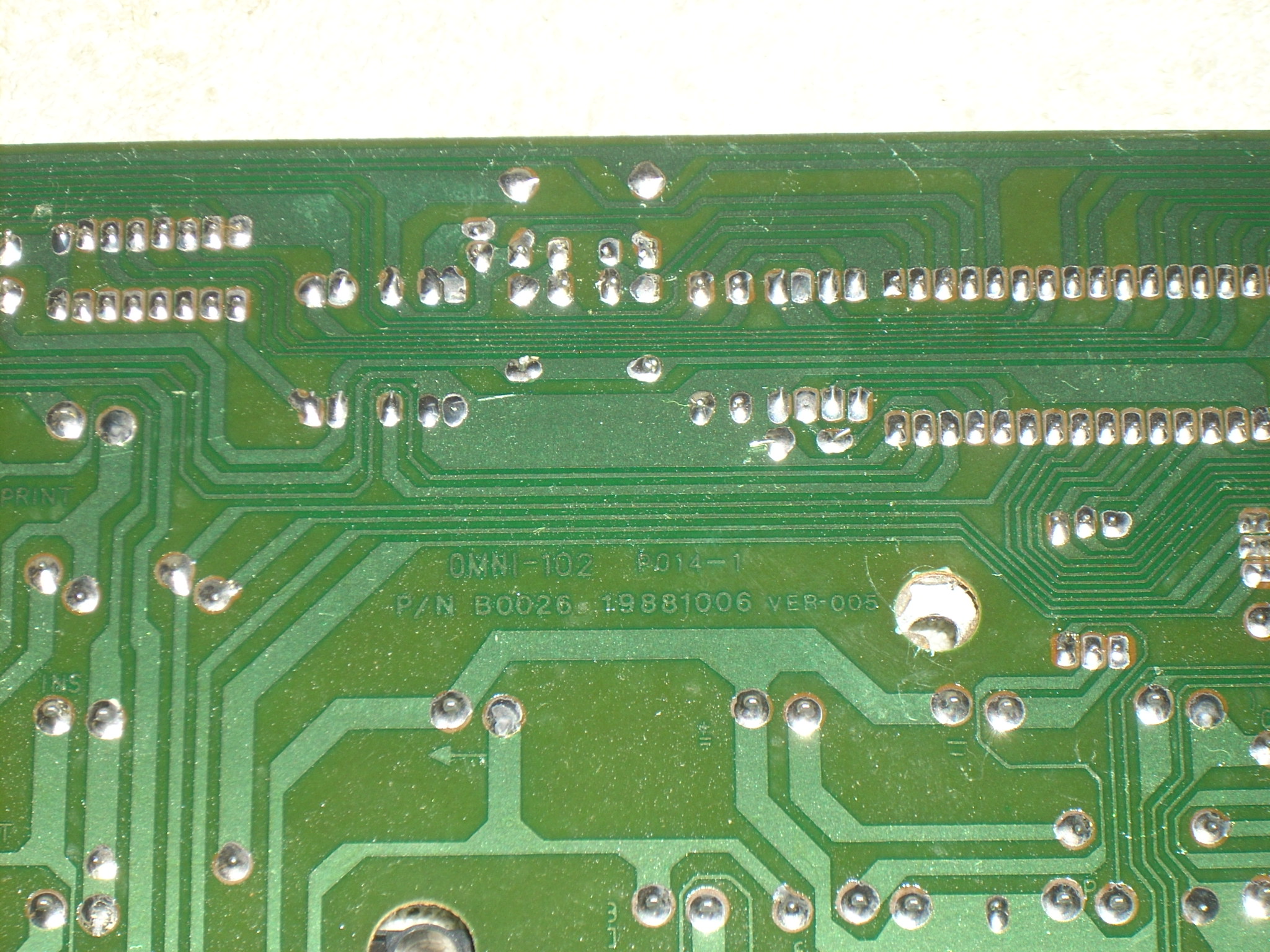

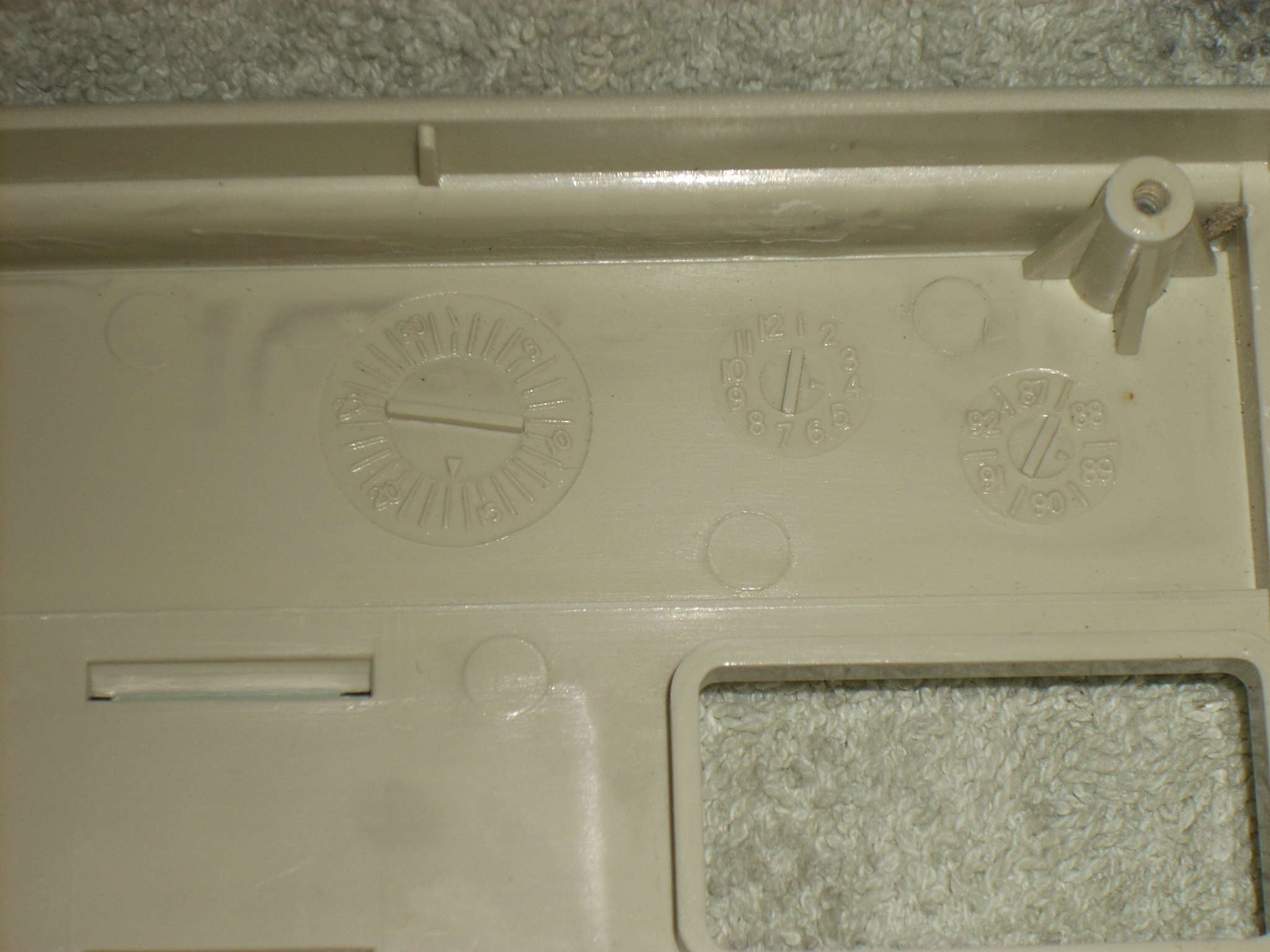

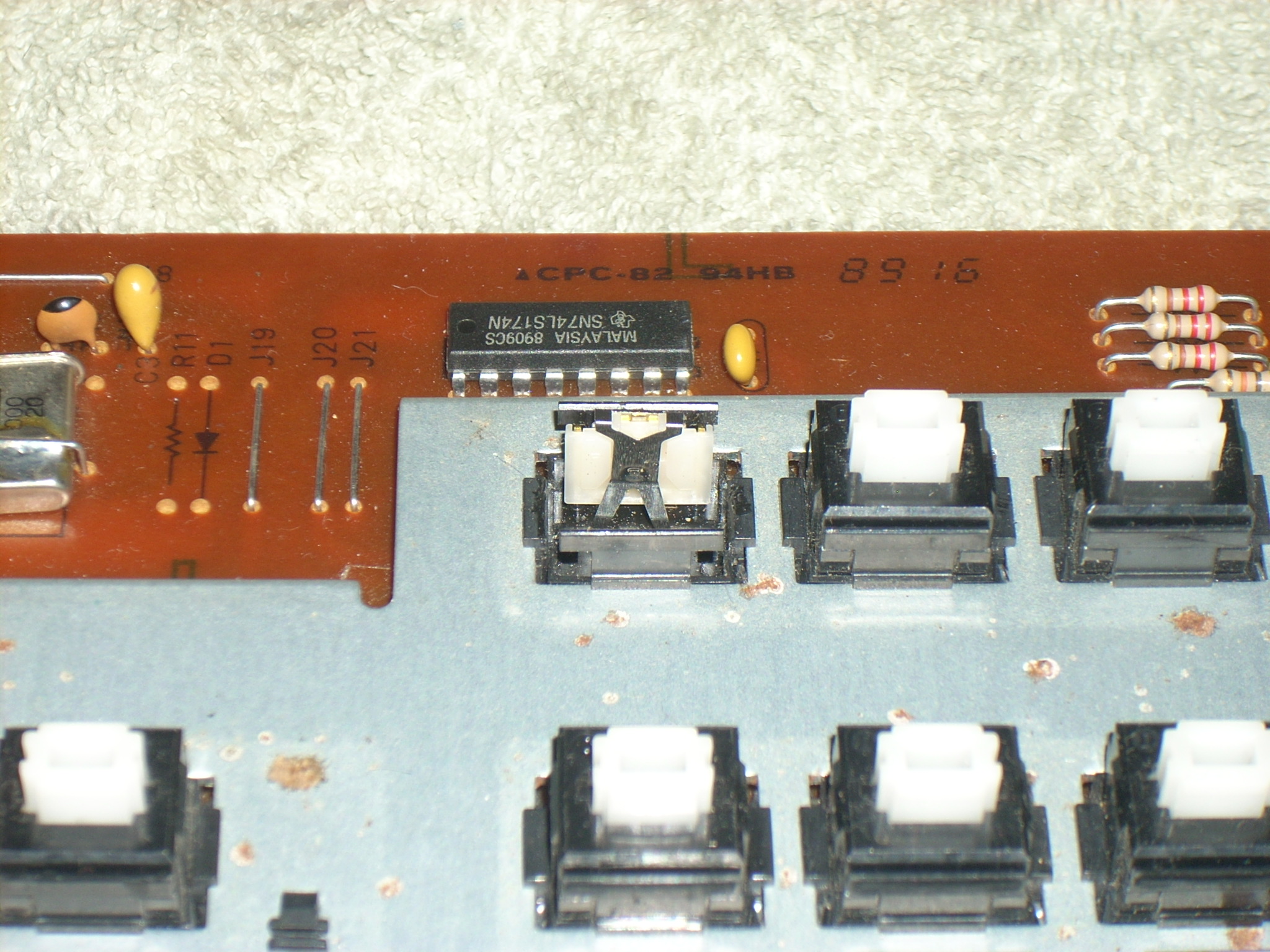

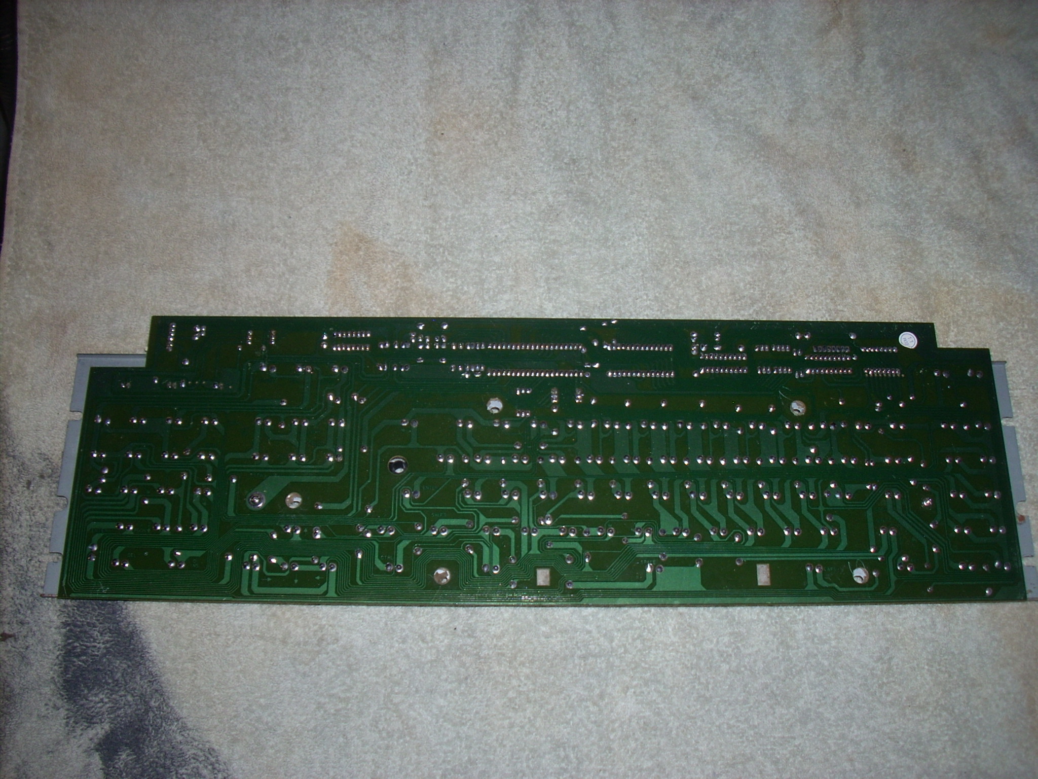

A few more photos of the same Northgate. <attached> Let me know what's important while I have it apart. I'll do the blue Alps version next. I have several Focus keyboards here also if you need info or photos for those. The Focus boards, or some of them at least, had a label similar to the 8 digit one ("No. 80805372"). The paper labels on the Northgates probably didn't survive well, but this one and the one on the blue Alps version from three weeks earlier are still intact.
- DSCN9882.JPG (806.48 KiB) Viewed 7217 times
- DSCN9880.JPG (820.3 KiB) Viewed 7217 times
- DSCN9870.JPG (797.14 KiB) Viewed 7217 times
- DSCN9860.JPG (817.09 KiB) Viewed 7217 times
- DSCN9858.JPG (817.67 KiB) Viewed 7217 times
- Daniel Beardsmore
You seem to have covered pretty much everything in terms of close-up details, but a picture of the entire internals from above and again from below is always good. If there are multiple ICs it's best to cover all of them to help with interpreting the date codes, or where the one in the photo turns out not to have any recognisable date code. Here, though, it's not all that relevant as there are plenty of dates.

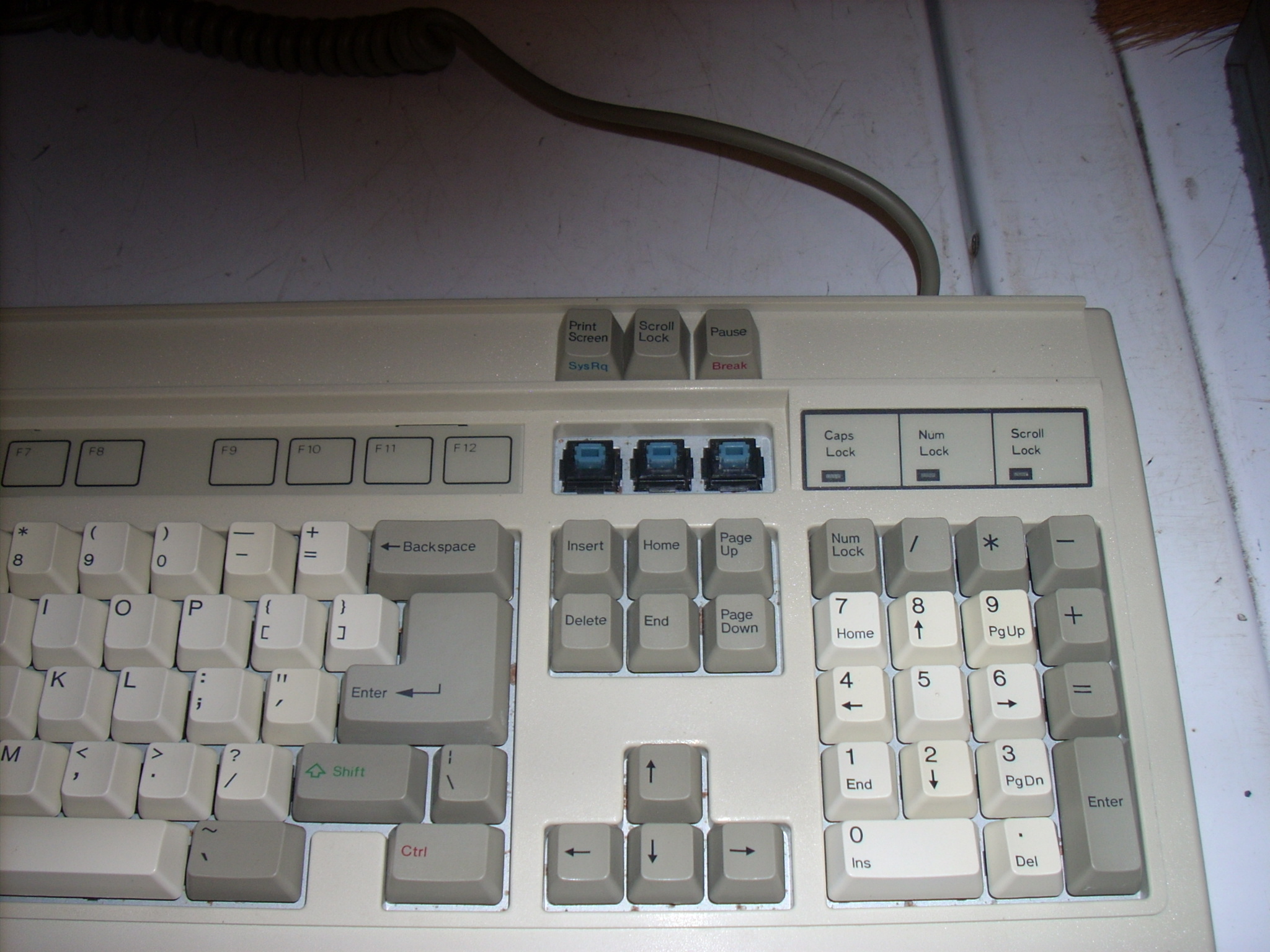

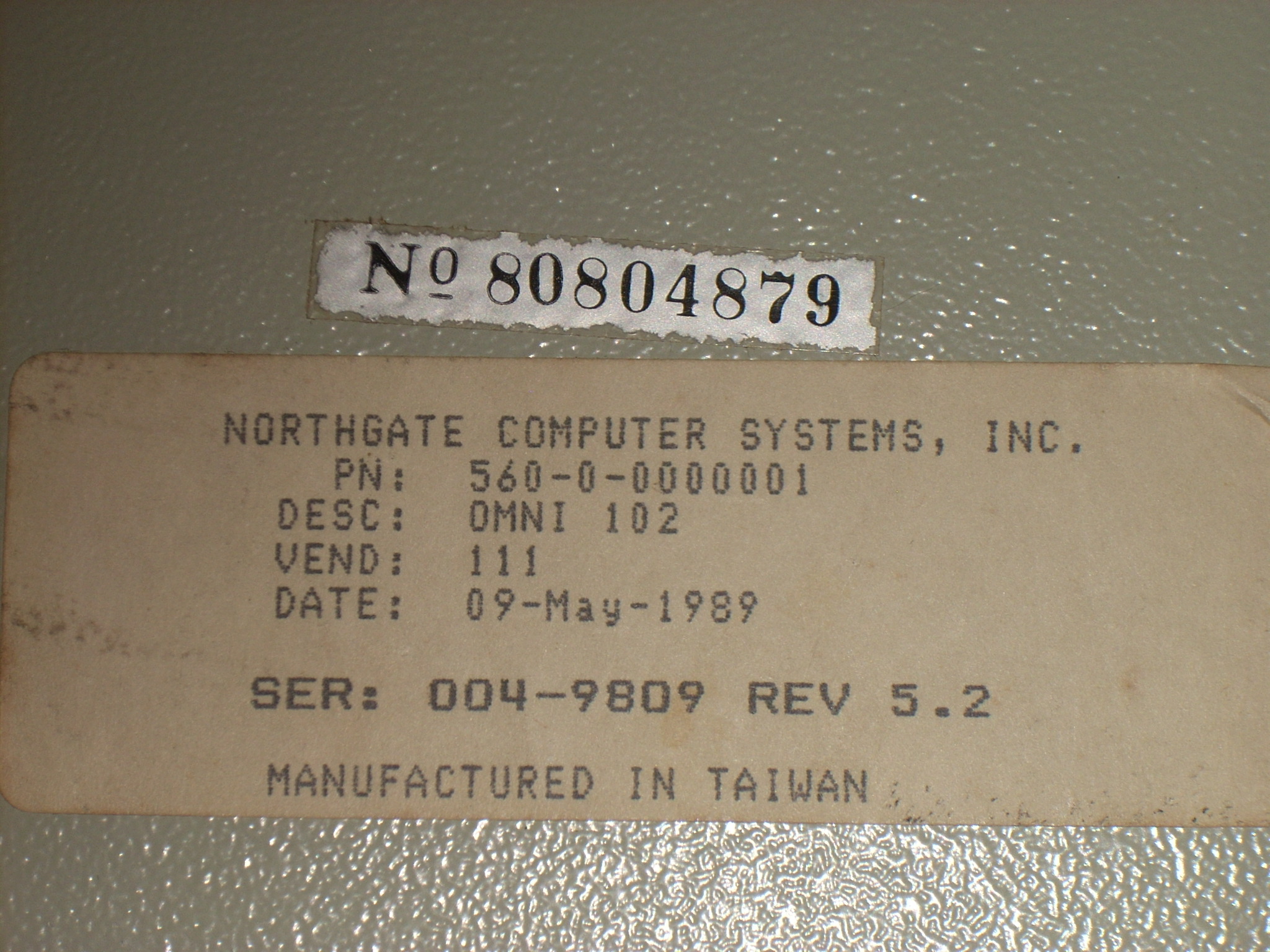

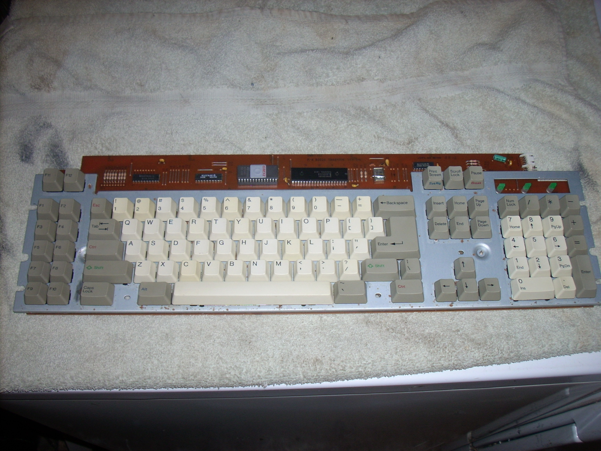

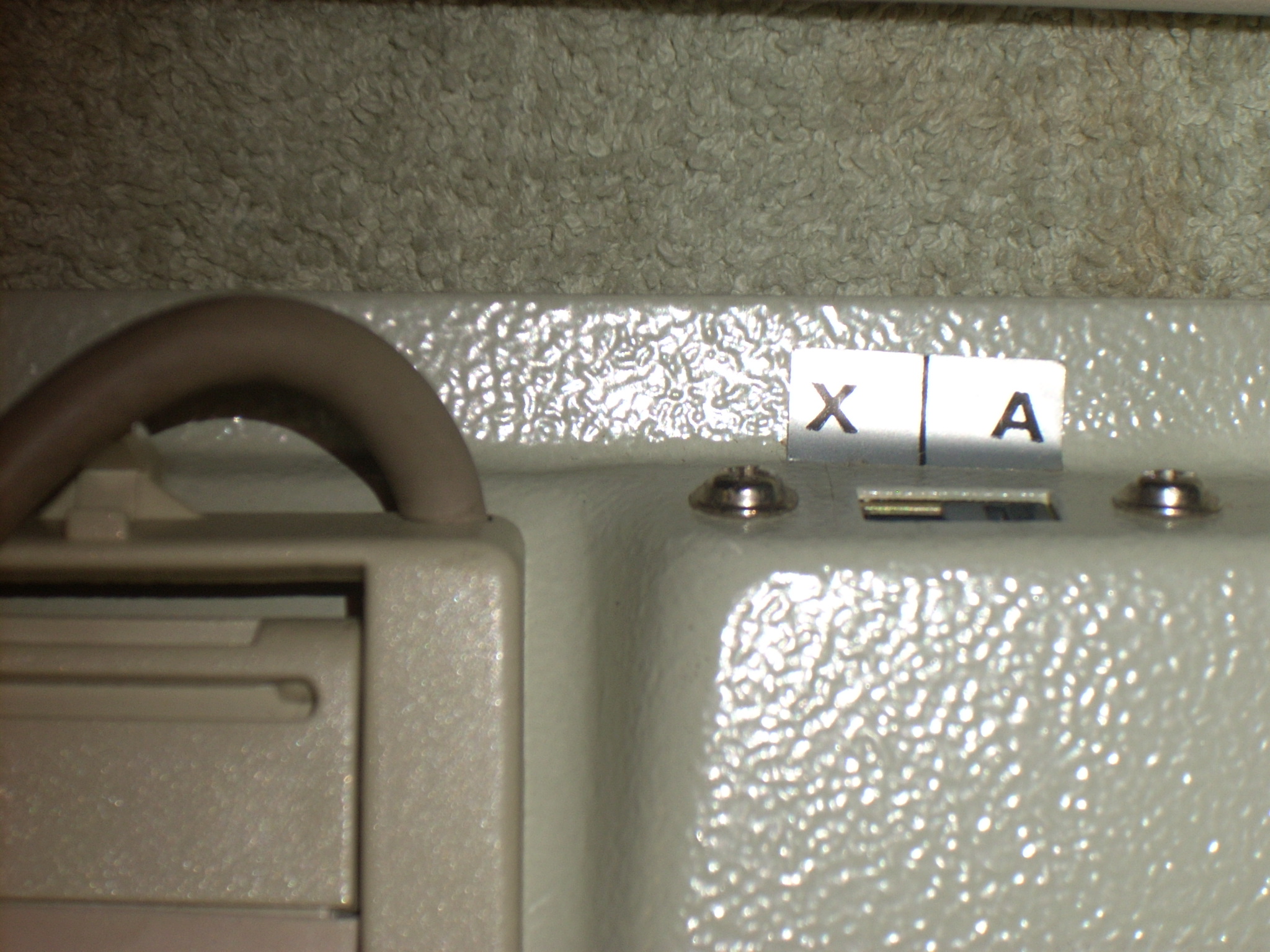

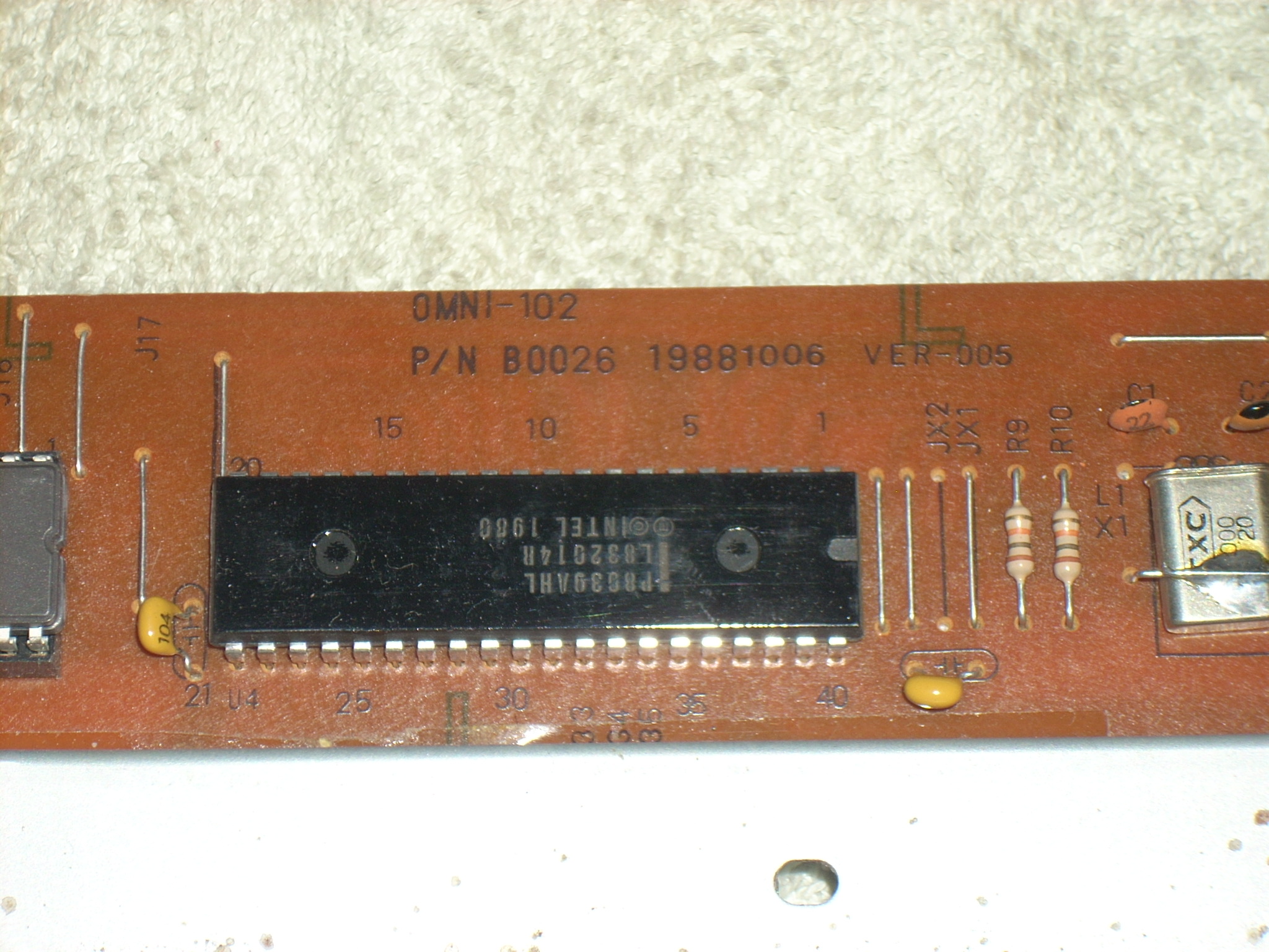

Three more. This is what I call a "first generation" Northgate, with built-in cord, only an XT/AT switch, and the control key in the early position, next to the "A" key. Gold label on the case. I'll take a couple more photos once it's back together. This one was very clean inside. All I did was brush out a bit of dust and clean the caps and case. Single PC board inside, mounted to the *top* of the case, not to the bottom like the later ones. Two pin connector for the switch; four pin for the cable. 5 pin DIN plug.Daniel Beardsmore wrote: You seem to have covered pretty much everything in terms of close-up details, but a picture of the entire internals from above and again from below is always good. If there are multiple ICs it's best to cover all of them to help with interpreting the date codes, or where the one in the photo turns out not to have any recognisable date code. Here, though, it's not all that relevant as there are plenty of dates.
- DSCN9911.JPG (814.87 KiB) Viewed 7160 times
- DSCN9916.JPG (810.56 KiB) Viewed 7160 times
- DSCN9917.JPG (800.18 KiB) Viewed 7160 times
- Daniel Beardsmore
I'm guessing that you don't have a cleaner cloth to use as the background? :-)
- Chyros
- Location: The Netherlands
Wow, that's amazing. My blue Alps gold-label one is less than two months older than your white Alps one Oo .
I knew mine was a very late example, but jeez xD . Looks like both ours are very close to the "switch point", if there was such a thing.
Serial number sticker looks identical, and numbers aren't far off. The revision number and p/n are identical, even the vendor ID is the same. The model sticker is a little different, though.

Neat! I believe there was a "switch point" where white replaced blue, just one of the many changes in the SKCM story that the nice folks here have documented. Hopefully I can help with info from the keyboards I have here.Chyros wrote: Wow, that's amazing. My blue Alps gold-label one is less than two months older than your white Alps one Oo .
As far as I know, the only Northgate model that was available at first was the 102. Very early versions had a black plate, but that changed to silver (bare metal) while the blue Alps switches were still being used. Gold label on the case, fixed location of the control key (next to "A"), built-in cord, XT/AT slide switch, no dipswitches, single board inside mounted to the upper case. I'm calling those "Generation 1" here, for lack of an official designation.
Here's another example that would narrow down the change even further, to about a three week period, assuming there was a "switch point" from blue to white:
