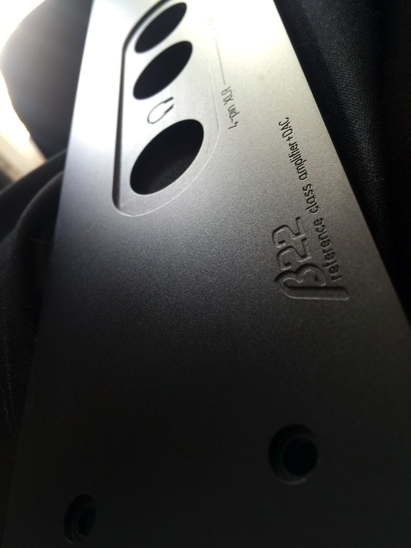

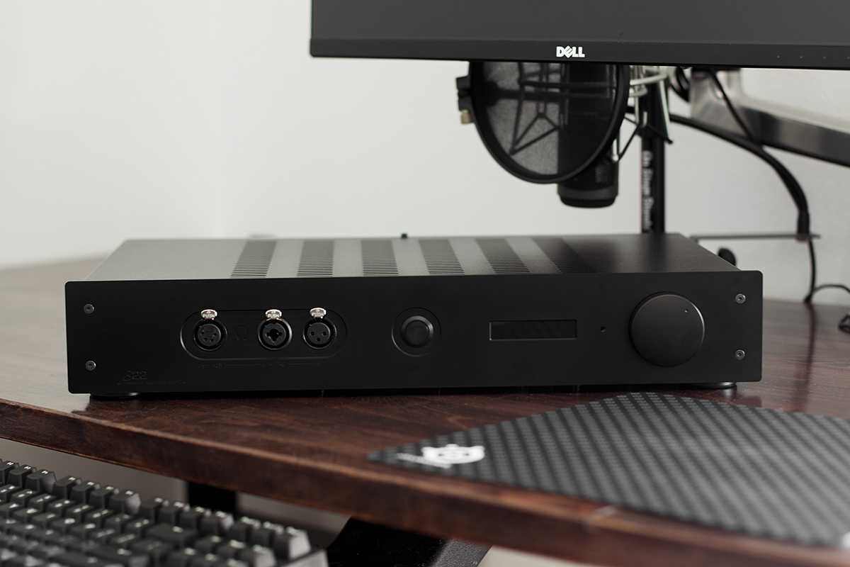

Durability is first and foremost a byproduct of how long the aluminum stays in the anodize tank. Second to this is minimizing angles on the piece, as the anodize is thinner around edges. Third is the material itself. You can make really tough Type II coatings, but I agree that Type III has the best abrasion/scratch resistance.
Cases like those seen from Tex or P0k3r are a simple Type II anodize, similar to the one seen on my amplifier above, usually with a pretreatment to bring back luster lost from the bead blast. Macbooks and iPhones also use a Type II in this fashion. Granted, I'm not discounting Type III, just making note that we use Type II anodize in our products daily with no ill effects. It's also important to note that a bead blast anodize without a bright dip pretreatment will give the keyboard chassis an AR lower receiver-style look, meaning more of a frosty gray than a true sheen, and will also show fingerprints more than other finishes. Bright dip pre-treatment brings back this luster. Think spray painting your car flat black (gray, dusty/frosty) versus a vinyl wrap or true semigloss satin.
I should also add that "clear" Type III hardcoat anodize will color the metal depending on the type of metal used. Source: http://www.midstal.com/sft334/aluminum_ ... _guide.pdf

Metal finishing is extremely tribal knowledge; unfortunately I don't have any pictures of these possible finishes offhand outside of my amplifier posted above. Everything I've learned has been through rigorous research in my own DIY projects and visiting several metal finishing shops in my area. It would definitely be beneficial to get in contact with a shop that has samples of each of these styles to see what works best for everyone!

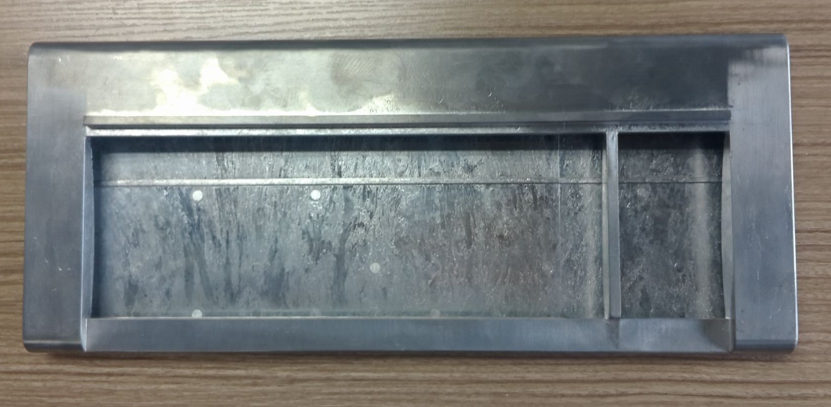

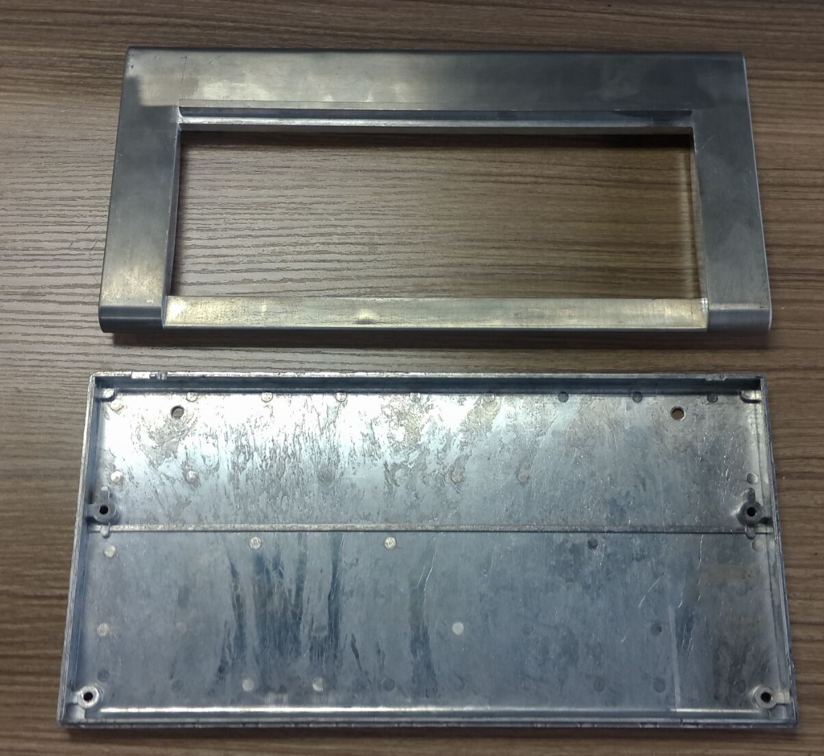

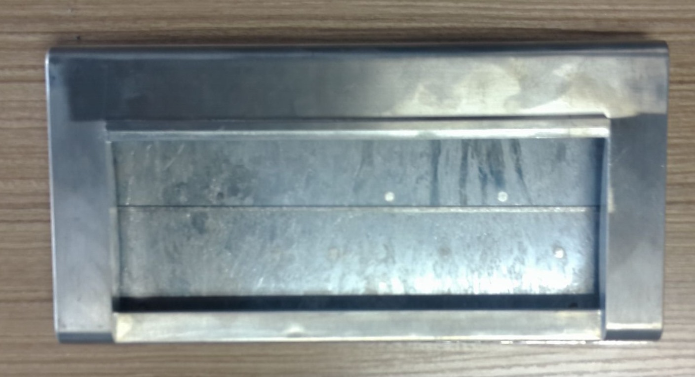

Ellipse

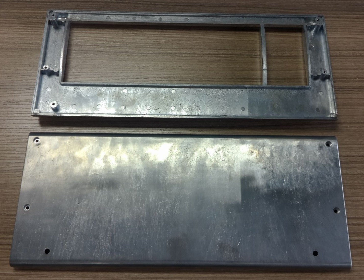

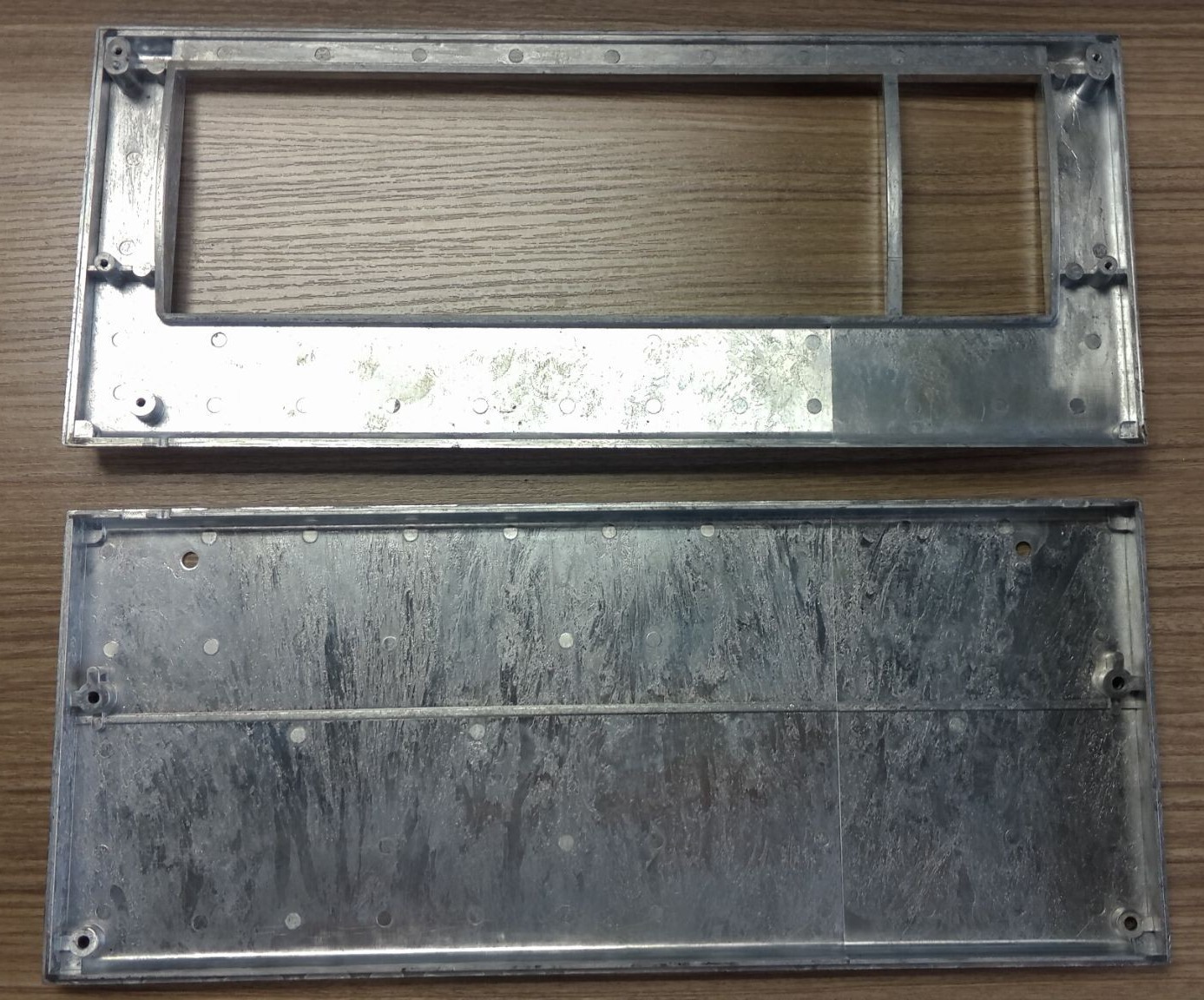

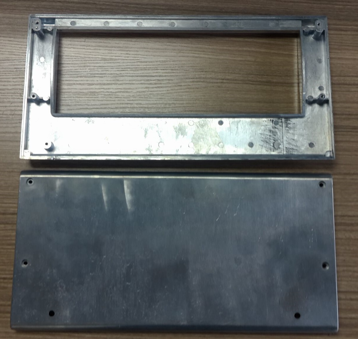

The very first die cast Model F keyboard cases to come out of the Brand New Model F metal molds, with no secondary finishing operations or powdercoating done yet:
The factory did a good job with these. My first few months working on this project last year, I didn't know that the die cast metal parts came out "rough" out of a mold, lines and marks and all, and then had to be fixed up.

Is that zinc or aluminium? Looks really cool!
Ellipse
czarek that is zinc. The prototypes as well as the ultra compact cases are aluminum. The original style cases will all be the super-solid zinc material (pictured) like the originals.
LewisR go for it! Everyone still has time to get in the early bird round.
strah the factory says they are using Zinc #3 (the most common high end zinc alloy for die casting). Some more info: https://www.dynacast.com/zamak-3

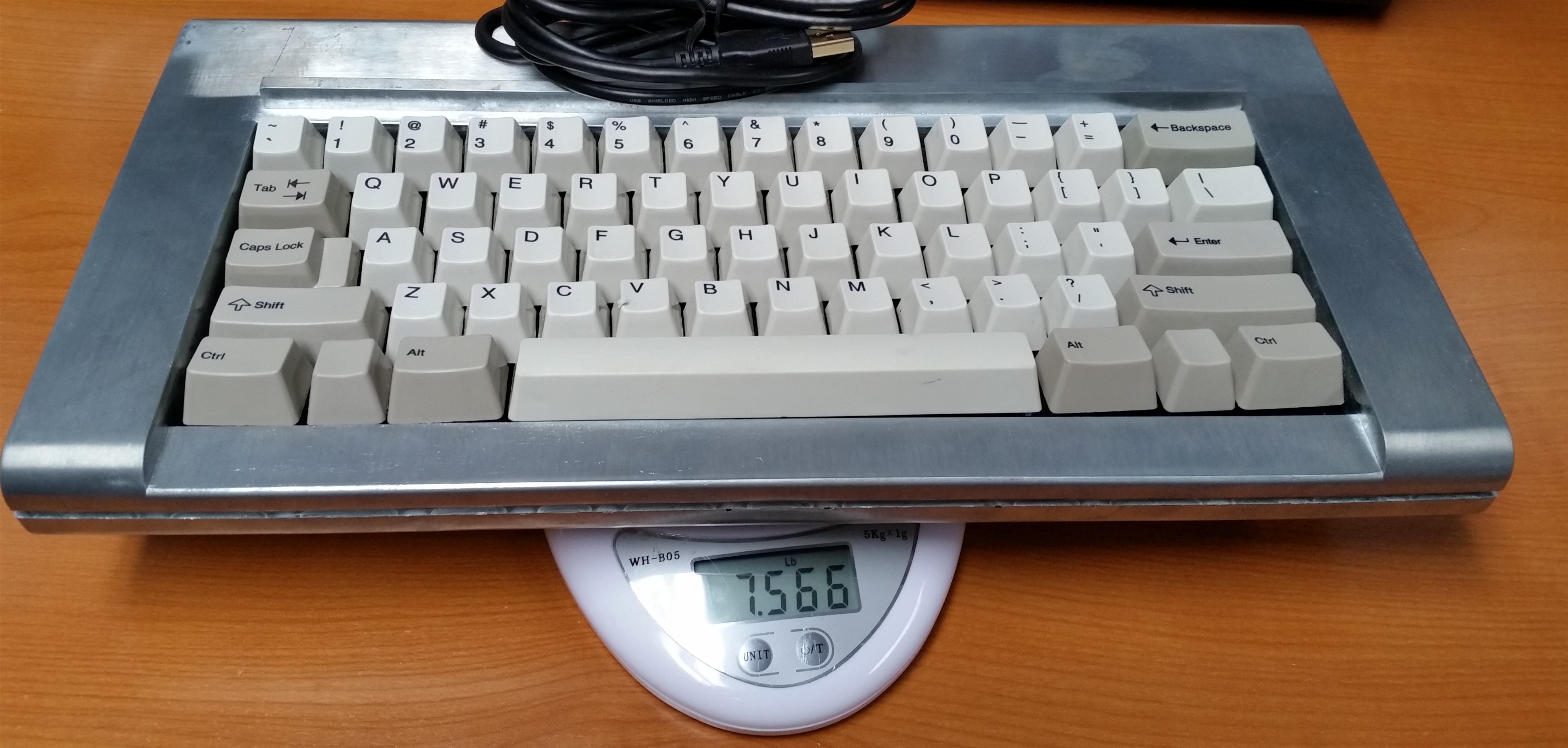

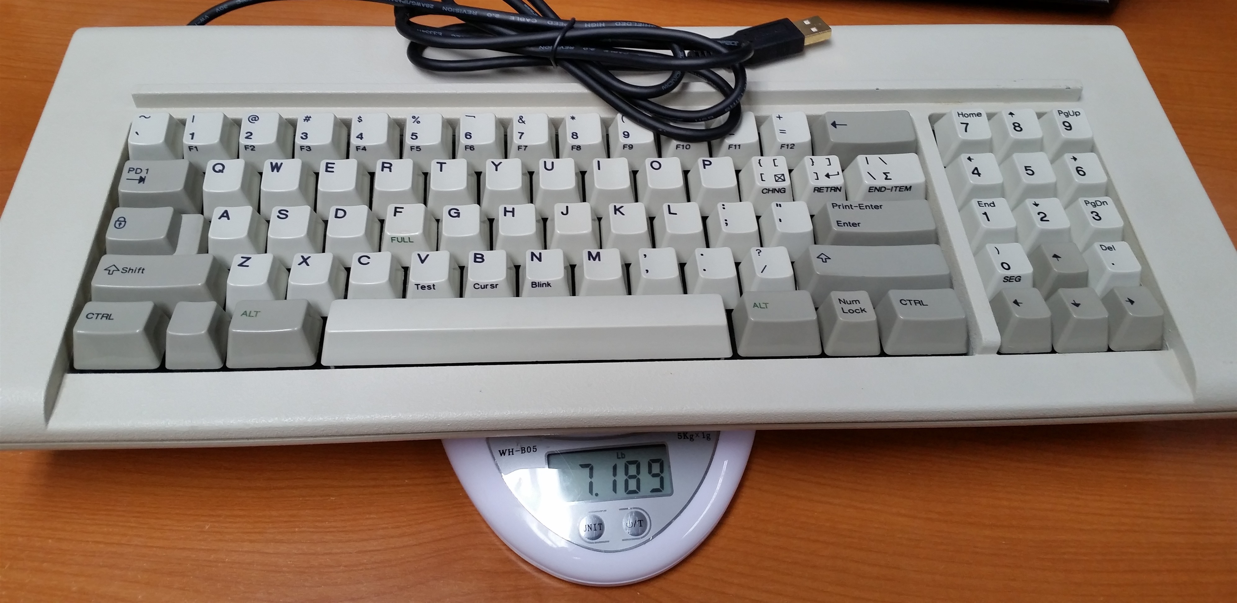

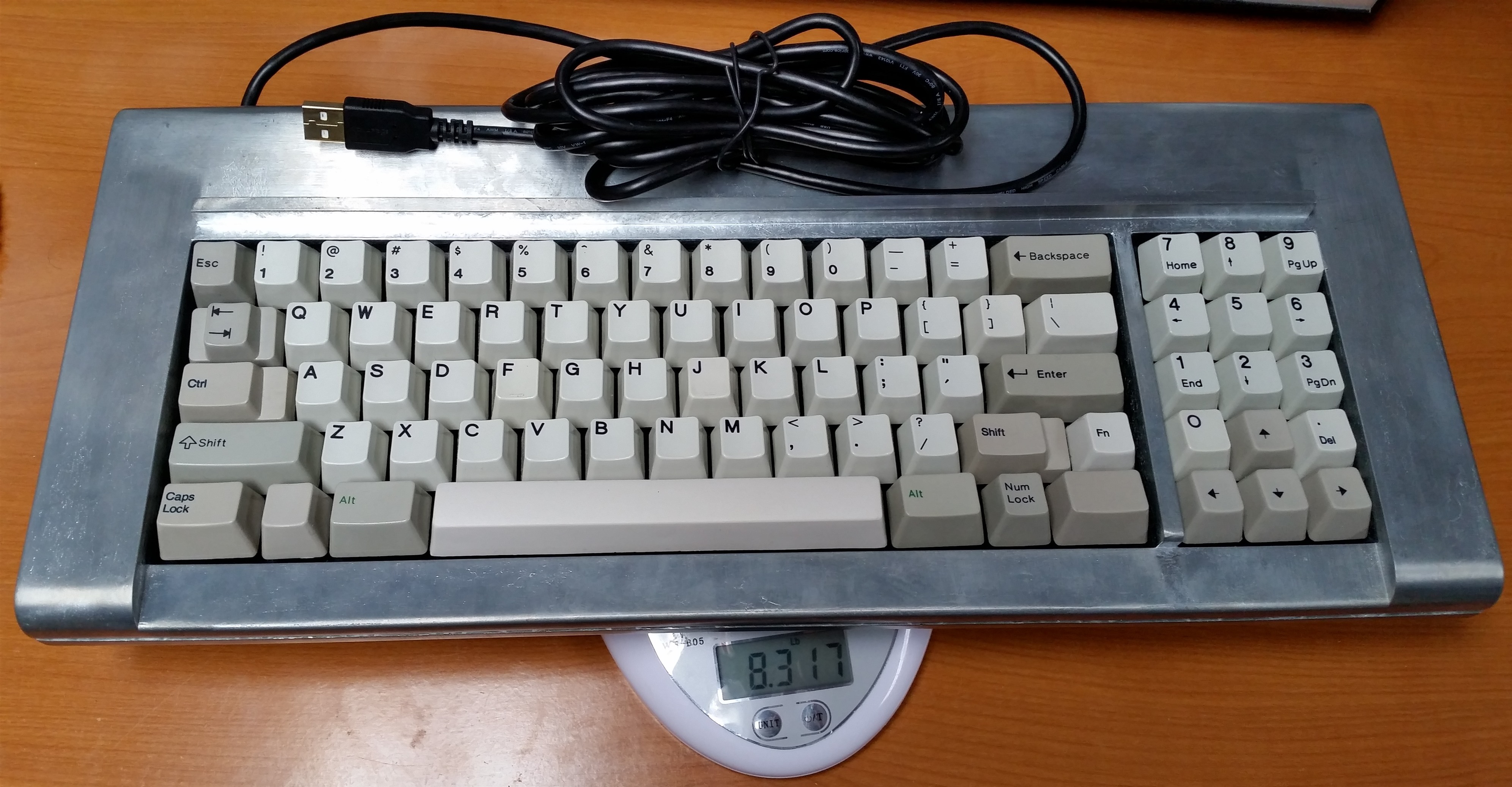

The very first die cast metal cases arrived today and they are great! These sample cases are even heavier than the originals! The F77 is about 1.2 pounds heavier than my original F77 and the F62 is about 0.9 lbs heavier than kishy's original F62 Kishsaver.
Kishy's original F62 weighing 3,025 grams: http://kishy.ca/?attachment_id=956

They really do look beautiful. Well done. For the weight differences, it makes you wonder the grade of Zamak they originally used. Have you tried weighing just the shells? It's possible the assembly plates might be as heavier gauge as well? Regardless... Excellent work

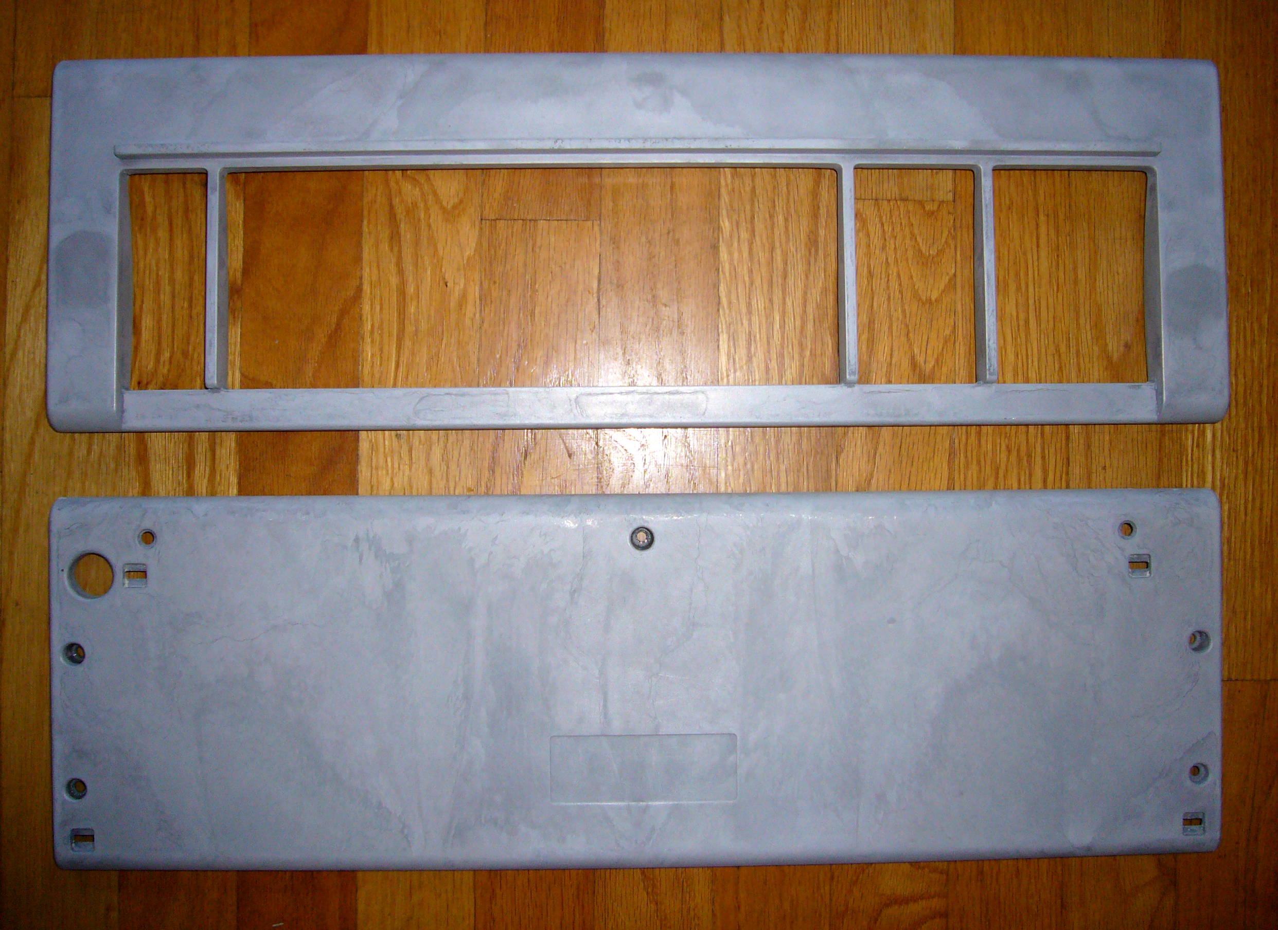

I don't have a 77 but I do have a 107 and the case is surprisingly light. When I had it shot blasted at the shop, the guys were rather insulting at its low quality and inconsistency. They said that was why there was so much streaking and spotting.
I thought that the back looked great, natural, but the spots/blotches on the sidebars of the front ruined the "natural" look.
My goal was to go natural but that just wasn't going to happen.
