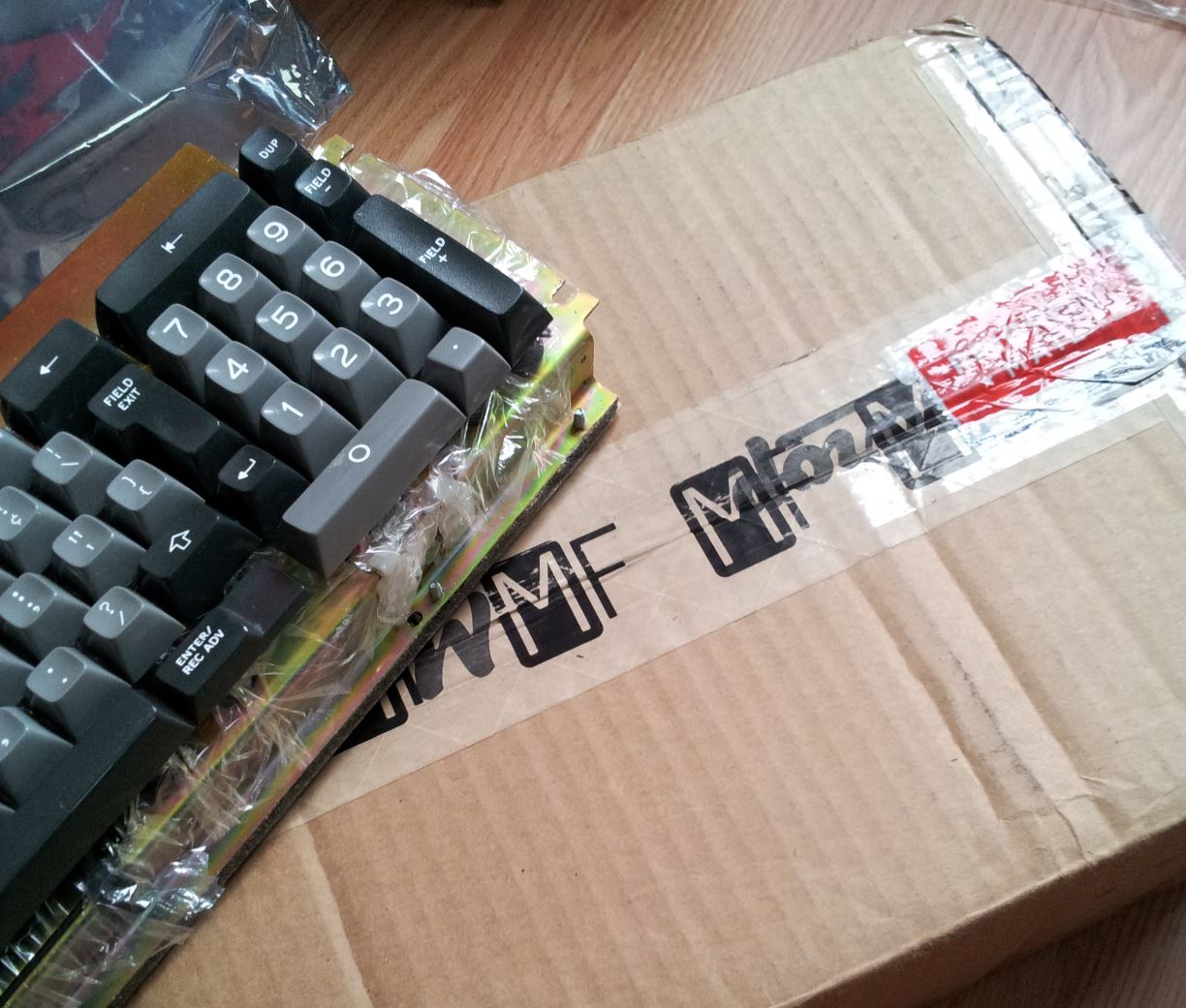

A package arrived to my door today.
- package.jpg (178.84 KiB) Viewed 7904 times
Looks like someone run out of plain packing tape
Now I'll let it sit for a couple of hours - it's not like condensate formed on it, but I'm not taking chances.
And then I'll bring it to the scope.

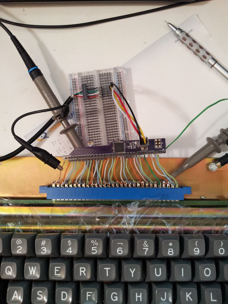

by DMA
Wingklip wrote: Wait you have beam springs? Please send me one I'll pay xd
Got one on loan from lot_lizard.
Looks this way now:
- IMG_20170318_231725.jpg (115.4 KiB) Viewed 7775 times
I'm afraid it's not for sale though.

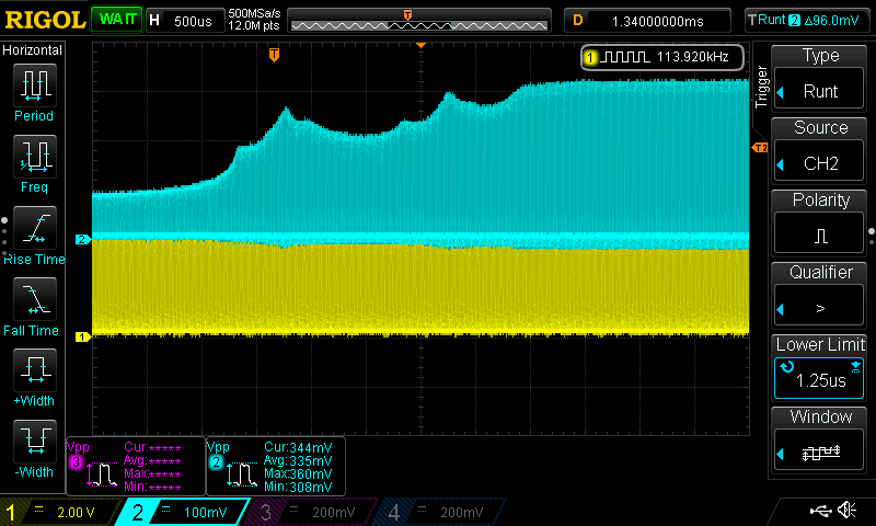

In other news - beamspring gives ~2 times stronger signal than F122, doesn't mind being driven by rows, scanrate 7.75kHz, and (surprise!) is bouncy on the way up: if you lift your finger too quickly, you have a chance to get this:
- DS1Z_QuickPrint32.png (69.7 KiB) Viewed 7775 times
I.e. hurray, unified capsense hardware is possible and lies at my table.

Posted: 19 Mar 2017, 13:07
by lot_lizard
DMA wrote: I.e. hurray, unified capsense hardware is possible and lies at my table
Glad it arrived safely, and glad the experiments are turning out in our favor. It looks like bluetooth in a beamspring is off the table though
, unless we are going to stick a car battery inside (good thing there is room).
EDIT: This is the first time I have seen Capsense against something I can really register the scale on in my brain. Its VERY small. It should be with such few components, but your pic really helped to see it. So many possibilities...

Posted: 19 Mar 2017, 19:34
by DMA
lot_lizard wrote: It looks like bluetooth in a beamspring is off the table though
Scanner itself has surprisingly modest power requirements. Probably the fact that it's almost completely in hardware helps. Whole system draws around 25mA - and 18 of those are supposed to be eaten by CPU. Note that there's not a single sleep instruction in the code yet, and USB transceiver itself is pretty hungry - so this can definitely be brought down significantly. I'll try a bit later, when I get to suspend-resume.
Has to be two-chip system though - no psoc5 with BT, and psoc4 BLE only has 8 fixed ADC input pins, which is not enough.
But RGB LEDs on the same PCB are probably out of consideration still. I keep reading those are quite noisy neighbors.
lot_lizard wrote: This is the first time I have seen Capsense against something I can really register the scale on in my brain. Its VERY small. It should be with such few components, but your pic really helped to see it. So many possibilities...
Should I rename it to "capsense"? A bit too close to "capsize" though
Can be smaller even. The chip is 8x8mm. There's WLCSP version which is 6x6mm - but I don't feel comfortable with solder balls and being BGA it will probably require four layers anyway. But, as you can see, connector occupies good quarter of the real estate - so if integrated into sense card it will require about 10x18mm or something. Also caps and resistors can easily be 0402 which should get it under 10x15mm comfortably.
