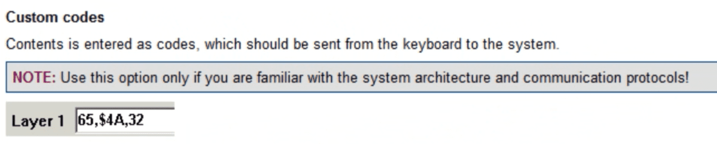

I hope you don't mind me bringing this thread back to life. I've got a Tipro TM-KMX-128A and I am having a difficult time understanding how to program custom codes. My goal is to implement as many unique individual keys as possible onto the board.
For a clear demonstration of my issue, I will use an example which has already been demonstrated to work earlier in the thread. Following that guidance, this is what I am doing (also see attached screenshot):
Changed interface to "custom codes"
Entered $1F,$F0,$1F into Layer1
Updated keyboard.
But now pressing that key returns no keystroke, where F13 would be expected.
I can confirm setting other non-custom keys works fine. I feel like I must just be missing something here and would love a bit of advice if anyone has a spare moment to get me on the right track?
Thanks, Nathan :)

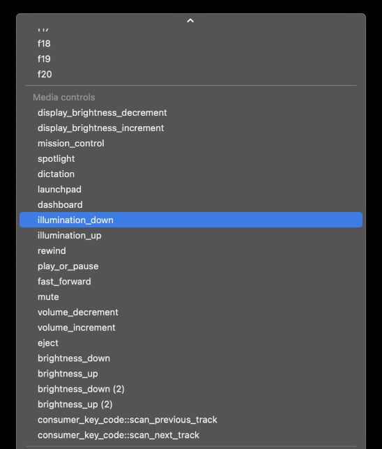

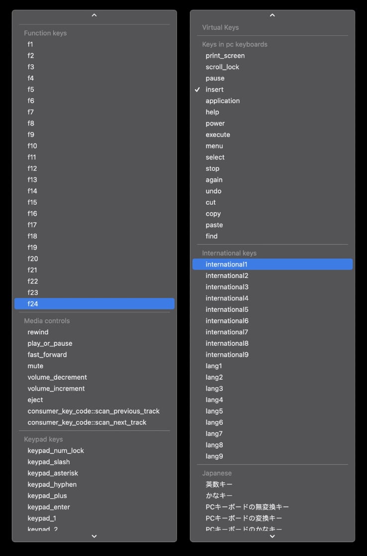

Floating.Point wrote: 24 Sep 2021, 09:51 Sadly there's not quite enough unique key strokes supported on MacOS for all 128 keys
Aren't there? Karabiner can map from and to quite a few. The pulldown menu's much too long for a screenshot, so here's just a couple of promising bits:
Karabiner keys pulldown menu.jpg (49.1 KiB) Viewed 8131 times
If it's in the USB HID keyboard standard, I bet Karabiner can handle it.
Additionally, Karabiner can also handle most all those fiddly keys that aren't in spec, like the Mac's own Fn key—now available by pressing Insert on my mechs—and the non-standard media keys for controlling keyboard backlight brightness and such. The only one I know Karabiner doesn't support yet—and not for want of trying!—is Apple's own Do Not Disturb key (the crescent moon on the MacBook Air's F6). All the rest are right here:
Screenshot 2021-09-24 at 10.43.14 am.jpg (21.88 KiB) Viewed 8131 times
I work around that missing key by remapping the function to F6, anyway. Because Karabiner also works on my laptop's built in keyboard, everything can be seamless.
