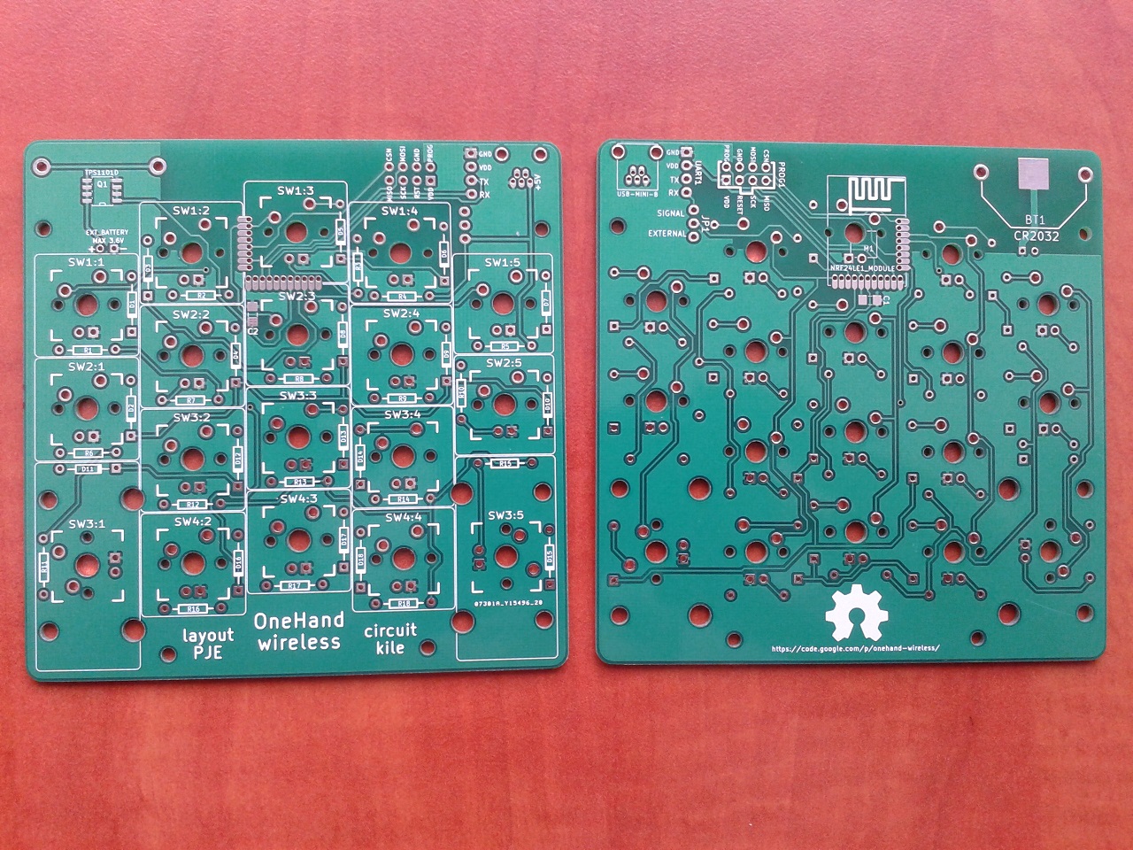

Look what Santa just brought!
- onehand wireless PCBs
- oh_pcb.jpg (543.88 KiB) Viewed 8178 times
I didn't expect these for another 10 days at least. By a stroke of luck, the family is out of town for the weekend, so I will have two whole days to play with my precious creation.
I pledged for one of these
https://www.kickstarter.com/projects/ee ... nt-adapter and I'm still waiting for it - it should arrive any day now. That thing will help a lot with tweaking the current consumption and prolonging battery life.

kile wrote:Look what Santa just brought!
Looking good!
I'm excited to see how the wireless system works out. I decided against wireless, and LEDs for V2 of my design. I'm thinking of a V3 with embedded CPU as it would give me an excuse to buy a reflow oven

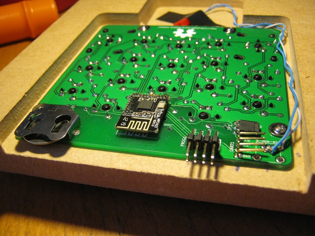

And it's working!
I made "only" one mistake on the PCB design - I reversed the LED USB plug. It should actually be soldered to the top of the PCB to work properly, but I wanted it on the bottom. No biggie, since I only use the LEDs for laughs anyway. I soldered a JST connector to power the LEDs from an external battery just to see what it looks like with all the LEDs on.
So, everything works - the matrix, the UART debug output and the most important thing - the radio. But, nothing works as it should
I am not putting the MCU into sleep mode at all yet, so it draws a lot of power. Which is why I didn't solder the CR2032 battery connector yet. I am powering the circuit from the programmer connector and reading the matrix in an infinite loop, just like you would on a wired keyboard. I'll work on this during the weekend.
Most of the caps are leftovers from the max keyboards translucent set I bought for my beloved 7G. The rest I took from my old 6Gs. I'll probably get a full blank set for this board from WASD or some other place. Any suggestions?
If anyone likes adventure, I can send PCBs and help people with the assembly and programming. You will need a dedicated MCU programmer, though, because these chips do not have bootloaders which is probably their biggest drawback.

Ok, the starter kit (prices in EUR):
nRFBurn programmer (special DT community price) 11.00
OneHand Wireless PCB 3.00
LED powering USB connector 1.00
transistor, capacitors, CR2032 holder, 0.05" pin headers, diodes 2.00
controller programming cable with reverse-proof connector 2.00
small USB dongle programming cable-from-hell (optional - see below) 15.00
nRF24LE1 controller (only if you want me to solder it too) 5.00
soldering: the controller, transistor, capacitors,
one switch (SW1:3) with the LED socket, battery holder,
programming connector, USB LED connector and diodes.
You need to solder the switches, LEDs and current limiting resistor 10.00
fully assembled and tested unit TBA
The reverse-proof programming connector is only reverse-proof on the controller side, and the programmer side has a sticker with names of the pins which helps plugging it in correctly. I will post pictures of these in a few days because I don't have these connectors yet.
You will also need the controller module (nRF24LE1), and a USB dongle (nRF24LU1+), and you can get these on ebay. I don't want to include these because I don't have enough of them and you can't really save in shipping. I have three extra nRF24LE1 controllers which I can sell but only if you want me to solder it in too.
Controller:
http://www.ebay.com/itm/NRF24LE1-NRF24L ... fresh=true
The USB dongle comes in three variants. The first one is the cheapest ($10 shipped) and smallest (
link). But there's a catch - it needs a programming cable which is a total bitch to make. To make it properly, you would need a crimping tool which I don't have and they are ridiculously expensive. So I have to improvise - I made these with some small pliers. I timed myself last night and it took an hour of frustration, swearing and sweating. Assembling the programmer takes less time and is a walk in the park compared to this. Which is why it costs as much as it does. The parts for the this cable are cheap (less than 1 EUR) and I will send them if you want to try your luck and assemble it yourself. But I don't recommend that.
The second dongle option is $20 shipped (
link), it's larger and has a tiny red LED on it which the firmware running on the dongle can use. Currently my firmware makes the LED blink when it receives data from the controller. It does not need a programming cable because it can be plugged directly into the programmer if you solder a header on it. The header will be included in the package.
Size comparison:
Dongle 2 with the programmer and the cable from hell:
Dongle 2 plugged in:
The third option is sold by SparkFun
here. It's $36 + shipping and you need a 2.4GHz duck antenna for it as well which is not included. It can also be directly plugged into the programmer. This is the best option if you want to develop firmware. It has two extra pins which are brought out to the connector and further connected to two LEDs on the programmer, so you can turn them on or off from the dongle. Very useful for debugging! These are marked DBG1 and DBG2 on the connectors and the programmer PCB.
SparkFun dongle:
I can also do soldering and testing, but that will cost extra, say 10 EUR. I would solder the programming connector, capacitors, the transistor, battery holder, the controller and one switch. That one switch is necessary because the controller covers the SW1:3 switch, so I have to solder the switch and then the controller. I will put a LED socket inside the switch so that you can plug whichever 3mm led you want.
I can also order switches from 7bit and assemble and test everything (LEDs and the resistors too), but I have to figure out how much that would cost.
Of course, I will only start accepting orders once the controller firmware works properly.
I hope I didn't forget something....

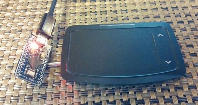

I've been playing with my V2 layout, and have come to the conclusion that it's good enough! The PCB allows a ProMicro to be mounted on the rear in the same way as before, but a second PCB without the CPU can be linked for a TwoHand layout. Also I've included two I2C connectors to allow daisy chaining of the boards with CPUs, and finally I've added the PS/2 interface, which uses the serial TX/RX pins for added flexibility.
Before I pulled the trigger on the PCBs I did a basic test on the PS/2 touchpad interface, using a cheap ($3) surplus Synaptics touchpad from a laptop wired to the TX, RX, 5V & 0V pins of the $5 ProMicro.
- PS2_Touchpad.jpg (69.3 KiB) Viewed 7971 times
I've used the various PS/2 Arduino resources on the web to write an interrupt driven touchpad interface. It generates x and y positions as well as the virtual button press signals from the PS/2 stream. Using the interrupt driver for the receive should allow it to run in the background without interfering with the keyboard scanning too much. I now have to decide how I'm going to use the pad - mouse replacement, or cursor control... For some reason the side scroll bar is not working - probably a configuration issue, but I'll keep working on it!
Now that I'm reasonably happy with the next iteration I'll probably be ordering the PCBs this week.

Rather smart. But you're going to want to so something about those loose wires, Mr. 2.4 GHz!

Muirium wrote:Rather smart. But you're going to want to so something about those loose wires, Mr. 2.4 GHz!
Yeah, I know. A wireless keyboard with wires sticking out of it

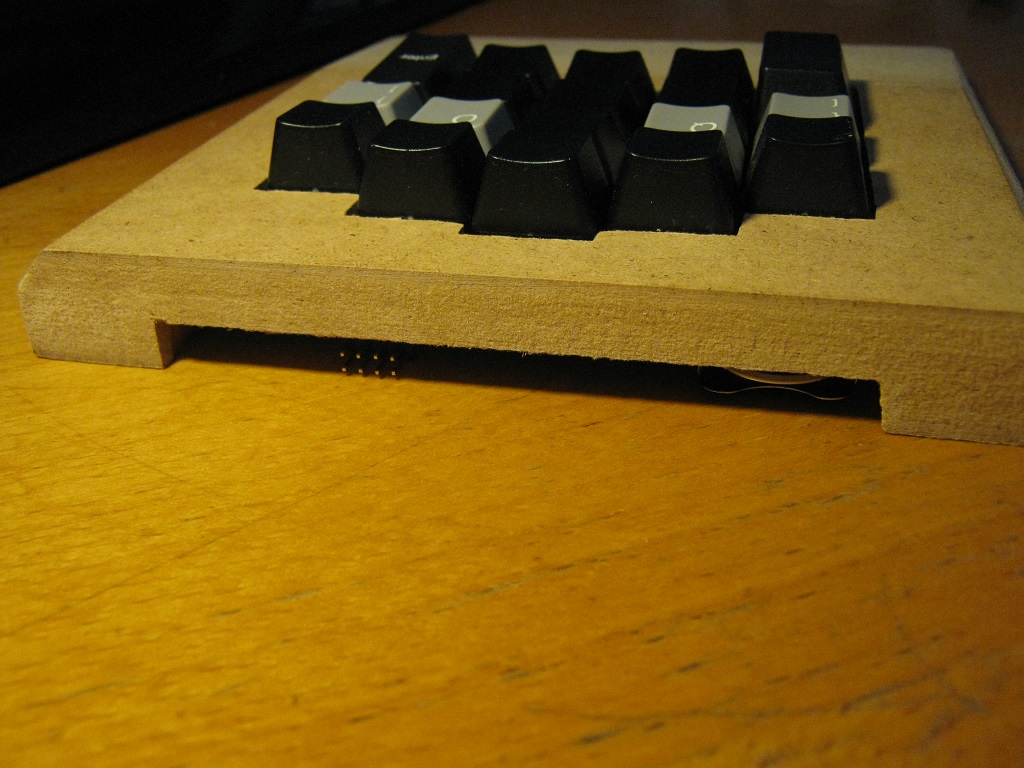

Anyway:
- look ma, no wires!
- IMG_2357.jpg (236.98 KiB) Viewed 7821 times
- look ma, no wires! (part II)
- IMG_2359.jpg (308.99 KiB) Viewed 7821 times
Happy now?
The white/blue wire will have to stay. That's the LED power cable, and I don't want to remove it yet.
And the serial debug connection has been replaced with a pin header, so I can now plug it in/out as required.
