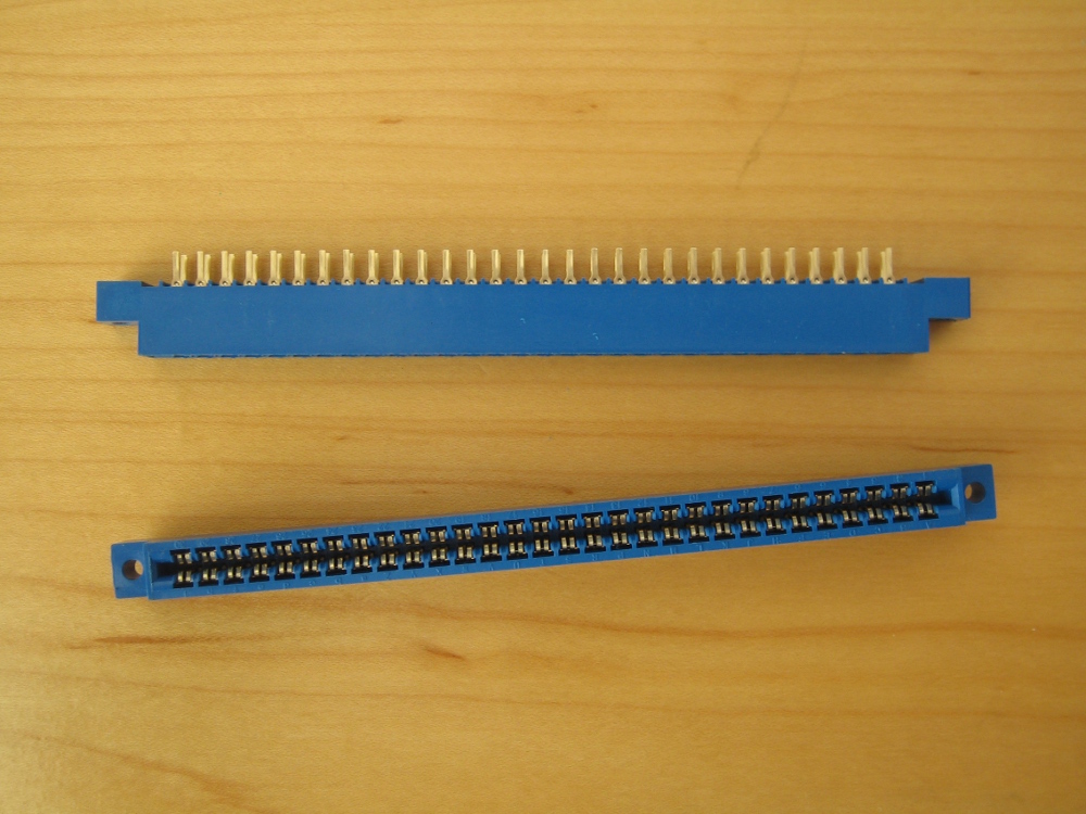

ok, ordered the weird connectors and will order PCB's and parts tonight for a rev03 board. I am ordering everything to make three, so I can ruin one and still have a spare one if all goes well...

and hmm, the connectors arrived too, but it turns out that I ordered not 3 of those, but 30 !
so I have a bunch (27, to be precise) of spare connectors here in Amsterdam, and I am happy to send them to anyone who needs some if you pay shipping (which should be just a few euro's inside of Europe).

1x 3.96mm pitch 2x30p edge connector, such as: http://www.ebay.com.au/itm/140887820225
(and of which plenty are available in Amsterdam too :roll: )
BTW: nice job with the connectors! I got 10 but only because they were cheaper that way... 30 is a good effort!
