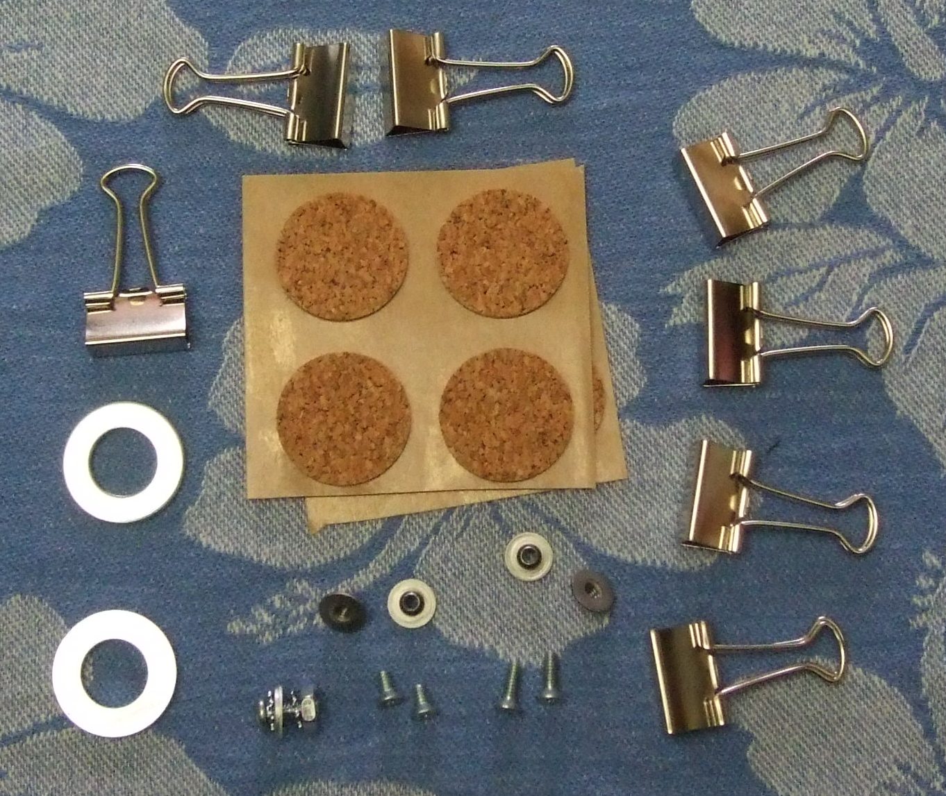

I have finally gotten around to boxing stuff up for the folks who have volunteered to put one of these together. These first kits include a PCB, neoprene pad (not cut, hope you don't mind cutting your own), 6 silver binder clips, 4 new 1" round cork feet, 2 barrel washers (for the space bar), #6-32 machine screw/nut/washers (to attach the controller), and 4 #4-40 machine screws and weld nuts (for securing PCB and plates). Not included (but needed) would be two extra XT barrels and a new top plate.
I searched my PMs to find the folks i promised these to get this list ...

I'd like to talk about the reason for some of the part choices I made.
The original PCB with integrated controller was connected to the back plate with two studs (to hold alignment) and a binding screw (for grounding). The new switch matrix PCB has a separate controller, so that one binding screw needs to provide good mechanical connection for both. The PCB is so near the top of the case that the original controller had all components mounted on the bottom of the PCB, so it seamed logical to me to put the controller under the switch PCB. The back plate has a captive nut embedded in it, so there is a lip around the screw hole on the bottom of the back plate. If something is not used to level out that lip, then the controller would be caught by it and both controller and switch PCB would not slide on/off without un-soldering. I chose to use an Arrow WA3/16 rivet washer for this because ...
  • the hole diameter is large enough to fit around the captive nut
    the outer diameter is small enough to not block the connecting wires
    the thickness is slightly greater than the height of the captive nut
    they are cheap - only $2 for 30 at my local Lowes hardware store
The two studs that hold the original PCBs alignment are not where they need to be for the new switch PCB. I thought about using pop rivets, but not a lot of keyboard folks have a pop rivet tool. I also considered standard bolt/washer/nut, but there is not a lot of clearance between the PCB and barrel frame nor back plate and case bottom. I searched the McMaster Carr web site and found #4-40 weld nuts. When used upside down, these create a 1/8" stand-off with just 1/32" thick cap. I use two of these to hold the alignment of the barrel frame also. These are reasonably priced too at $6.33 per 100.

The last 3 kits hit the mail today. The folks that I sent parts out to, you are free to go as far off script as you like, but today I'd like to tell you how I put mine together.
Start by ordering a barrel frame - sorry about not including one in the kit. Take an IBM XT keyboard and remove the two screws and pull off the case bottom. Remove the key assembly and set the case aside. Remove the cable from the controller. Remove the rubber grommet from the old cable. I got mine off by splitting the grommet with a razor along one of the seams as deep as the wire (half way through) and then pealed the cable out. Looking at the back of the key assembly with the key caps on a table top and the controller up, bend the top right tab up and slide the back plate to the right relative to the barrel frame. Be careful not to loose any buckling springs as the assembly opens up. Remove the buckling springs, barrels, and key caps from the barrel frame and foam. Remove the PCB from the back plate. Clean the case, back plate, grommet, barrels, and buckling springs - these were reused.
The two rivets on the back plate are not where they need to be. I removed them using a rotary tool with a cut wheel - cut away the flange on the back of the plate then popped the tops off. The new PCB has one hole for a new stud between the Caps Lock and A and another hole between right bracket and pipe-backslash. The second of these two holes is not in the best location and I plan to move it between Enter and up arrow. You might make a new hole in the PCB there and use that. I used two clamps to hold the PCB to the back plate to mark the location to drill new holes. Aligned properly, you should see two white silkscreen dots through the old rivet holes on the back of the back plate. Mark the back plate through the new holes and drill with a 1/8" bit. Secure the PCB with two #4-40 x 1/4" flat head machines screw (plate side) and weld nuts (PCB side), and #6-32 x 3/8" bolt with a star washer on the PCB side. With the back plate facing up, put the rivet washer over the #6 bolt and around the captive nut. Put on the controller, star washer and then nut. Feed wire through controller and switch PCBs and solder on both sides. Columns 13 thru 16 go to ground on the switch matrix PCB, so no wires there if using xwhatsit controller (it might confuse the controller) but wires there should be OK for DPH controller (designed to auto-skip grounded columns).
The back plate and new barrel frame can be attached so tightly that the foam pad is probably not required. I did use a thin pad; that went on first. Insert barrels in the frame (you will need two more than what came with the XT), buckling springs, and plastic inserts in the barrels where they need to go. Secure the barrel frame to the back plate with two #4-40 x 3/8" flat head machine screw (back plate side) and weld nut (barrel frame side). Use the binder clips to clamp along the top and bottom of the switch assembly. Check the fit into the case top cover as the clips might need to move left or right. Remove the clip handles, put stabilizer-hold-down washers on the C and < barrels, and put on the key caps.Test fit the new USB cable and super glue the grommet onto the new cable. Put new birth certificate on the back plate (optionally, initial and date by hand). Put the case bottom on and screw it down.
