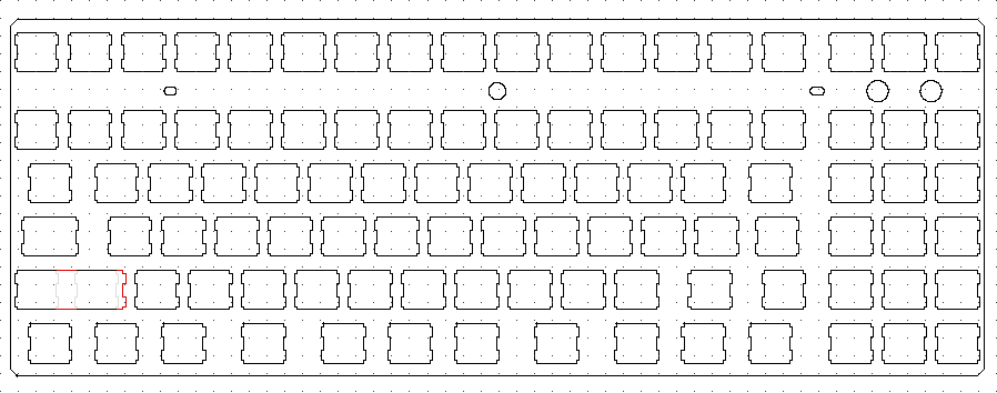

DXF files of all 5 plates are in this zip file.

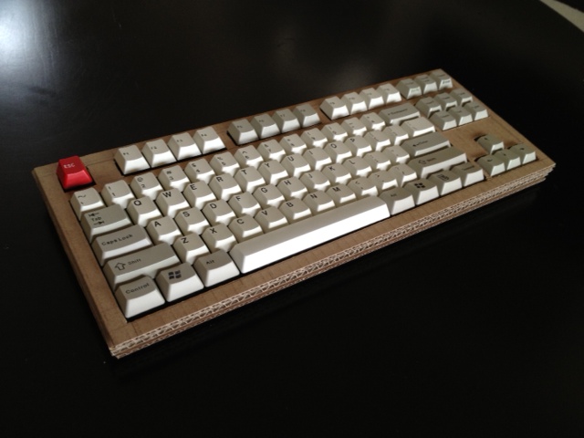

Would anyone use a case made out of cardboard? ;)

^ lol
And think if you spill coffee on it.

Are those Cheetos stain i see on the right side of the casing :lol:

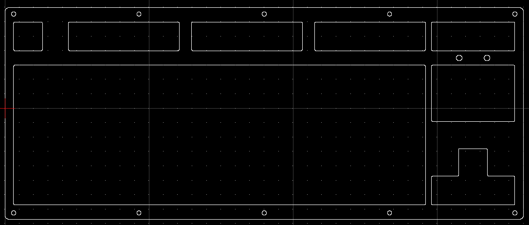

Now I have it in QCAD.
Top layer:
Phantom Case Layer 1 Top.png (19.29 KiB) Viewed 11452 times

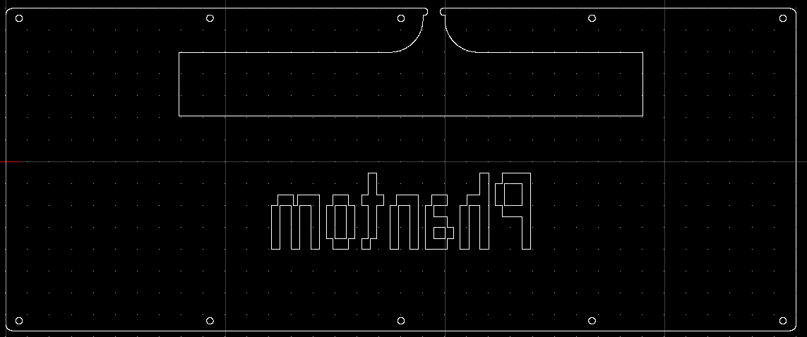

For Filco Tenkeyless, this layer needs to be thicker to raise the top layer higher because of Filco's controller. This layer can be thinner for Phantom since its controller is under the PCB:
Phantom Case Layer 2 Mid.png (16.42 KiB) Viewed 11452 times

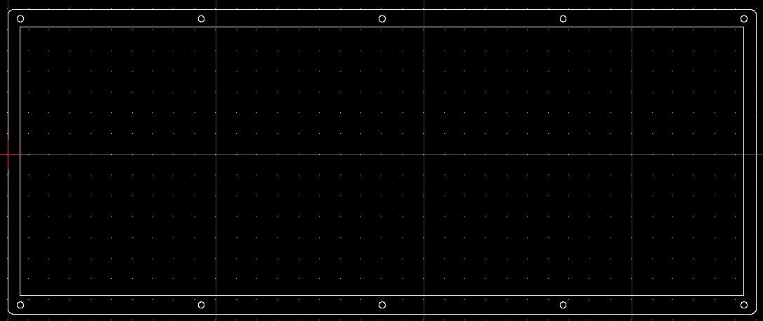

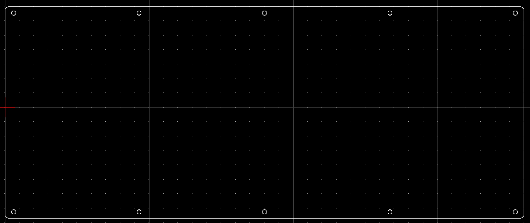

Cut out for Phantom's controller on the left, Filco's 5-pin plug on the right, plus cable routing. I need to know how much the Teensy controller stick out from the keyboard PCB because I can tell how thick this layer need to me.
Phantom Case Layer 3 Mid.png (20.09 KiB) Viewed 11452 times
The bottom layer:
Phantom Case Layer 4 Bottom.png (15.81 KiB) Viewed 11452 times

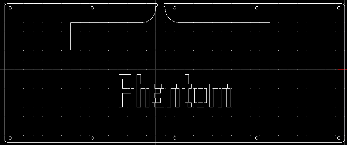

If it is made with transparent acrylic and you look at it through the bottom layout, it would like like this:
Phantom Case Layer 3 Mid - Flipped.png (11.76 KiB) Viewed 11452 times
Hum, I think I need to add a screw hole...
EDIT: Added another screw hole, and now a 7bit top layer.
Phantom Case Layer 1 Top 7bit.png (10.25 KiB) Viewed 11443 times

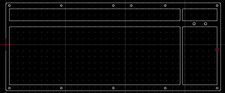

We could need one version of the top layer more:
All plates have the holes for the five additional keys above the arrow keys, but
- the standart top layer does not support these keys
- the 7bit top layer does support them, but the Fx-row is not devided
So we would need a version with devided Fx-row and full block above the arrows!
litster
29 Nov 2011, 18:00
Tarkoon, drawing that layer is a 2 minute job. That's easy. Adding another item to the parts list is more problematic. If the first prototype case turns out OK, we will see what we can do next.

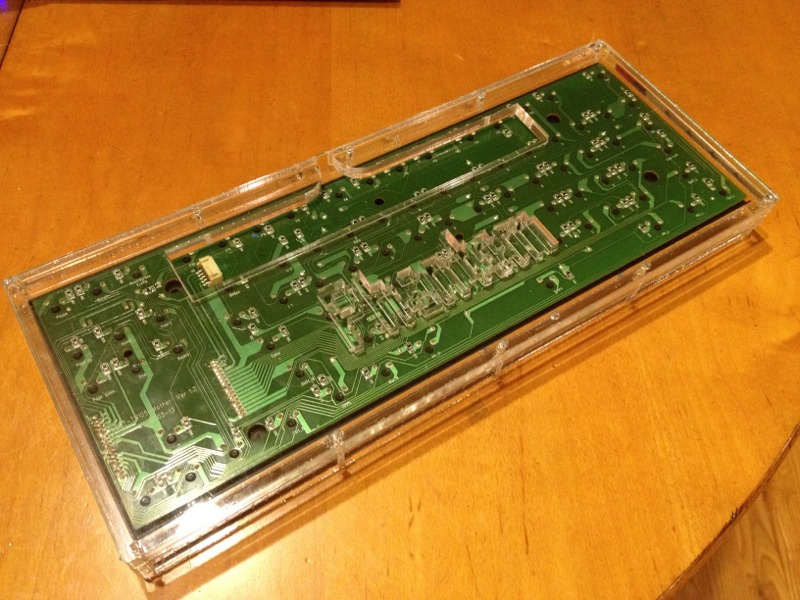

Meet the Phantom... case.
Need to eat dinner. More pictures later.

I got lucky and found a way to get access to a laser cutter tonight. But I can't mass produce because I don't have access to the laser cutter at will. I need to refine the drawing to make it fit better. But right now it is very close to my expectation. One thing I won't do in the future is to cut the "Phantom" word on the 3rd layer because that took a LOOOOONG time to cut. Speed had to be slowed down because that piece is so thick. Engraving maybe a possibility.
Then we can find a shop to cut it. It will be over $200 though unless we find some shop that is cheaper.

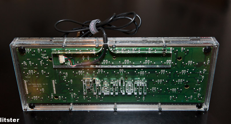

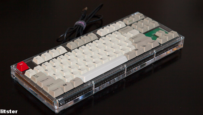

A couple more pictures:
Phantom Acrylic Case-1.jpg (100.94 KiB) Viewed 11327 times
Phantom Acrylic Case-2.jpg (139.12 KiB) Viewed 11327 times
Thing I need to do or think about:
- 2nd layer needs to be a tad thicker for Filco. Not a problem with the actual Phantom.
- lower screws count from 11 to 8, don't really need that many screws.
- right now the PCB is sitting on the bottom later. A better way to do this is to glue a few acrylic posts to support the plate instead. Need to engrave the post positions. Notices the PCB has already scratched the bottom layer. If we do this, the 3rd layer needs to be thicker.
- need to move the cable cut out to center. I underestimated how long the cable is.
- the second layer needs to be a tad wider and longer than it is now. maybe 0.5mm. Right now it is a super tight fit. Need final plate and PCB to determined final size.
- Need to back legs. Currently it is too flat.
- The top layer is OK, but I can move some key holes a little bit to center the holes to keycaps. Need to way for the final plate cut to determine final key hole locations.
Round out the inside corners for the 3rd layer.
- I need better screws. Please, any suggestions for better screws? these from Lowe's sucks. They are too long and I had to Dremel them.
- I got my Teensy today. The 3rd layer's thickness is perfect.
- should we make the case both Phantom and Filco compatible?
- as much as I have cut out, the case is HEAVY! Is that good?
- the Phantom wording took a long time to cut, especially because that layer is so thick, the laser need to run slower to cut it. It barely cut through. For the final version, I don't think the word Phantom will be cut. Maybe engraved.
