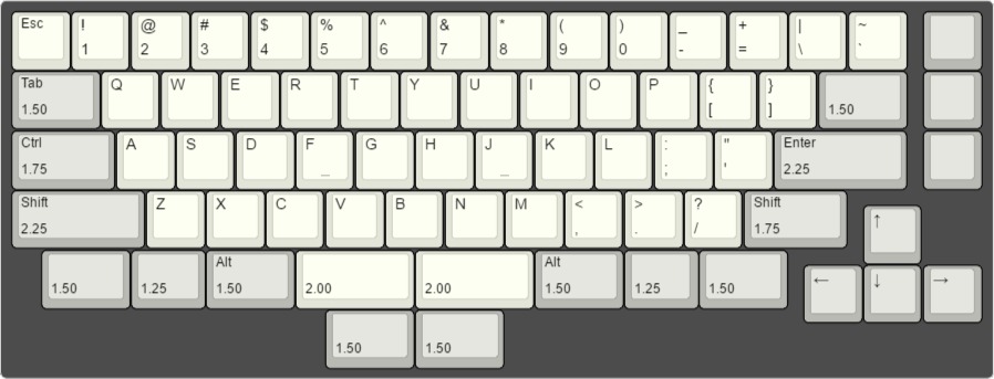

A little bit late to the party, but I've been messing around with keyboard layout editor and ended up with this:
Edit: should be fixed now ;)
Posted: 28 Jul 2016, 13:32
by Chyros
That image doesn't load Oo .
Posted: 28 Jul 2016, 13:43
by Wodan
Chyros wrote: That image doesn't load Oo .
Happens a lot when people use the IMG tag and just paste in the Imgur page url instead of getting the actual image url.
Just quote the person and in the quote of the original message you will see the Imgur url and can look at the picture.

matchison wrote: A little bit late to the party, but I've been messing around with keyboard layout editor and ended up with this:
Why would you want a block nav? Oo
Posted: 29 Jul 2016, 15:50
by Wodan
I love the reverse-split-left-shift making space for ... CAPS LOCK
WHO NEEDS CAPSLOCK?

by emdude
No kidding, looks really old-fashioned. Better yet, how about having it laid out in a single row à la vintage Apple boards? :roll:
The inverse-T nav cluster was one of the most clever layout design innovations, IMO.
