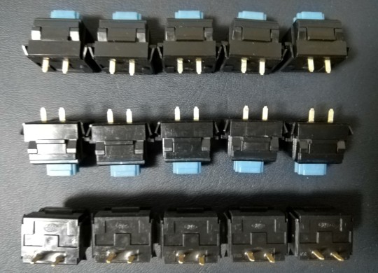

Anyway..., I recently got these.
NOS!!
Lynx_Carpathica
21 Mar 2017, 17:19
arkanoid wrote: Anyway..., I recently got these.
NOS!!
