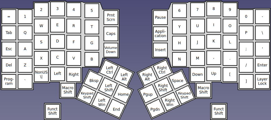

21 Dec 2016, 11:16
Yes, I agree that layers get confusing when their number goes up. V0.7 has only 2 layers (the normal which is on every keyboard) and the keypad layer (primary reason is numpad almost like on the standard 104 key keyboards and the function keys F1-F12). V0.8 will have one more layer (together 3 layers). I'll call it function layer where there will be function keys F1-F12 always with one modifier(*). I could add another layer (together 4) since I'm adding two buttons on each side. So there would be a comfortable layer shift for it on each side. But I do not know what I would put on it ... so it is probable I will not add it. Maybe people who want separate Mod key on linux can use it. It will probably stay only as an alias for some other layer shift.
(*) So e.g. the keys on the right side at position with numeric keys 6, 7, 8, 9, 0 and below will be something like
Win-F6  Win-7   Win-8   Win-9   Win-10
Shft-F6 Shft-F7 Shft-F8 Shft-F9 Shft-F10
Ctrl-F6 Ctrl-F7 Ctrl-F8 Ctrl-F9 Ctrl-F10
Alt-F6  Alt-F7  Alt-F8  Alt-F9  Alt F10
To tell the truth I do not have much use for function keys with modifiers. I use function keys quite a bit but hardly ever with additional modifiers. So this is almost only a theoretical experiment for me. I'm curious whether I'll like the new palm button ... or whether I remove it on my version. Support in firmware and hardware will stay there but I may disconnect it and use only a plain brick (without the button) for a palm rest.

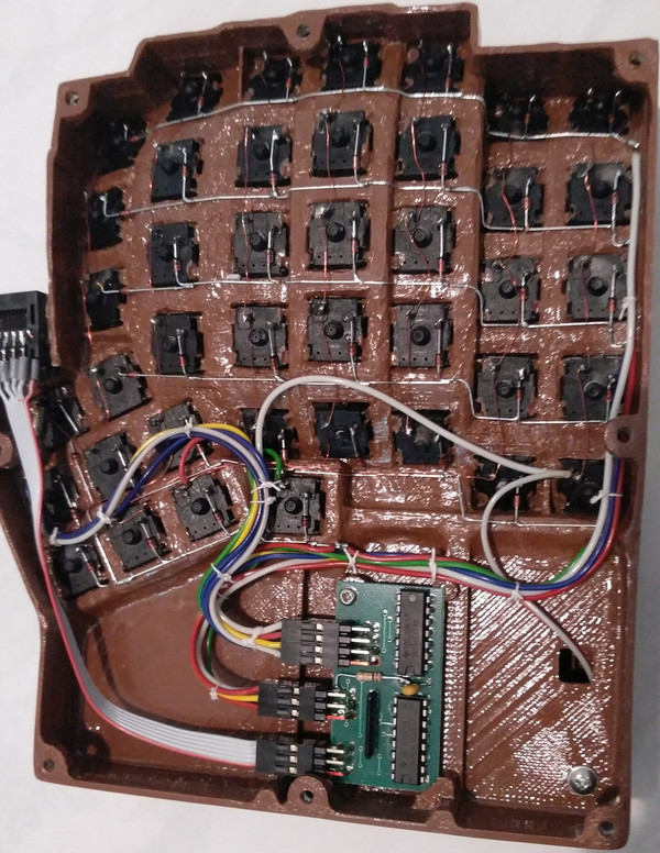

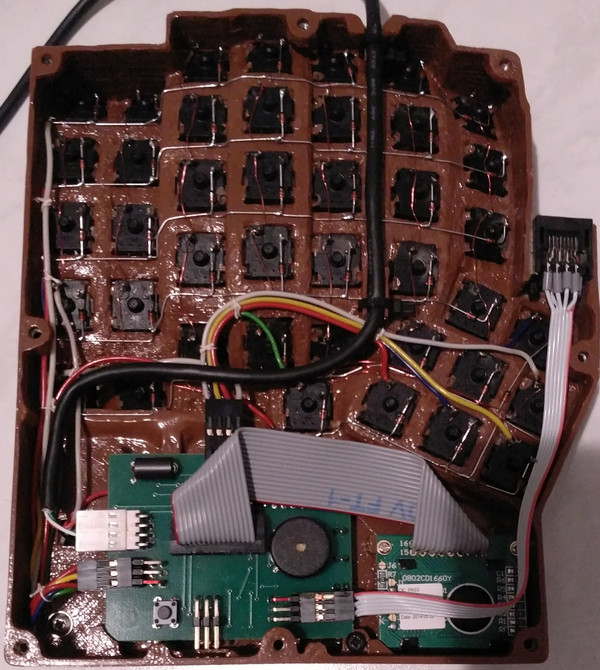

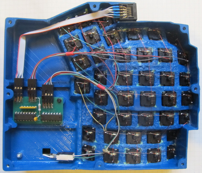

vvp
24 Dec 2016, 09:47
And the inside of the left side:
I soldered the diodes on all the switches at once => the left side has wrong diode orientation too => there was more work making the keyboard matrix. Just as bad as on the right side.
Happy holiday!
vvp
02 Jan 2017, 16:12
Hardware is done:
And it seems to be working fine. The basic firmware functionality is working. But I added only one more layer. So there are 3 layers now: normal, keypad, function. Two new buttons were dedicated as function layer shifts. Another two new buttons work as "macro shfit" for now. The idea is that I can assign macros to a key combination (e.g. MacroShift-A, MacroShift-B, ...) without blocking any other key combination which may be useful for OS. Well this is a firmware change and can be used also on V0.7 hardware. One just needs to sacrifice some other key as MacroShift. The basic firmware features seem to be working but it is not tested well yet. The PC client application for easier key remapping, macro management, and program uploading is not updated for V0.8 yet.

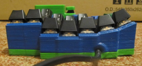

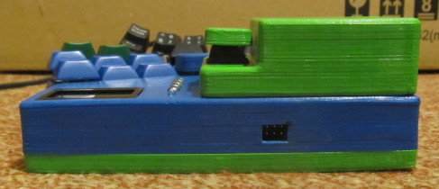

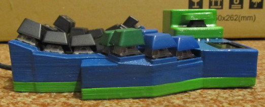

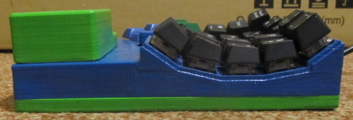

GEIST
15 Feb 2017, 18:24

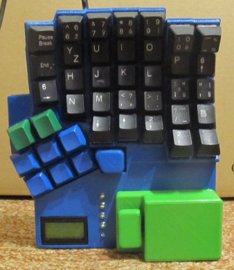

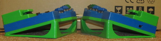

Could you post some images from the outside?
vvp
16 Feb 2017, 00:14
Well, I can post some from my build. The outside shape of the case is exactly the same as sva's case. The differences are only from the inside. So it will do. I already posted the overall view. The tilt angle was 11° here:
I guess you are interested in side views to have a better idea about the shape/tilting. The tilt angle shown below is 15°. Also different keycaps are used.
I forgot to take a picture of the bottom but there is nothing on the bottom. It is just a green plastic plane with cutouts for eight M3x6 hex socket screws (which hold bottom and the top parts together and a Ø 3mm hole through which I can press the reset button.
The left side is the same as the right side but without USB cable, LCD, LEDs, the reset hole, and the PDI hole (the square opening on the near side (the first picture in this message)). PDI hole is the debug port for firmware development.
The pictures are kind of small but I do not want this thread to load long time because of tens of huge images. If you are interested in high resolution pictures of some parts then let me know and I'll probably link them to my web. Though the links will work for only about a week. Or maybe I can upload them here and hide them in a "spoiler". Will that make sure that the pictures are not being loaded until the user presses the "spoiler" button? Still I do not want to load deskthority with megabytes or images.

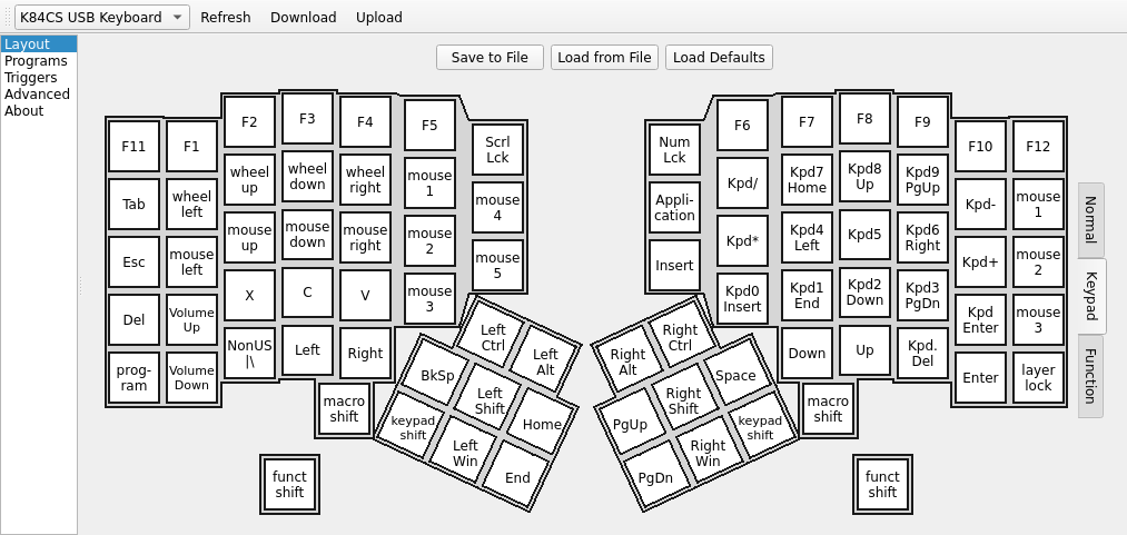

I implemented the support for macros which merge with the actual keyboard state. It was pushed to github. I used it only a little. There might be some bugs. I wanted to get it out since somebody indicated he might have a look at it and I want to let him know that it is already done.
Macros which are triggered by one key only are merged with the actual keyboard state. For example, if the macro bound to key A in Function layer is Shift-F1 and Ctrl-A is pressed in the Fucntion layer then the actual code emitted to OS is Ctrl-Shift-F1. Macros which are triggered by more than one key continue to be exclusive as they were: they will not be merged with the actual keyboard state. All the macros continue to be defined on the fly as before regardless whether they are merging or exclusive.
This is implemented for all Katy versions (from v0.6 to v0.8). The only difference for v0.8 is that the full-reset will fill <modifierKey>-<functionKey> chords into the function layer like this (the first 4 key rows):
Win-F11 Win-F1 Win-F2 Win-F3 Win-F4 Win-F5 ScrlLck  NumLck Win-F6 Win-F7 Win-F8 Win-F9 Win-F10 Win-F12
Alt-F11 Alt-F1 Alt-F2 Alt-F3 Alt F4 Alt F5 CapsLck  Applic Alt-F6 Alt-F7 Alt-F8 Alt-F9 Alt F10 Alt F12
Shf-F11 Shf-F1 Shf-F2 Shf-F3 Shf-F4 Shf-F5 VolUp    Insert Shf-F6 Shf-F7 Shf-F8 Shf-F9 Shf-F10 Shf-F12
Ctr-F11 Ctr-F1 Ctr-F2 Ctr-F3 Ctr-F4 Ctr-F5                 Ctr-F6 Ctr-F7 Ctr-F8 Ctr-F9 Ctr-F10 Ctr-F12
That's only the default. People can redefine it whatever way they like.
Notice that LayerShift / LayerLock keys are not included in the number of macro trigger keys. Therefore e.g. FunctionShift-A counts as one key trigger A which triggers a mergable macro Shift-F1.

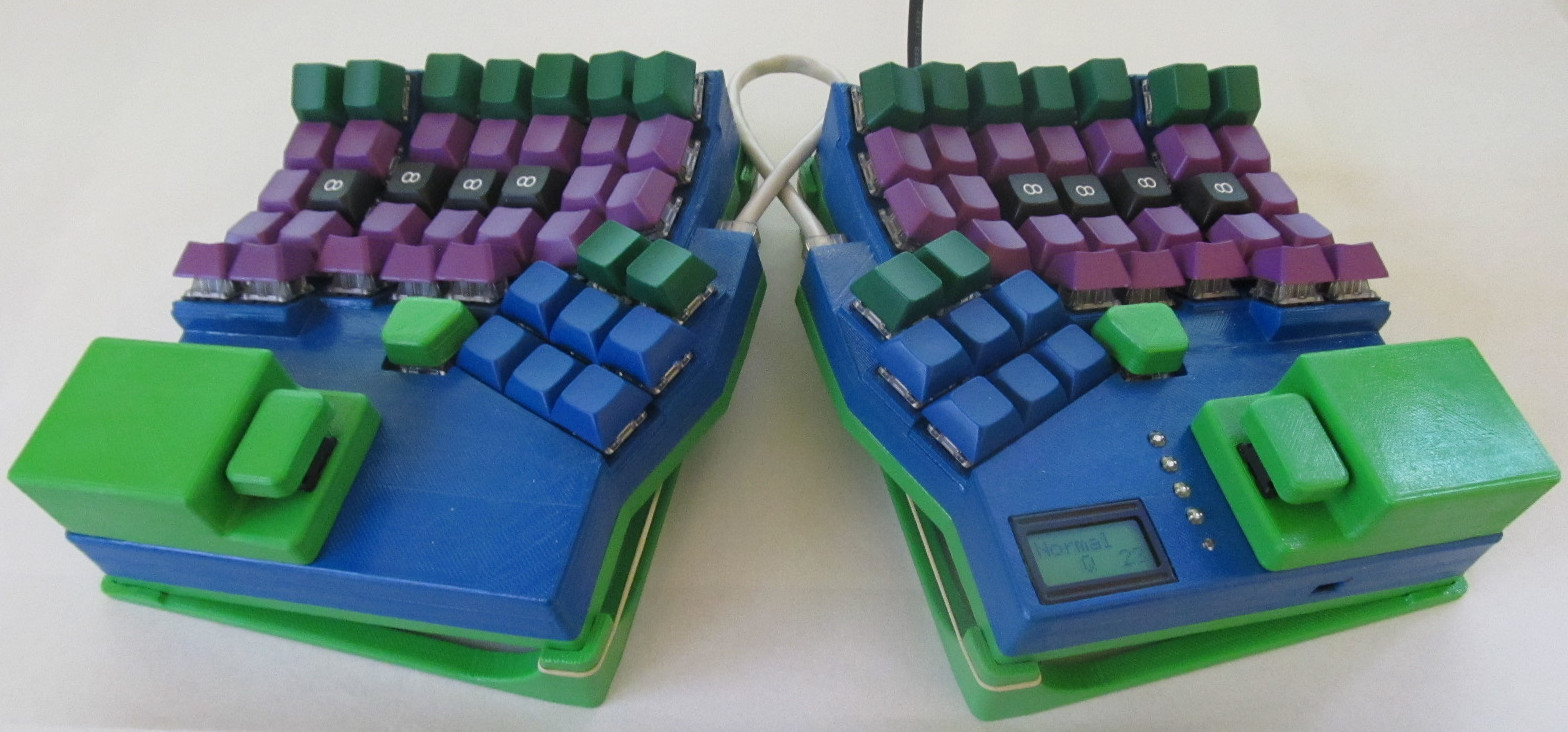

sanjibukai
10 Jun 2018, 01:58
Hi,
Awesome build!!
Do you have a demo video or something?
How the palm buttons are used?
Layers switching?
What's the purpose of the screen?
vvp
10 Jun 2018, 19:42
sanjibukai wrote: Hi,
Awesome build!!
Thanks.
Sorry, I do not.
I use them as Function Layer Shift now. But one can redefine them in any other way. If layouts are modified with the PC configuration application then any key can be redefined to anything. If the functionality is redefined with the built-in Program key then special keys (Program, Macro, Layer Lock, Keypad (Layer) Shift, Function (Layer) Shift) cannot be redefined.
I'm considering increasing number of layers to 5 (or maybe at most to 9) but that will not be anytime soon.

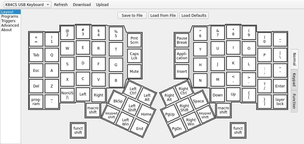

Layers switching?

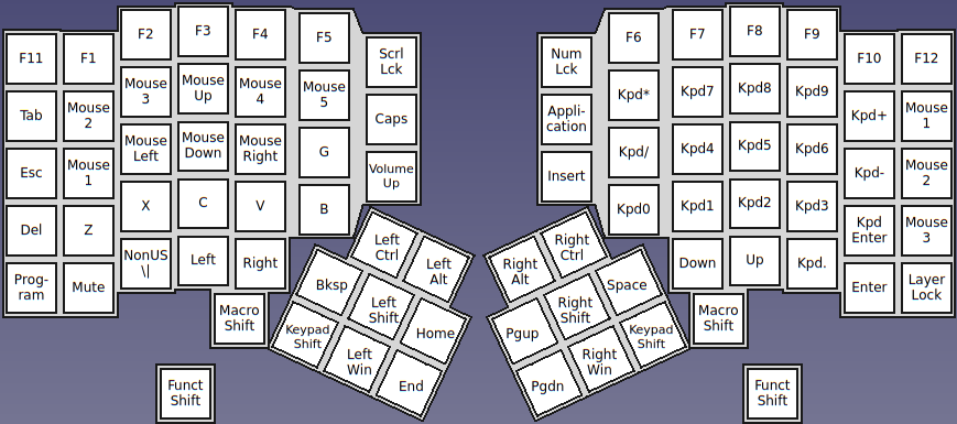

There are 3 layers (Normal/Default, Kepad Lalyer, and Function Layer).
Except layers, there are 10 configurations slots. A configuration is a set of 3 layers which can be backed-up under some number key (0-9). A backed-up configuration can be retrieved later on.
sanjibukai wrote: What's the purpose of the screen?
It shows:
  • current layer name (one of Normal, Keypad, Function)
  • one letter indicator whether macros or programs are enabled
  • light sensor raw value (it equal to about ½ of lux)
  • which lock is active (Caps/Scrol/Num) .. these are indicated also by the LEDs (which have brightness control based on the data from the light sensor)
  • small help indicating what is the state of the keyboard when one is programming macros or remaping keys
  • a value of the current divisor when configuring how many times the mouse pointer speed or the mouse wheel speed is slower than the keyboard polling rate (which is 2 ms)
  • error messages (e.g. "USB Wait" when host is not communicating with the keyboard)
The default layouts are below. One can redefine them in any way; these are just defaults.
The function layer has the default key mapping the same as the keypad layer but it has one key triggers set on it by default too. These triggers run different function key combinations like this:
When macros are not enabled then the default function layer is the same as the keypad layer. If they are enabled the indicated macros are triggered instead.

I also added a key press counter to LCD of K84CS. Not really useful; just for fun.
