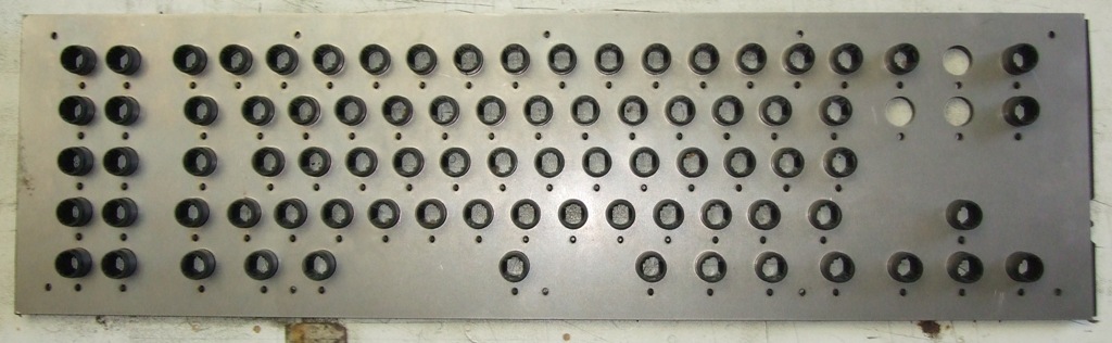

i have everything but the controller done. 8x11 or 8x12 would work for me. here is the new steel plate and pad with barrels installed.
XTant Plate.JPG (97.81 KiB) Viewed 6366 times
i'm actually getting pretty good at DIY PCB's. I use the photoresist method and can get very fine detail.

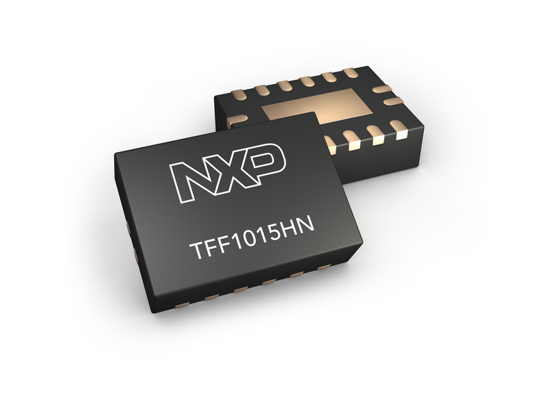

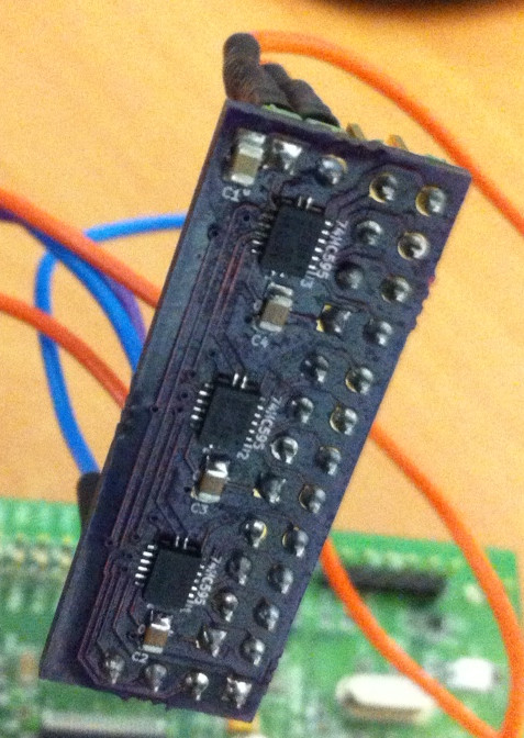

I had a tiny board made at OSHPark to test out the 74AHC595 shift registers in DHVQFN16 package (2.5x3.5mm):
These will replace the 74HC4094 (SOIC-16 package, 10x6mm) shift registers used on Rev1–3 for column strobing. Aside from the massive size reduction (see below, compare size next to 0805 capacitors), there is a significant other benefit; 74 AHC series, instead of HC series CMOS.
The AHC series has very powerful drive and fast rise times (to allow ≥100MHz clock speeds). As we are relying on I = C(dV/dT) to detect the change in capacitance, we can increase the `gain' of the pulse out of the row by either reducing dT, or increasing dV. It's hard to increase dV; one could either reduce biasing voltage, which leads to the danger that you'll get a negative voltage when the strobe turns off—probably not good long term for the comparator, or you need strobe voltages higher than 5V, which is a bit tricky. However by switching to 74AHC-series shift registers for driving the strobe pulses, we can reduce dT. 74AHC has a brutally fast rise time (so much so that concerns around ground bounce have plagued it since introduction); on the scope I'm seeing at least 2–4X decrease in rise/fall times compared to the 74HC, even when testing at 3V (I used my STM32F4 Discovery board to test it out). At 5V the rise time significantly shortens even further. In practice it should be even better when compared to the 74HC, as the powerful drive (which is designed to overcome parasitic and input gate capacitance when driving other chips) should mean the rise times stay good even under load (i.e. driving a beamspring board).
The reason I'm bothering with this is less for the classic beamspring boards, but more for looking towards the Displaywriter and (somewhat similar) Model F boards, which don't seem to be laid out with quite as much care as the nice clean early beamspring boards. I'm told by others experimenting with the Model Fs that there is significant variance between individual keys; having a greater `gain' on the resulting row pulse hopefully means there is more tolerance for variations and hopefully still allows a single threshold reference.
This was also a good test to see just how fine-pitch I can get with my toaster oven reflow. As you can see, the chips have no leads per se, and the gap between each pin is about 0.25mm, at 0.5mm pitch.
photo 2.JPG (114.25 KiB) Viewed 5915 times
As it turned out, everything reflowed fine; there were a couple of bridges, but they were easily fixed with a soldering iron and some liquid flux.

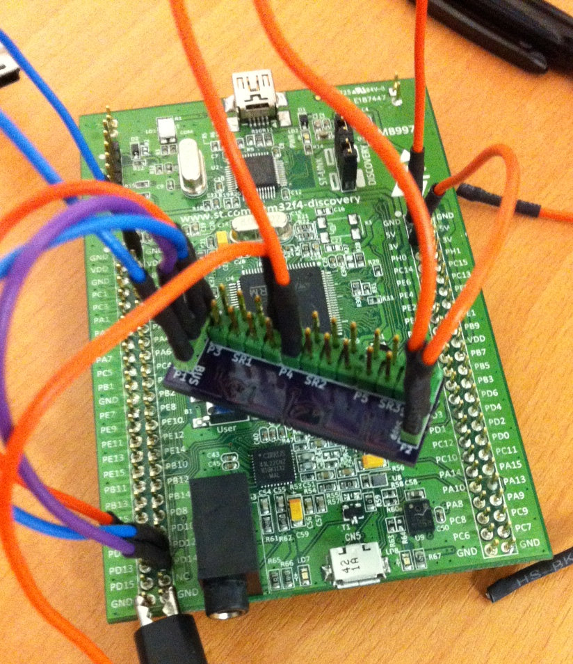

Every pin scoped out fine when I drove the thing from my STM32F4 dev kit:
photo 1.JPG (260.78 KiB) Viewed 5915 times
So gives something to start with on Rev4/Displaywriter anyhow.
