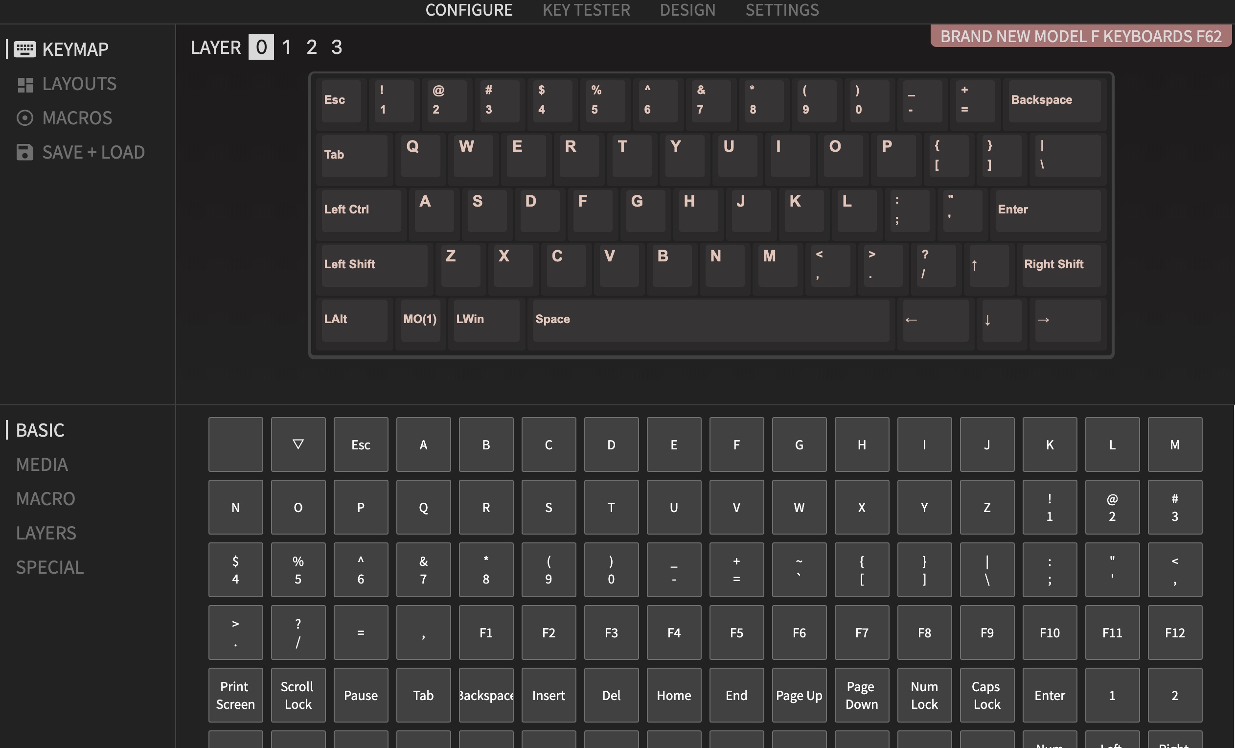

I have added the tested VIA files (Firmware, Layout, and small PDF that explains things).
They are built for the Brand New Model F (F62 and F77 - all layouts). Everyone who wants to test the easy to use VIA App to assign the key layout - you can download the latest versions from here:
https://www.bucklingspring.com/via-firmware-and-layout/

I want to give an additional info that was written up by GH user dc_in_sf"
I have added a eeprom_eraser.hex in the latest version on www.bucklingspring.com which will take care of the issue with by completely filling the flash chip with zeros. It is also described in the doc I have added to the zip.
I am using a unconventional firmware on my system and had issues with some keys being properly recognized, but the eraser beautifully solved the issue. I was still able to hit Fn+Space+R, otherwise I would have needed to short the program jumper on the controller.
So, there is a slight risk with someone having a broken key mapping to require extra legwork to re-flash it.
There are some important things to know about VIA and the F77
There are two main ways with stock VIA to get it to ignore a key map stored in EEPROM
1. Use Bootmagic lite to reset the keyboard, VIA enabled firmware will then ignore the currently stored keymap
2. flash the KB with a version of VIA firmware that was compiled on a different day (VIA compares the FW date with a value stored in EEPROM)
The issue with the F77 is that you can't use bootmagic because the keyboard calibration routine that runs on powerup will mean that a held key is not detected when the control gets to the bootmagic routine.
So if you are using VIA on the F77, and the keymap becomes corrupt in some way (and e.g. causes the FW to crash), then your recovery choice is to compile a new version of VIA and flash it in yourself. Flashing in a regular QMK build *will not* clear the EEPROM, when you go back to your VIA FW the same key map will still be there. Non QMK FW may or may not fix it depending on whether it actually changes the EEPROM.
pandrew has a utility that in theory can clear the EEPROM, but it uses the same communication channel as VIA, so to use it will likely have to flash in a non VIA FW to make it work.
It is unknown how much of problem not being able to clear the EEPROM is. I have had no issues with any of my VIA enabled keyboards to date, so possibly this is a non issue, but the VIA folk thought it was important enough to enforce Bootmagic lite in VIA builds.
My take, use it, by just be warned you may have to muck around a bit more to recover a messed up keymap

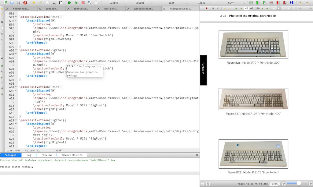

I wanted to give a quick update on the status of the Technical Manual.
After chatting with Zed (who's ideas and work I value so much), I dissected the LaTeX document and started to do a small rebuild of what we have so far.
I have not only segregated the sections into different files, I also did the same for the figures and photos.
Furthermore, I segregated two variants of the Manual:
The Print version will use the original IBM design with rotated pages, tables, or graphics. The size of the photos is normally full size in best quality including color profile.
Within the latex typesetting files I am using a processifversion detection, so it will automatically produce the versions needed. All within the single project.
- Digital
% Define which version should be produced Digital or Print
% Options in the typesetting docs are:
% \processifversion{Print}{Hello Print Version!}
% or
% \processifversion{Digital}{Hello Digital Version!}
\excludeversion{Print}
\includeversion{Digital}

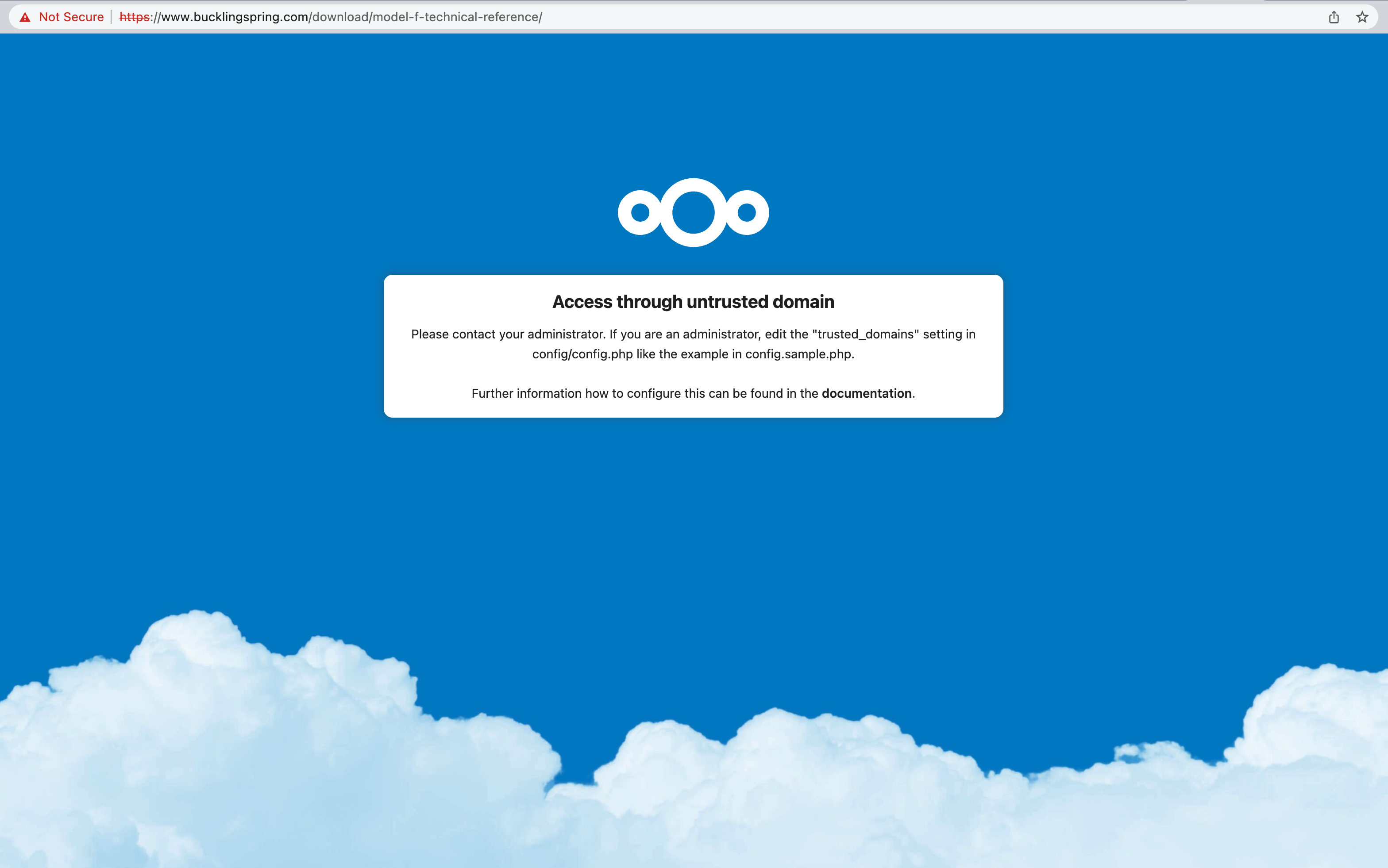

Today I released probably the largest update of the Model F Technical Manual, yet.
I have re-written it so it has a print and digital (viewing) version. Both versions are not only different in size but also in its appearance. For example, the digital version has no 90 degree rotated tables or drawings, as you can easily zoom in to your needs, I also optimized every photo for sRGB instead of printing colors. Tables have been re-created for each variant; drawings went through the same exercise.
Finally, I have re-drawn nearly all illustrations that previously used PNG or JPG files. These are now SVG, EPS, or PDF line art graphics.
https://www.bucklingspring.com/download ... reference/
https://www.bucklingspring.com/download ... draft-0-6/

I'd love to be able to check out the website (bucklingspring.com) and the manual, but I get an error anytime I try. Has anyone else here run into this issue and if so, what's the work-around.
Thanks!
Thanks!
- Screen Shot 2022-11-11 at 1.52.18 AM.png (1.1 MiB) Viewed 5218 times
- darkcruix
- Main keyboard: Brand New Model F F77 Keyboard
- Favorite switch: Ellipse version of Buckling Spring / BeamSpring
- DT Pro Member: 0209
I am in the process to move the site to a different cloud space. Unfortunately, I had to stop in the middle for a week or so. I have uploaded the actual version to this temporary link for now: http://195.90.200.37/ModelFManual.pdfj-pevar wrote: 11 Nov 2022, 10:54 I'd love to be able to check out the website (bucklingspring.com) and the manual, but I get an error anytime I try. Has anyone else here run into this issue and if so, what's the work-around.
Thanks!

This manual is amazing. It exceeded every expectation I had for it. So much information I wish was readily available when I received my new Model F. Now mass print it and include it with every new Model F!
