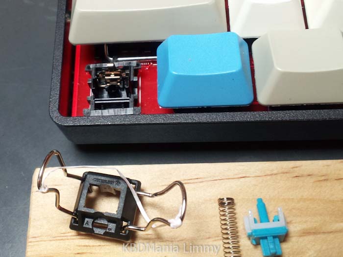

Posted: 07 Jun 2012, 13:20
by off
Limmy wrote:For instance, True / False questions are called OX questions in Korean.
O is considered check mark and X usually used to cross out incorrect information.
Clear as crystal. Just weird. :P
However we westerners do use X to cross out things and a check mark is like a V only with the first diagonal only half as long. /trivia
Limmy wrote:thought two strips of tape would have identical effects. I cut the tapes about 1mm wide.
To see if your switch rattles...
I don't even have to check, I know exactly that/how the tops move about.
Cheers!
Now subjectively, do you *like* what that diy stickermod did to the board (and would you do that again)?
Limmy's pic+mod, from http://www.kbdmania.net/xe/3681762
Limmy's diy cherry switch sticker mod and binderclip-keycap-puller 2012-02-26 02.40.30.jpg (79.93 KiB) Viewed 6371 times
And good to refind that binderpuller, was that your 'invention'?
*sheesh, reading the topic title again... this is pretty far off-topic. oh well, good info nonetheless :D

off wrote:I don't even have to check, I know exactly that/how the tops move about. Cheers!
Yes, I would do the sticker mod again, if a board is PCB mounted(less work obviously). I like the sound of it after the mod so much better which is entirely subjective. By the way, some like the sound of switches with some rattling noise because without such audible feedback they think typing is not so interesting. However, deafening rattling sound made other noises more pronounced. Spring scratching against sliders is the one that I noticed after the sticker mod. So, when I do it, I would at least lube the springs so that it doesn't make unwanted noise.
off wrote:And good to refind that binderpuller, was that your 'invention'?
No, I just reintroduced the tool. It has been used way back in 2006 probably before. See http://www.kbdmania.net/xe/119861 Among the comments in the post, one member mentioned two of the tools can be used in the way I introduced in the other post. You can see more ideas on the opening tool here on DT in here: http://deskthority.net/workshop-f7/how- ... t2130.html

http://park16.wakwak.com/~ex4/kb/tech/c ... _click.swf
But given that it goes away even with a drop of oil I bet it would.
Posted: 09 Jun 2012, 18:16
by off
ripster wrote:This might help. Click might NOT go away with an oring.
Ha, quick edit!
Was gonna say 'back up your statements of solid undisputed truth a bit more often if you would'. ;)
Anyhow, as I said the only references I have *are* those animations, and this one does only reinforce what I just said..
Afaiu the click comes from the popping down of the white clicker, hence a stop above the clicker shouldn't kill any click, only the clickback that presumably occurs when you bottom out a blue.
Honestly I'm looking forward to the results of anyone testing this. I will, but only once 7bit's switches arrive, and seeing how that might take a while (and my camera/setup/photoskills are not quite HQ) I'd love to hear/see what the result is from anyone else!
Posted: 09 Jun 2012, 18:33
by ripster
Not me, I'm going to take pics of that weird Cherry MX WHITE switch and figure out why it doesn't act more like a MX Green.
How are the Geekhack Cherry MX wiki edits going guyz?
