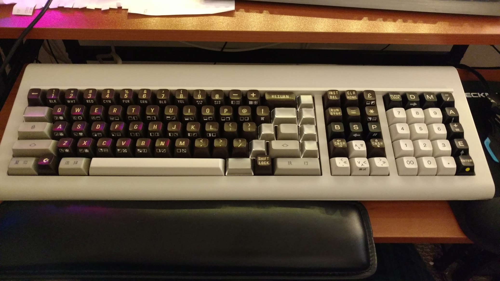

So I wanted to find some keycap replacements for my pingmaster. It's a bit hard to find keyboards with these same switches. Ultimately, I got two keyboards- a Ti-99/4A and a Commodore 64. The C64 doesn't use these switches, but I was able to get the caps to fit well enough with only a minor amount of mutilation. The Commodore logo key is especially awesome. As for the Ti-99/4A, there were 4 different keyboards made, only one with these switches- luckily I found an ebay posting of the bare keyboard PCB so was able to see the Alps logo in the pictures, but with some research you can also figure out which keyboard are which by looking at minor differences in the keycaps.
I've been playing around with the best layout using these keys, and this is how my board looks at the moment:
- IMG_20170517_000922718.jpg (272.42 KiB) Viewed 8369 times
Obviously there's a lot of caps that don't match what the keys do, but it's the look that's what's important!
A E S T H E T I C S
Very nice, but how in the heck did you get that Return key to fit up there?

just_add_coffee wrote: Very nice, but how in the heck did you get that Return key to fit up there?
The return key has three mounts, and the outer two are perfectly spaced so they can fit on adjacent posts. Unfortunately, the shorter modifier keys- Shift, Control, Restore, and Function- all have two mounts, one on the left and one on the right, which is weird and means I can't fit them in matching spots on the Pingmaster, which are designed for a single central mount.

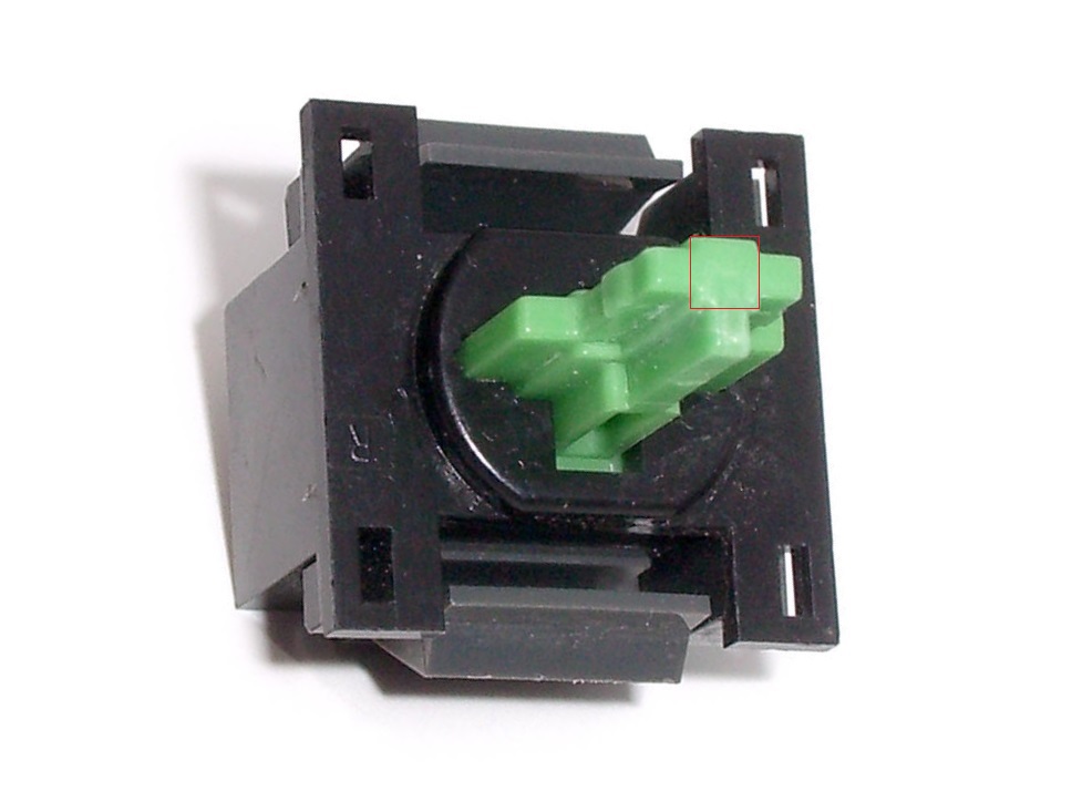

seebart wrote: Elaborate please!
So the SKCC post is T-shaped, but the center of the post also has a square shape to it. This shape prevents usage of pretty much any keycap that's built for a simple cruciform shape.
- Alps_SKCC_Green_--_variants_table.jpg (88.22 KiB) Viewed 8322 times

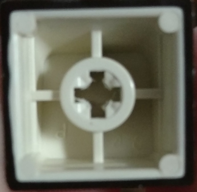

My solution was to grind the inside edges of the Commodore keys so that there's space for the central square.
What did you use to grind the inside of the keys with?
Good point. And how long did all this take you?

I used a screwdriver that I got to adjust my mouse, the Torq X10. It's a hex-star shaped thing.
The screwdriver was the perfect size for it- I could stick it into the keycaps so that the nooks in the screwdriver matched with the inner edges of the cap. Then by rotating the screwdriver a bunch of times it wore down those inner edges. Took less than a minute per cap. If you don't wear them down enough, they'll go on crooked.
