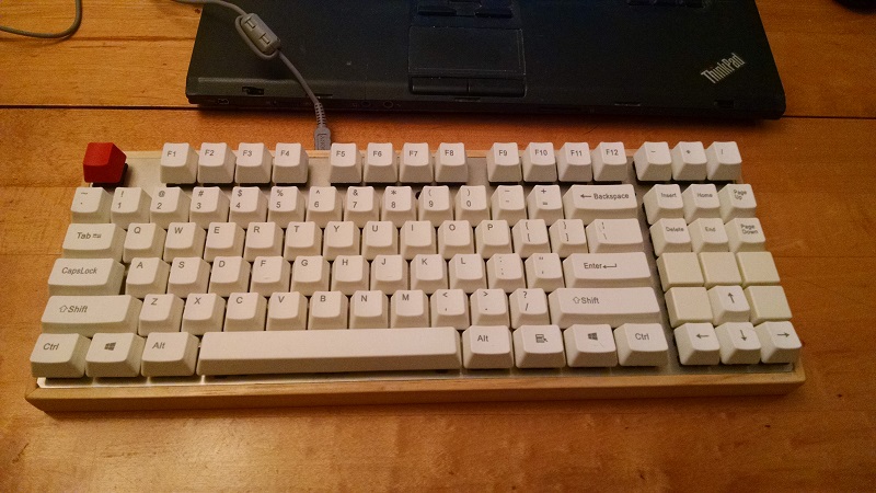

I had some issues with a backwards diode, one bad switch, and a short due to a nick in the insulation but I have the "prototype" complete (typing on it now). I'm going to build another case in better wood and at least 5mm shorter. This one was more of a proof of concept.

There is no inclination in the case itself. My plan is to add rubber feet to the back. Those aren't acutall blockers, just flat keys. I did buy blockers also though, in case the flat keys didn't work. I typically find the arrow keys by feel rather than sight and wanted something that would distinguish them from the surrounding keys. I bought both the blockers & flat keys from Signature Plastics (the only place I could find either):

I had issues with the stabilized switches on mine as well. I found that the cilps had a little lateral movement and needed a little tweaking to make sure that they were parallel to each-other and the sides of the plate. Adjusted in that way and they went from barely working, to working well.
I just found that I have another bad switch, or I have a short somewhere. Turns out I was pretty sloppy with my handling of the wires and there are quite a few nicks in my wire insulation. It looks good though!
