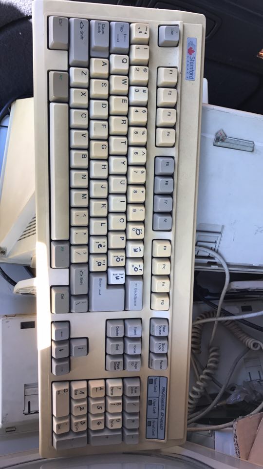

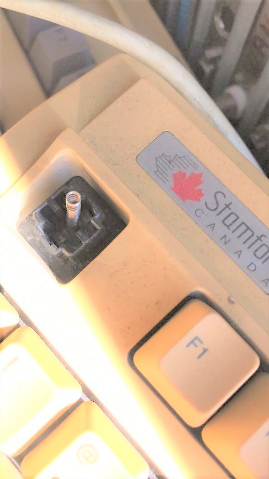

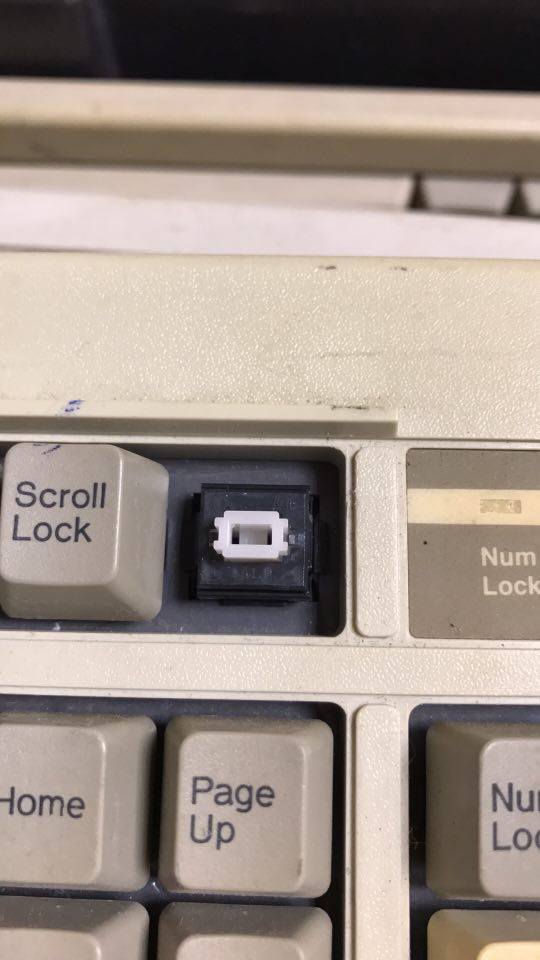

What kind of keyboard could it be?
subcat
18 May 2017, 15:52
I believe that's a Monterey K208.
coreinsane
19 May 2017, 15:29
What kind of keyboard could it be? Are they buckling springs?
ohaimark
Kingpin
19 May 2017, 19:23
It's an Asian buckling spring variant. I don't remember the name at the moment.
Laser
emacs -nw
19 May 2017, 20:09
ohaimark
Kingpin
19 May 2017, 21:24
Doesn't quite look the same. Probably similar feel, though.
20 May 2017, 00:40
Maybe you're thinking of Syncan buckling spring. That uses a cruciform slider well. It's hard to say, being black in this picture, but it looks different.

20 May 2017, 00:45
Chyros wrote: Maybe you're thinking of Syncan buckling spring. That uses a cruciform slider well. It's hard to say, being black in this picture, but it looks different.
How about this over exposed picture?

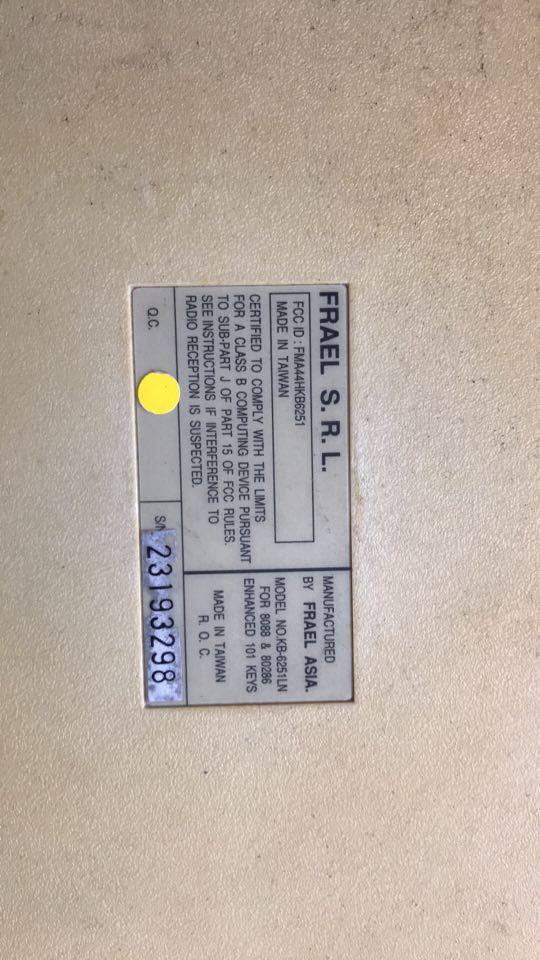

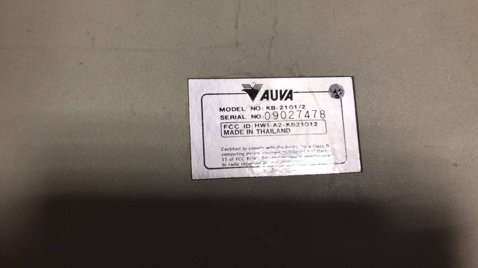

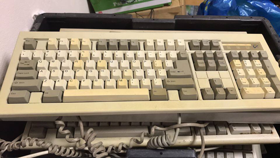

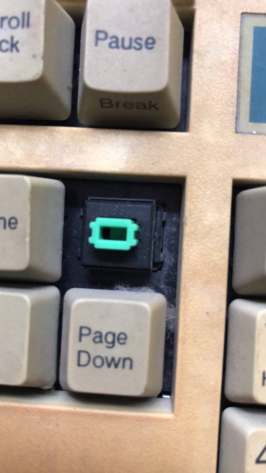

coreinsane
25 May 2017, 08:36
Are those SKCM white?
coreinsane
25 May 2017, 08:37
Are those SKCM green?
subcat
25 May 2017, 08:50
Ha, I love the first one. Looks a lot like it's a clone, you can tell because they didn't even spell ALPS correctly :D
Second one is also a clone.
coreinsane
25 May 2017, 09:16
Just found this too.
25 May 2017, 09:24
The first one has real Alps. The markings on SKCM switches can be very faint.
The second keyboard is interesting. KB-6251LN. It's a [wiki]NTC KB-6251[/wiki]. The last letter is "N", for Nan-Tan switch. That series was notable for having linear switches as an option, which is what you have. It's a bog standard [wiki]four-tab clone[/wiki].
The "L" is the surprise. Normally, it's EN (Nan Tan switch), EA (Alps switch) or EM (Mitsumi switch). Yours has "L" instead of "E" and I don't know why. Something must be different about it that's new to that model. Even the plate-mount types are still "E".
coreinsane
25 May 2017, 09:30
Daniel Beardsmore wrote: The first one has real Alps. The markings on SKCM switches can be very faint.
The white ones are just normal skcm white alps?
subcat
25 May 2017, 09:31
I guess I was mistaken. I did notice the slits, but seeing 'ALP' made me doubtful. My bad.
25 May 2017, 09:35
coreinsane wrote: The white ones are just normal skcm white alps?
Yes. Pine version (ca. 1988–1993).
