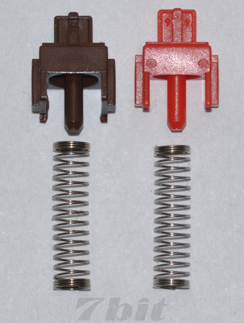

Brown on left, Red on right!
FIGHT!
Notice I started the coils on top in the same place this time.
FIGHT!

Photographed with 75-150 E-series (79,- EUR used), using built-in camera flash :
- CherryMX_brown_vs_red_spring_068808.jpg (81.96 KiB) Viewed 6028 times

Nice watermark!
Easy to crop out.
I keep meaning to check a bunch of springs but have vowed to spend less time on switch trivia. Why at least PING could have raised my Filco prices if everyone started RMAing them.

What nobody's done yet that would be interesting to see is take pics of 10 blue, 10 red and 10 brown springs, and count the coils and average them out. Showing one sample of each here and there only suggests manufacturing variance.
If you consistently show that one always has 12.5 coils and another always has 13.5, now you have some evidence of Cherry making springs that close to each other on purpose. Otherwise, you are just making limited data fit your perception. Perception might make a good starting point, evidence and testing make facts. You've done the first, now do the second. Consistently show blues have more coils and you'll have something. So far, I'm not sold.

Far better to actually measure the force at a few compressions - just as limmy and I have started to do. Counting coils means nothing if there's a variance in the wire thickness or something. So ideally, more force measurements would be good, but I only have one board with blues - it would be better for more people to measure forces on just a few springs than for me to measure a lot of my springs.itlnstln wrote:Otherwise, you are just making limited data fit your perception. Perception might make a good starting point, evidence and testing make facts.
BTW, the starting point for me was overlaying the Cherry force graphs and noticing the different slopes (between 2.5mm and 3.5mm, where all switches should be alike). Nothing to do with perception. It would appear that Cherry intended the springs to be slightly different for blues/browns/reds - even if the difference seems trivial to us. And even if that is correct, it's hard to prove because manufacturing tolerances could well give us some brown springs that are stronger than some blue springs.
So sure, it hardly matters to most people, but I'm still curious to find out whether they are meant to be different.
