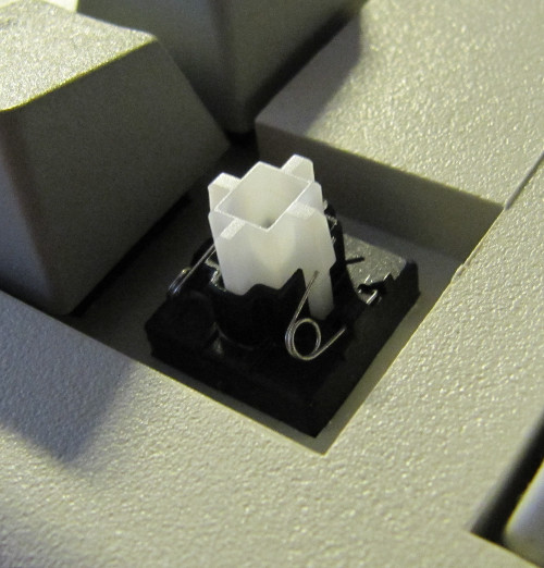

For my first post here, I have a question regarding an old Pendar keyboard from the 90' with the following key switch:
It’s the first time I see such a mechanical switch (loud and mostly linear by the way). Did you recognize it?
Re: IDENTIFY THE KEYSWITCH thread
Posted: 28 Jul 2019, 13:23
by Muirium
Clare Pendar made plenty of their own switches:
wiki/Category:Clare-Pendar_switches
And indeed:
wiki/Category:Clare/Pendar_switches
I’m only very vaguely aware of them myself. Could be you’ve discovered something undocumented.

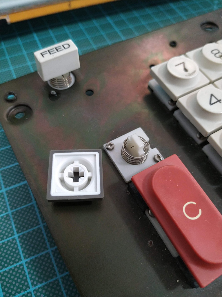

from some old calculator thing i found in the trash:
