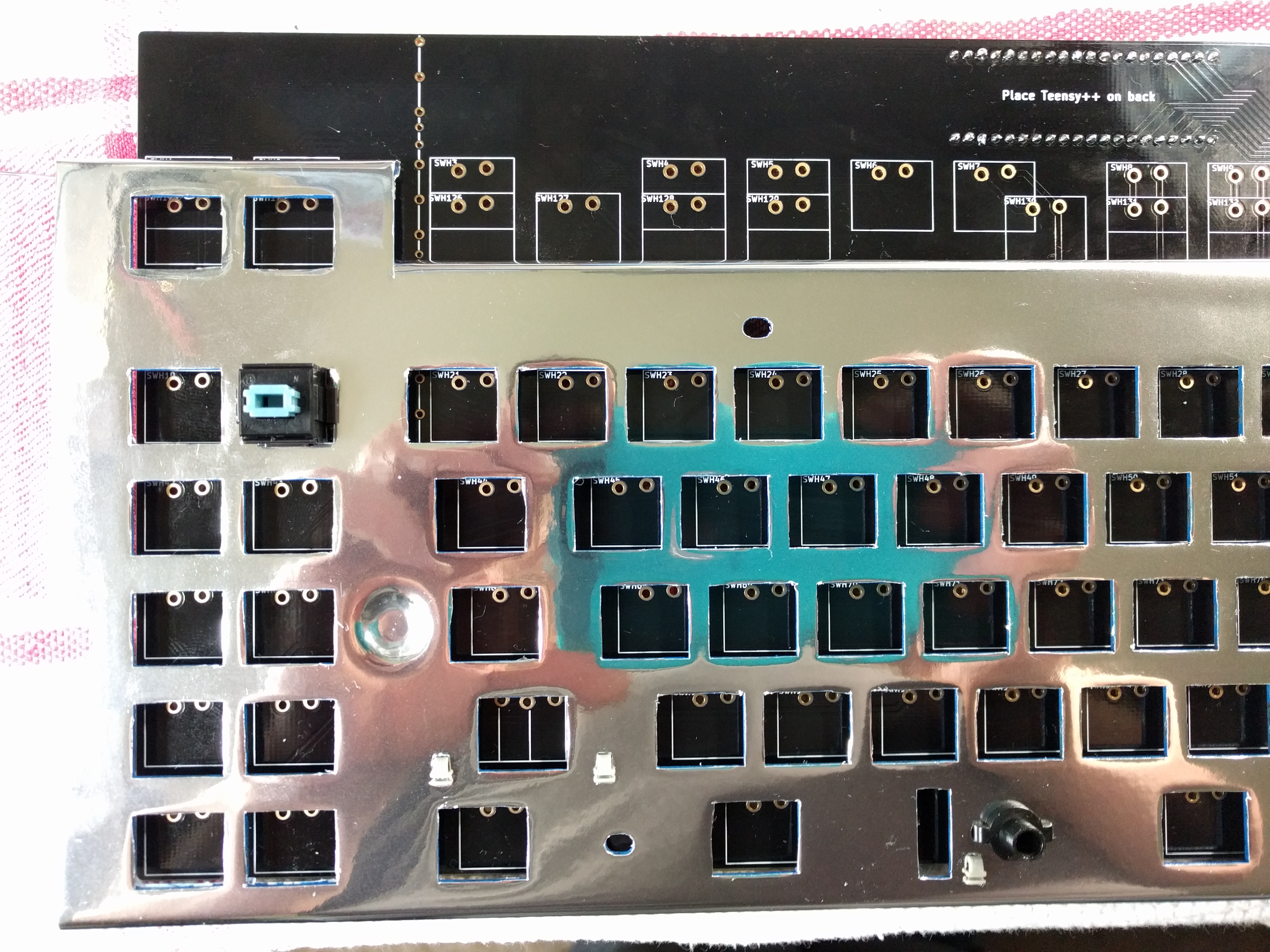

Also wanted to point out that all of the soldered mounting holes on the PCB are off...so if you use them, please place a few switches around the board(including numpad enter as it will help see if the board is offset) and then mark the holes to be filed to fit. This way you don't have switches slanted on the plate and I guarantee it is safe to file those holes as long as you stay within the exposed gold pad, which is easy as no hole requires that much filing. I wish they weren't this far off, but once again me and polecat were not using the most accurate method to determine the mounting pad locations and it shows. Will try and correct that in the file so if I make another batch they fit better.
Everything else on the board is perfect though, LEDs fit better than original as I have correct spacing unlike Northgate themselves. And if you are debating about what resistance to use for the LEDs, 330 ohm worked well with the following LEDs, which gave almost original brightness. https://www.mouser.com/ProductDetail/Ki ... Bqog%3d%3d Also they are the same exact size as the originals and look basically the same, which is a nice touch imo.

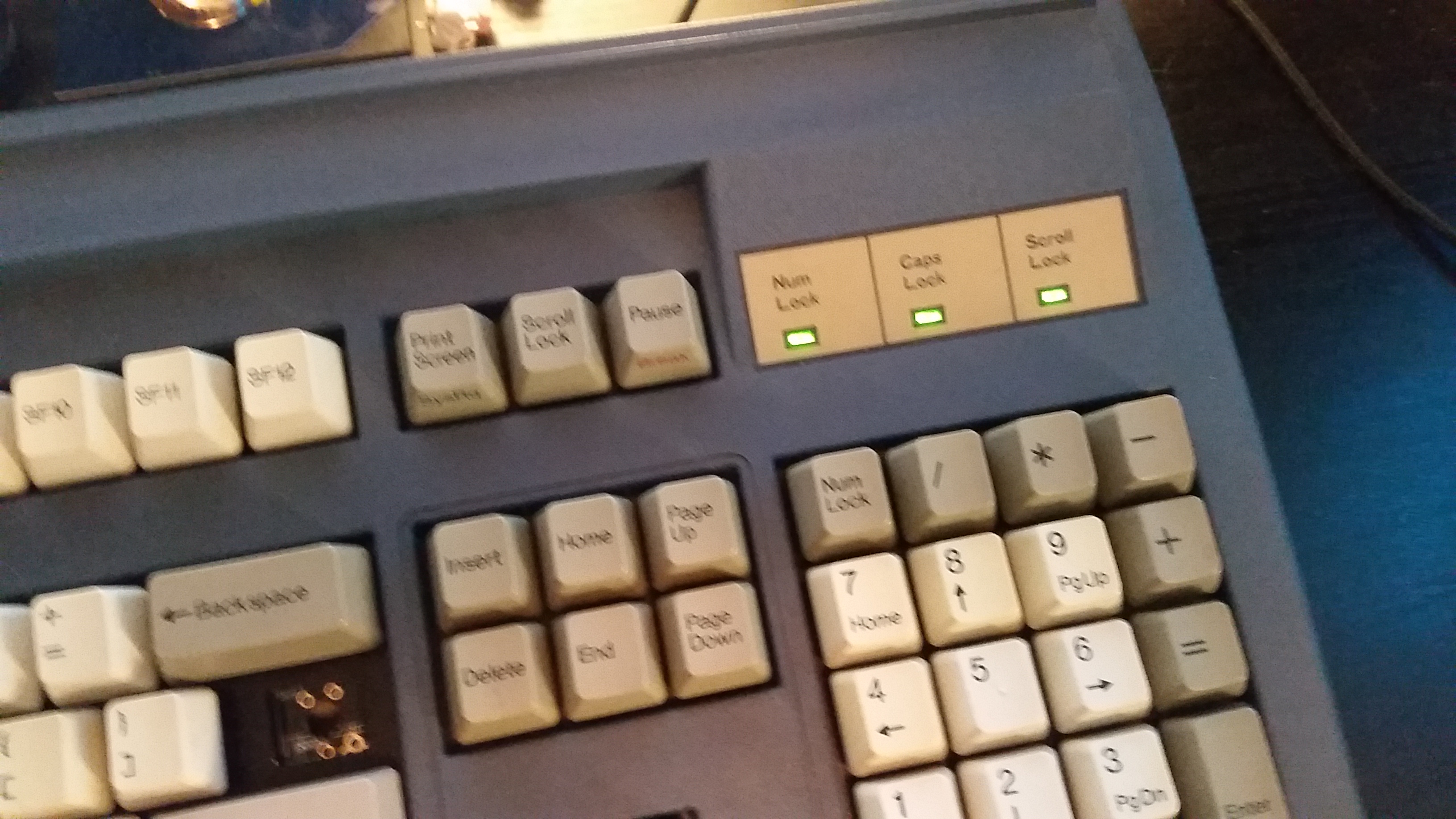

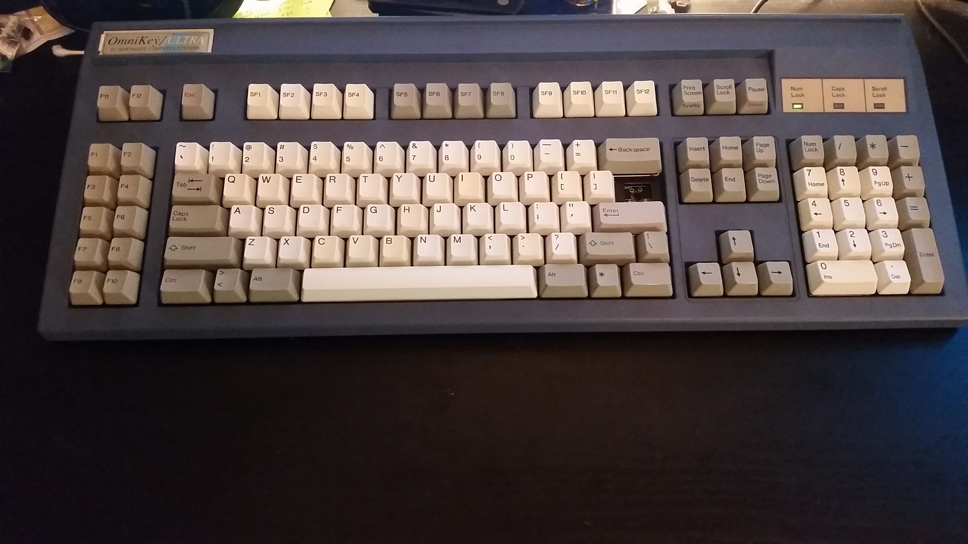

Finished building my omnikey with the PCB, which took way longer than I had expected...But really happy with the results. Everything works as I expect and programming was actually easier once the whole LED problem was solved(polarity logic in code was flipped). Also did a few fixes to the QMK firmware, fixed the bottom row mapping and forced NKRO as it wasn't enabled, so now everything should be ready for everyone to modify.
Will begin shipping out boards tomorrow, but international orders may ship out a tad later, just depends when I get the labels made.

BlindAssassin111 wrote: Finished building my omnikey with the PCB, which took way longer than I had expected...But really happy with the results. Everything works as I expect and programming was actually easier once the whole LED problem was solved(polarity logic in code was flipped). Also did a few fixes to the QMK firmware, fixed the bottom row mapping and forced NKRO as it wasn't enabled, so now everything should be ready for everyone to modify.
Also: pic!! =)

//gainsborough wrote: By mounting hole do you mean the holes that you use to screw in the PCB with the bottom panel or the holes that secure the PCB to the mounting plate?
I mean the ones that attach the PCB to the switch plate. All are off just enough that with switches installed after, they won't sit properly, so switches have to be mounted partially before the board can be filed and screwed in.

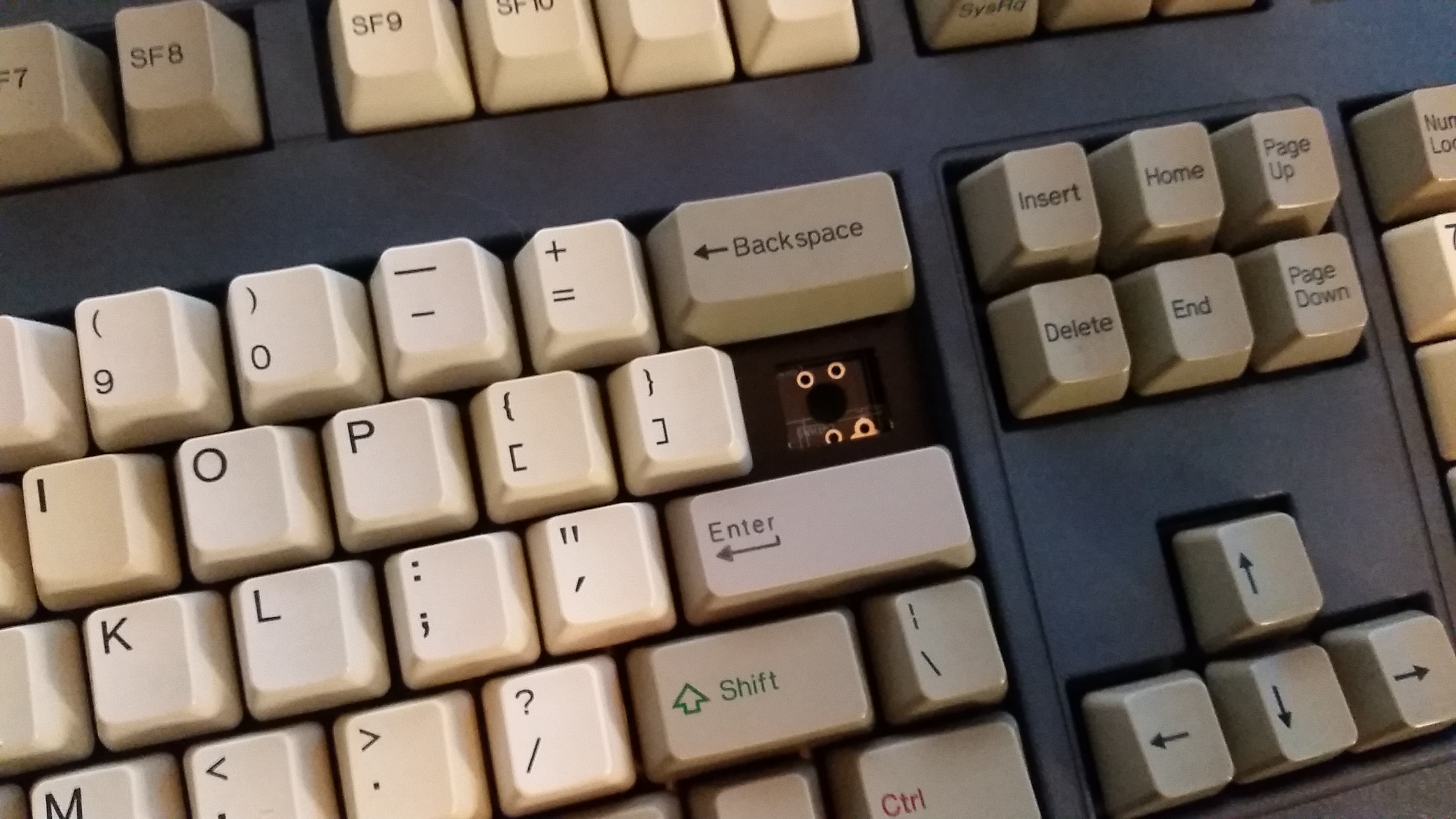

Proof the PCB is in there, and converting to ANSI so non matching enter and the slash key is missing atm:

As for the mounting holes, there would be no problem forgoing all of them, right? The switches soldered to the PCB should be rigid enough I would imagine.
BlindAssassin111
09 Apr 2018, 02:13
//gainsborough wrote: DAMN! That is gorgeous!!! What color paint is that?! I want to use it for an omnikey 101 i'm working on as well! Why didn't you solder in a pipe key switch? ALso what switches did you use?
The paint is the Dupli-Color Vinyl and fabric paint from O'reillys. It is more like a spray dye than paint, so the texture on the board is still perfect like it came, and doesn't flake at all. Love the color.
Didn't solder it as I wasn't sure if I wanted to convert to ANSI yet, and only decided after putting the board together, to do just that. So I will be soldering it in at some point soon. I used SKCM whites as it was the only alps I have and the exact ones that came with the board.
I would recommend using the screws still, adds strength to the board and that little bit extra is nice because of how omnikeys mount the plate to the case on the "newer" ones, so they flex a bit when you type. Optional but not more than 5 minutes to modify the holes.

what did you use to file the holes - I've never done a mod like that. Thanks for paint details!
BlindAssassin111
09 Apr 2018, 02:23
//gainsborough wrote: what did you use to file the holes - I've never done a mod like that. Thanks for paint details!
Cheap small files from home depot(or maybe harbor freight, don't remember), cost like $5. Just get the small ones and use the circle file to open the holes. Not much effort required, the files eat the FR4 PCB material easily so even a few strokes and you are almost done.
Kinda like this set, don't have to be good quality as you don't need them to last forever. https://www.harborfreight.com/12-piece- ... -4614.html
