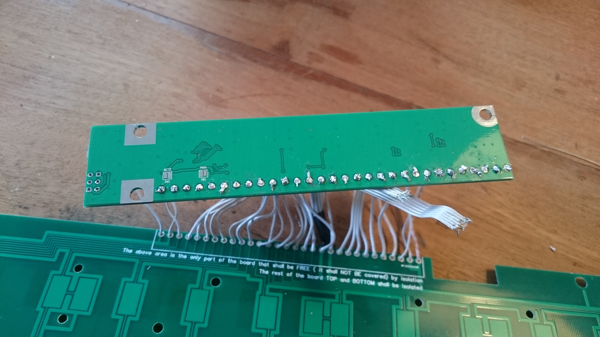

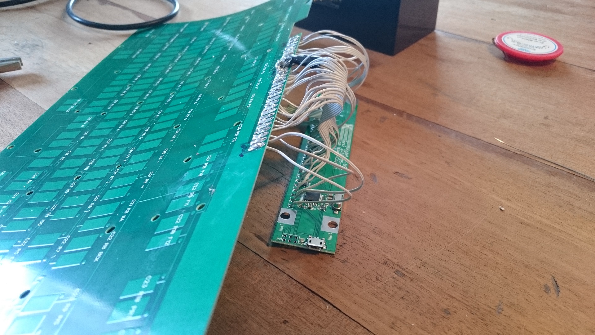

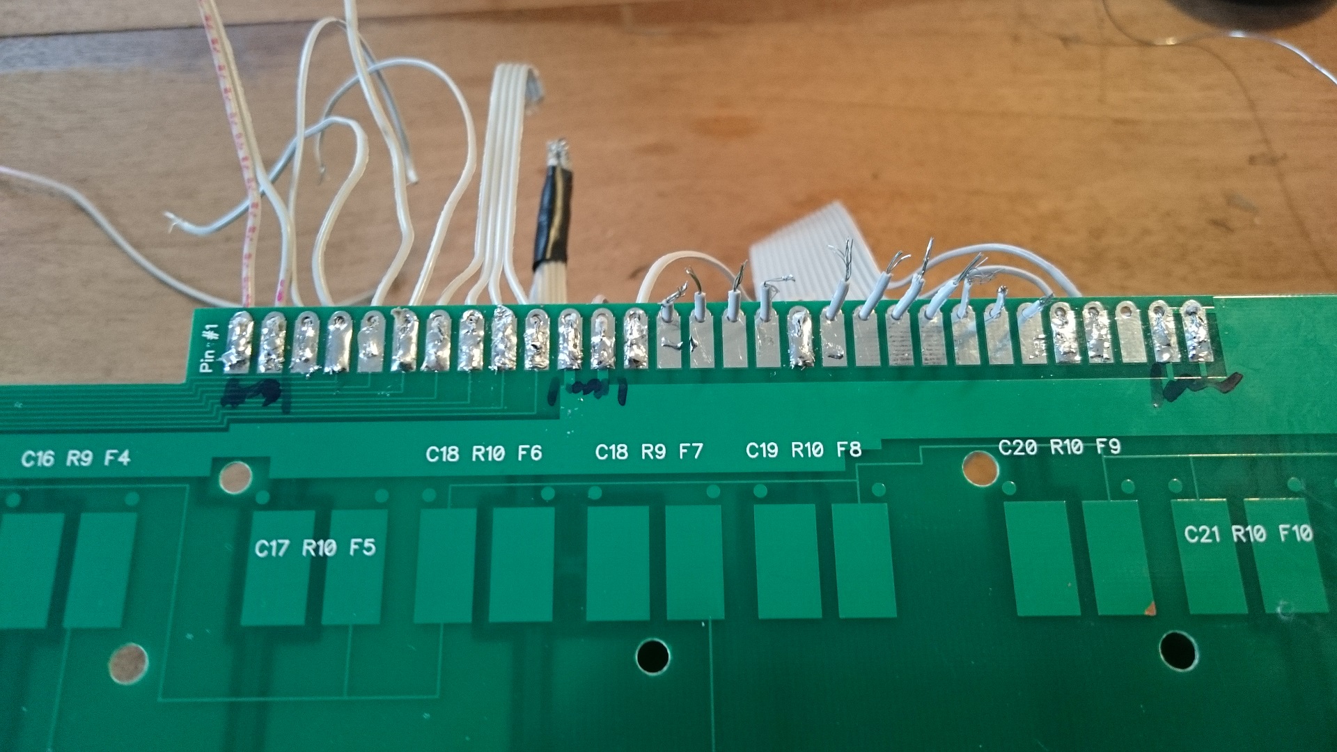

After postponing it for so long, it was finally FSSK building time today :D
The attachment DSC_0905.jpg is no longer available
Following your advice from the other thread, I did not use the mat.
I have the IDE ribbon cable ready, all it needs now is a controller.
Here I am a year later, and finally got my Xwhatsit. It was complicated, but Ellipse delivered in the end.
I got really far on the weekend, and though it took a while to get there, almost all keys work now! :D
I was really happy, almost a bit surprised I got it to work so well on the first day.

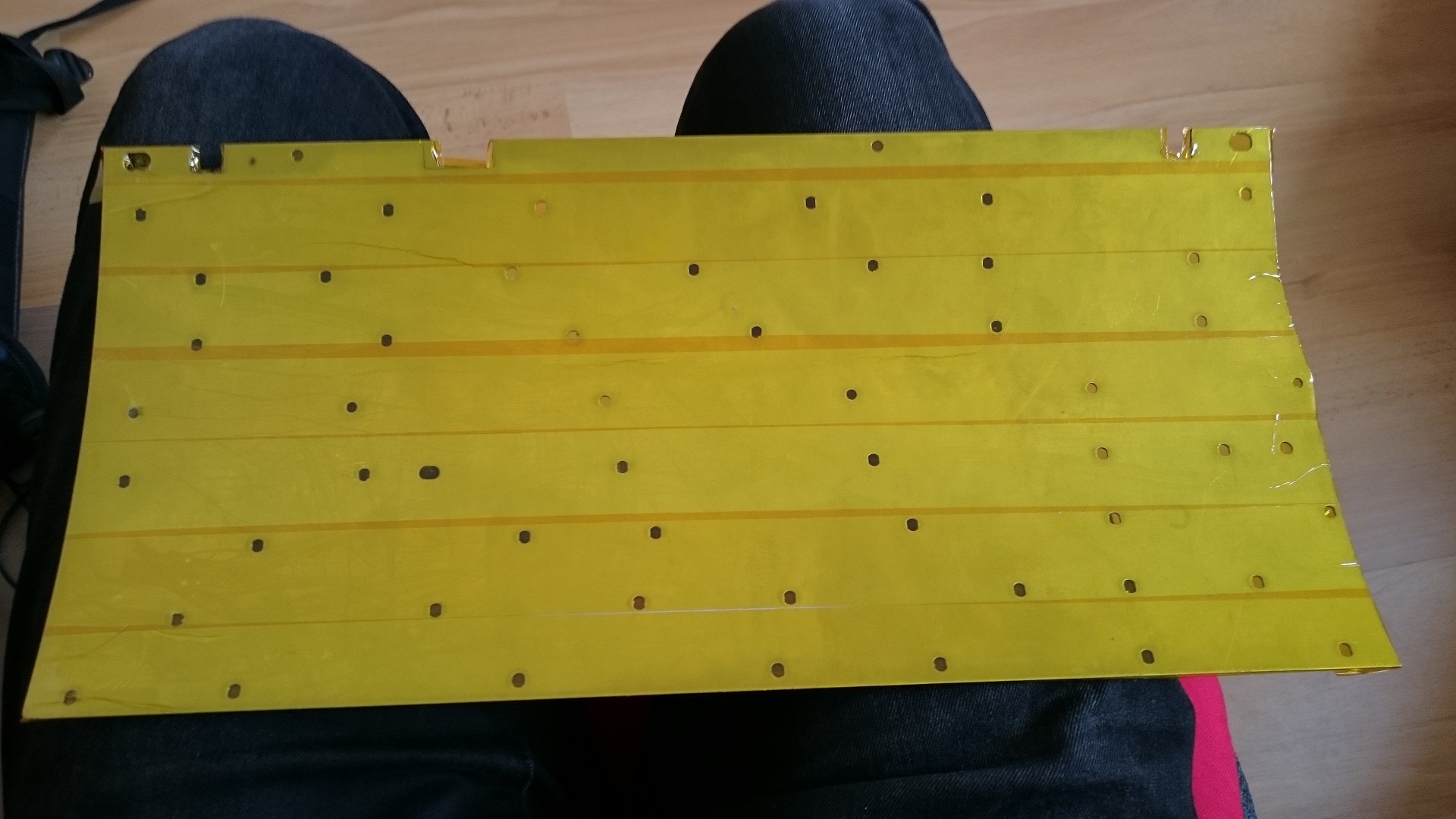

- first, I tried the "elegant" solution, reusing the mat BEHIND the PCB as isolation between it and the plate. The result was a mess, almost all keys registered simultaneously or not at all, depending on threshold

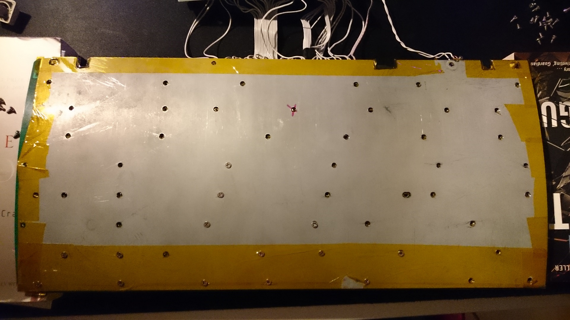

- second try was isolating the plate with gaffer's tape exactly as idollar showed in his manual. This was a huge success, the difference between "doesn't work at all" and "kinda works" :)
- last big success was adding the grounding screw and wire between the PCB, plate and controller as can be seen in the picture. I had kinda forgotten about this grounding the first time and adding this improved the clarity of the signal massively. Now, at about 127 voltage threshold, most keys register fine. I can get 99% keys to function by lowering the threshold to 124, but that adds too much noise so I end up with way too many wrong actuations.

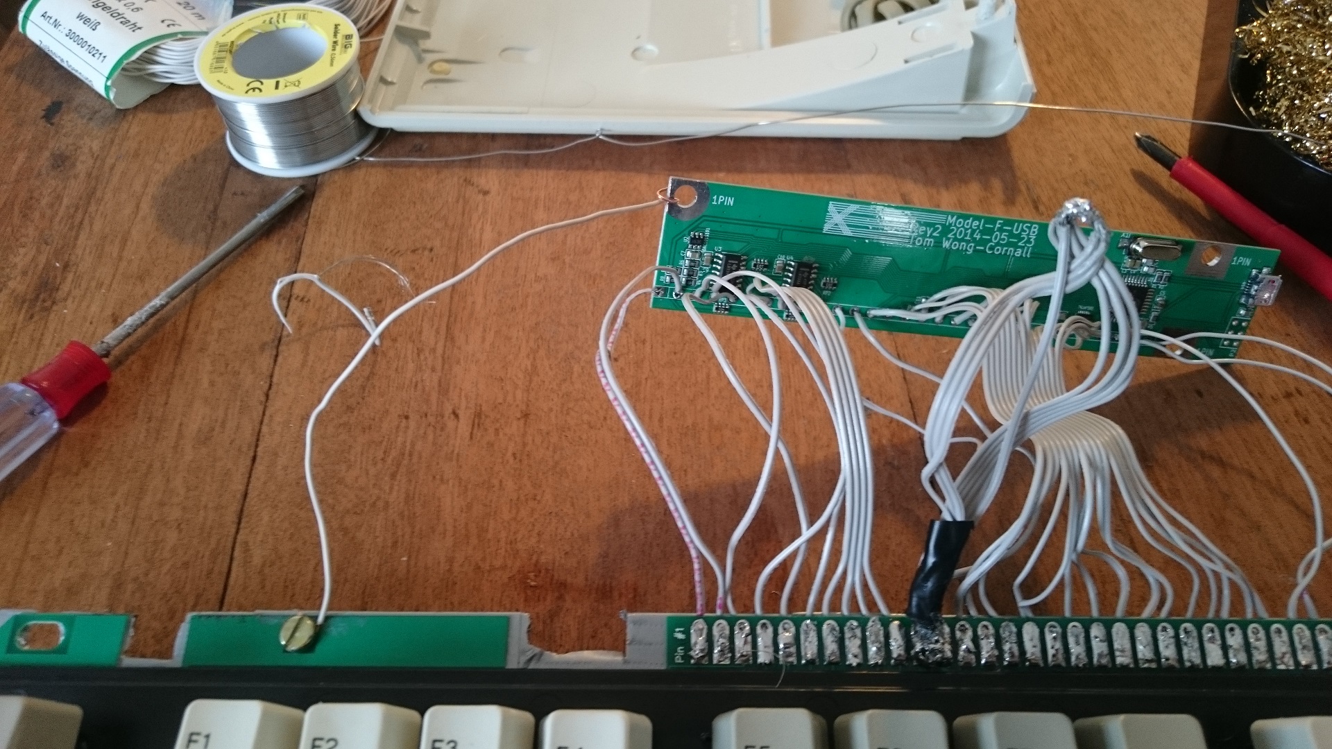

Current status
Current status
The thick cord of little cable strands on the right does nothing to improve grounding. I had kept them as part of the IDE ribbon to stay as close to idollar's manual as possible, but it makes no difference whether I connect it to the grounding pin on the controller, or not.
Now, I'd be really thankful for some comments or advice from people more experienced than me, as I do not know how to proceed to make all keys work.
S, F9 and LCTRL start working at 124 threshold, but that introduces too many incorrect keypresses.
At 127, those above do not work, but most other keys do. However, the escape key seems to fire randomly. Pressing Tilde always actuates Escape as well, but not the other way around.
One or two keys never actuate, but I hope that changing flippers on those keys could fix it.
As for the other keys, any kind of advice is welcome!
Either way, this was an amazing project so far, and even if I can't get it to work 100%, it's really cool to have Model F tech in a Model M. Kudos and and many thanks to idollar and others who helped make this a reality!

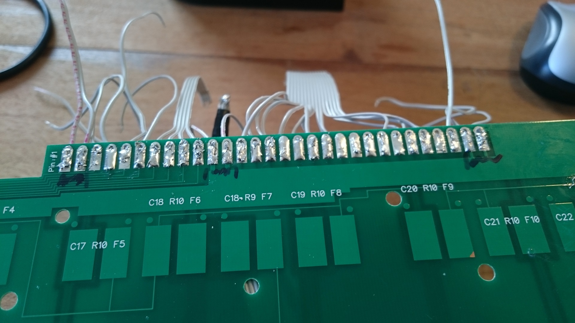

Soldering the PCB
Soldering the PCB

Use Kapton tape for isolation. It's thinner and more consistent. That's what I did. Also I had to ground my Space bar.
shreebles
Finally 60%
24 Apr 2017, 19:00
Thanks for your input XMIT!
Never heard of Kapton tape. Is that it?
Space bar already grounded. At least I hope so, used the little grounding cable that came with my european model M. Looks like this
There are three holes on the controller. Are all three of them grounding pins? Do I need to increase grounding to the controller somehow? As it stands the thick cable is useless, unfortunately...
[ XMIT ]
24 Apr 2017, 20:28
Yep, that's Kapton. Really any polyimide tape will work. Super thin, heat tolerant, and a really good insulator.
Yeah, your likely Greenock M would have an ABS Space bar and already be grounded.
I perhaps over-did it but I just had one extra ground wire connecting the metal plate to one of the grounding holes.
This is all a game of consistency and killing any little voltage differences. If bolt modding make sure all the bolts are at about the same tension, and that the board is the same distance from all the flippers!
FWIW, this is one of the hardest keyboard projects I've ever done. Granted, I haven't restored a Beamspring or a Selectric. It takes patience and multiple tries to get this right.

12 May 2017, 13:14
XMIT wrote: Hooray! I hope I helped here, at least a little bit.
Definitely, you gave good advice and I'm using Kapton now.
So, how did this go? Both good and bad, in the end.
Kapton tape works well. It's really thin, though not the easiest to apply. After applying the Kapton, making sure to go around the corners to avoid the PCB getting contact with the plate at all, I had to make sure to remove the tape where grounding was applied, i.e. at the top where the grounding screw is and at the bottom for the grounded space bar.
Kapton tape improved the treshold at which I was able to use the board without errors... by 1. :D Not much, but it sure didn't hurt. I also found that key recognition improved a bit over time as the PCB settled and conformed better with the rounding of the plate. Possibly grounding was also improved by using two wires, one on the PCB and one on the plate, which were connected with the screw.
What also really helped was adding the rubber mat back to the assembly, thus increasing thickness and overall tightness of the whole plate/PCB/plastic sandwich. I added the mat to the back of the PCB where it would provide only electrical, but not acoustic, isolation.
After that,I was able to find a threshold at which all keys registered, which is fantastic!
Typing feel was mostly uniform, but there were some outliers with a heavier or scratchy feel, possibly due to the barrel plate not being 100% perfect.
However, as I mentioned a few pages back the sound of this board is ridiculous. I did not expect it to be so loud, it is so loud that it distracts me massively while typing. That said, I have been using quiet boards in the last few weeks for use at work so my sense of volume is currently skewed towards quieter keyboards.
So, being in possession of a green prototype PCB from idollar's first run, I decided to try the option of including the mat in front of the PCB, between the PCB and flippers, similar to the original model M design. I hoped to reduce sound by this, and, in some way, succeeded.
I had to lower the electrical treshold significantly (by around 10 or 15) to make all keys work, and at that treshold, there were many incorrect keystrokes registered. Most of them were around the edge of the board. Currently the controller is set to ignore all F-keys and arrow keys, as I have frequent misfires on those switches. I'm currently using the board as a 60% with layers to achieve F and arrow functions. That way, the main alphas all work and register correctly, but the utility of the Tenkeyless sized board is much reduced.
Sound is also much reduced, but not in such a way that I would call it a quiet board.
Unfortunately, typing feel is much worse with the mat, heavier and less smooth overall.
I think I will put the mat behind the PCB again this weekend, just to get the full functionality of this board back, and then decide what to do with it.
My recommendation is to use the mat if your assembly is too loose, behind the PCB. Using it between flippers and PCB is not recommended with the final production red PCBs anyway, but I guess if someone were to try they would have to have a near perfect bolt-modded barrel plate, with perfect uniform pressure across the board, to achieve full keystroke recognition even on the edges of the PCB. This was a problem with my screw-modded version.
I've started floss-modding the springs, and while it will not reduce the DEAFENING volume of the keyboard itself, it will at least get rid of the ping.
In the end, this was a really cool, and fun project. You may lose some sleep troubleshooting the beast but when it works it makes you so happy.

Detailed report coming soon!
I just purchased some Kapton tape. I have to give it a try.
