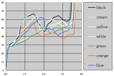

Here is a force-displacement curve for Cherry mx clear:
The curve has the greatest slope of any Cherry mx switch. I like to bottom out my keystrokes, and because of the steeply rising force past actuation, I found mx clears too tiring for long typing sessions.
It would be good if someone could generate force-displacement curves for the various types of Alps switches and post these on the DT wiki.
I've often seen the following composite of force-displacement curves for some of the major categories of Alps, but it would be helpful to see separate curves plotted to the same scale. I am not completely colorblind, but I have difficulty distinguishing certain colors -- therefore, when several plots are shown on the same graph with the curves identified only by color, I start to run into trouble.

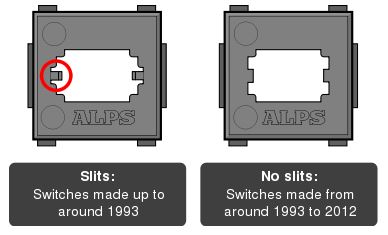

Pine vs. Bamboo SKCM White Alps Switches in Northgate Omnikey 101 ANSI Keyboards -- S/N Correlation:
Recently, I acquired a Northgate Omnikey 101 (ANSI) in pristine condition. However, while testing it, I was surprised to find that the sound and feel of this keyboard were not as good as other keyboards of the same make and model. Upon closer inspection, I realized that the pristine keyboard had the newer "Bamboo" switches (without slits in the upper switch housing), whereas the boards with better sound and feel had the older "Pine" switches (with slits in the upper switch housing).
Here is an illustration of the two types of switches (from the DT wiki):
wiki/Alps_SKCL/SKCM_series
I've done some experiments swapping components from different type of switches into Bamboo white Alps. I have some Orange Alps switches that have the Pine tops. After trying various combinations of sliders, springs, tactile/click leaves, and top housings, I found that for a given spring and tactile/click leaf, the main contributor to the sound and feel of the switch was the top housing. It would be possible to swap the housings with those from Orange switches, but depending on price and availability, it might be cheaper and easier to start with a keyboard in good to excellent condition that already had Pine switches.
Here are some S/N data on Northgate Omnikey 101 US ANSI White Alps keyboards, with an indication of whether the white Alps switches are Pine (with slits) or Bamboo (without slits):
1081779 – Pine (Slits)
1128676 – Pine (Slits)
1132628 – Pine (Slits)
1155854 – Bamboo (No Slits)
1160507 – Bamboo (No Slits)
The lower S/N numbers (presumably with an earlier date of manufacture) have the more desirable Pine switches. It appears that the transition occurred somewhere between 1132628 and 1155854, but certainly keyboards with serial numbers below 1132628 should have Pine switches.
