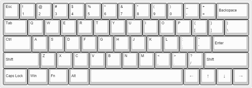

That is the original/regular/large size space bar. It is the only one that will work with the F62/F77 keyboards in their current regular and split right shift variations.
Here's an alternative layout proposal with Unicomp's smaller spacebar offering (slightly updated). This layout requires additional tooling costs to change the PCB, top inner assembly, and inner foam. GH user scumnc recently posted that he's interested in this layout. If anyone else is interested and wants to contribute towards the additional tooling costs, please let me know.
Of course splitting the costs would not be required to get this variation - once the costs are paid for, anyone can order them for the same price as the other F62 units. So if you want his proposed layout at the same price as the regular offering, that is fine too - please post here or let me know over PM.
Bottom row: 1.5, 1.25, 1.25, 1.25, 5.75, 1, 1, 1, 1

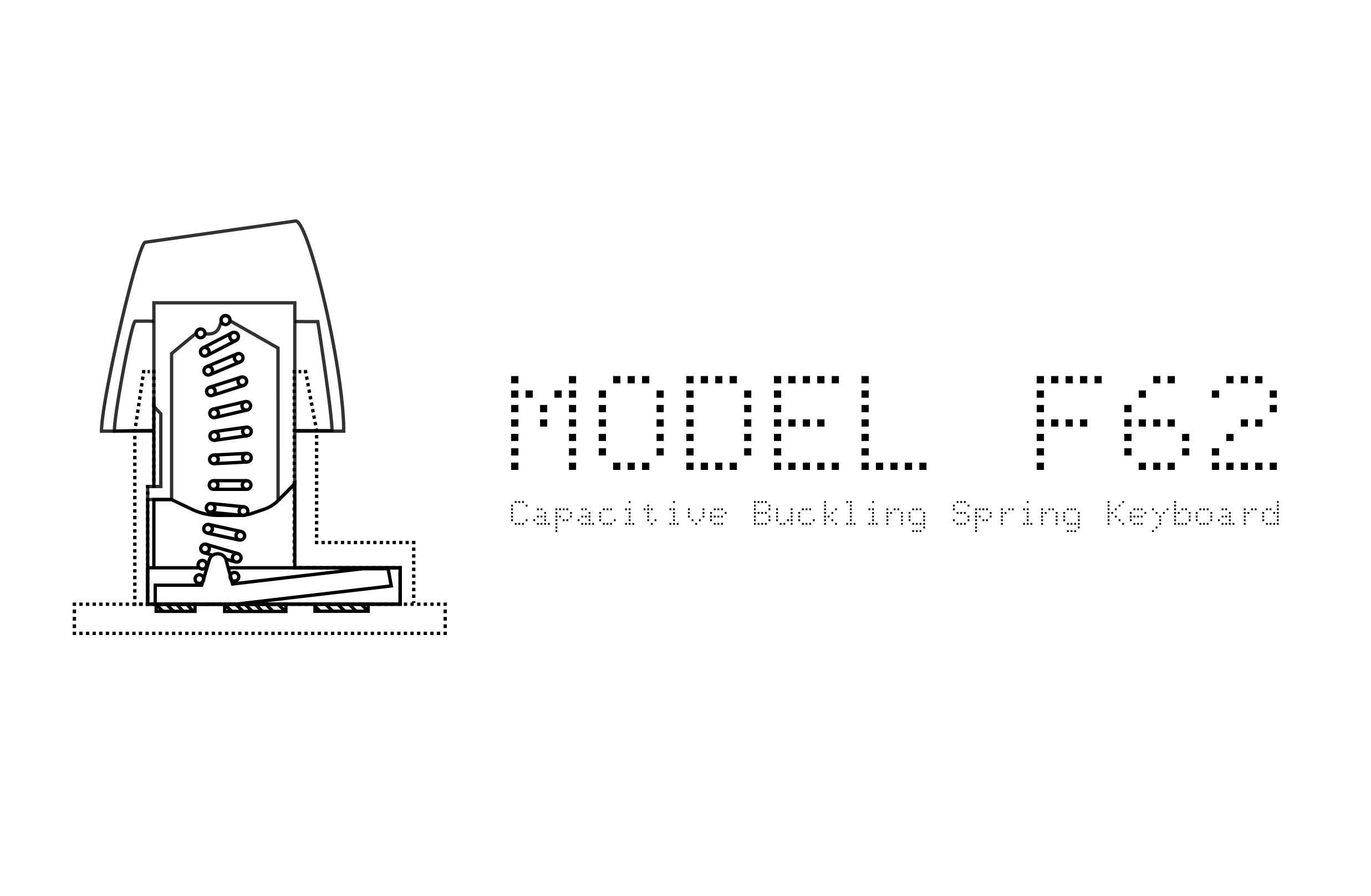

Thanks all for the logo feedback. It looks like the preference is for the blue version of the non-angled text logo, with "ultimate" removed from the subheading. I hope to add this logo to the boxes but it may be too costly. If anyone prefers no logo on the box I may be able to arrange that as well.

Ellipse wrote: So if you want his proposed layout at the same price as the regular offering, that is fine too - please post here or let me know over PM.
I'm definitely interested in this variation, depending on the tooling costs.
Posted: 17 Jan 2016, 04:43
by bhtooefr
Expedited shipping is unnecessary for me, but the new layout with arrows is damn close to my dream 60% mechanically. Not sure I'd be willing to pitch in for tooling, but I'm interested at least at regular price.

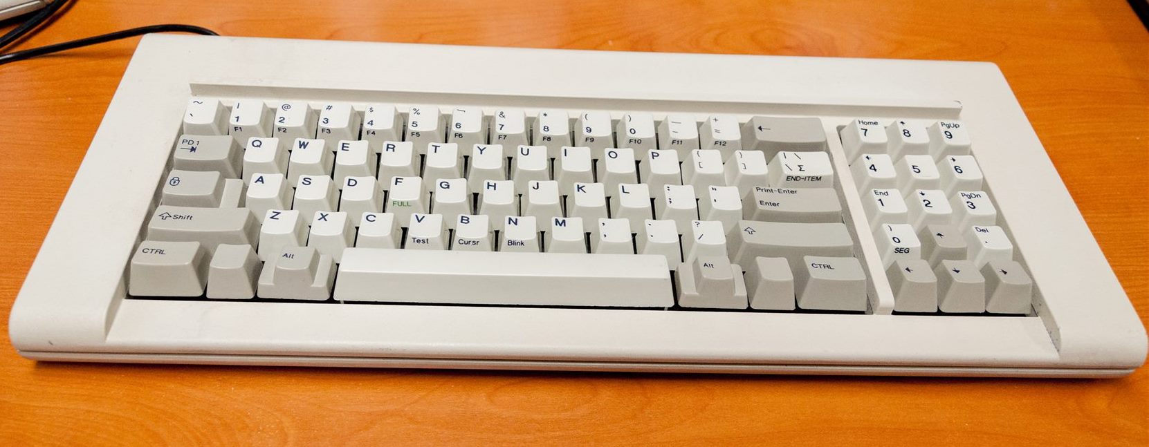

Is this the default layout (non-HHKB version) you think most people would like for their F62/F77? Of course it would all be regular keys, not the pictured keys and stepped Alt keys. Would most Kishsaver users not getting HHKB split right shift prefer the split backspace with a 1U backspace and a 1U "~ `" key? Should the upper left key be ~` or Esc as the default? Of course you can switch it to other layouts if you want once you have it.

So, this is a variant on scumnc's layout that's closer to what I want. Any other interest in it (instead or in addition)?
(It's worth noting that the reason Alt and not Ctrl is the 1.25 U key, is because if Fn and Ctrl are the same size, they can be swapped easily. Also, Mac layouts will work well with this bottom row configuration.)

bhtooefr wrote: So, this is a variant on scumnc's layout that's closer to what I want. Any other interest in it (instead or in addition)?
Yes I would like this layout. But is that a 5.75u Space bar? Can that length be made?
I would likely make a few small changes concerning key placement (Esc instead of ~, Ctrl moved to the left edge), but overall this is an amazing layout.

gnarlsagan wrote: Yes I would like this layout. But is that a 5.75u Space bar? Can that length be made?
For what it's worth, this is mainly the mechanical layout I was worried about, as that's what Ellipse would have to tool for. Which key is in which position, he wouldn't have to tool for. I didn't optimize the legends as that wasn't necessary (in fact, the keyboard that this was based on had Esc instead of ~, it had Ctrl where Caps Lock is, and Caps Lock where Fn is). Also, correct me if I'm wrong, but I believe ISO is also possible on this layout with no tooling changes, just different key caps and moving hammer/springs around.
As far as the 5.75 U spacebar, Unicomp has two current sizes - 7 U (used on 101/102 and 103/104-key keyboards) and 5.75 U (used on 104/105-key keyboards).
