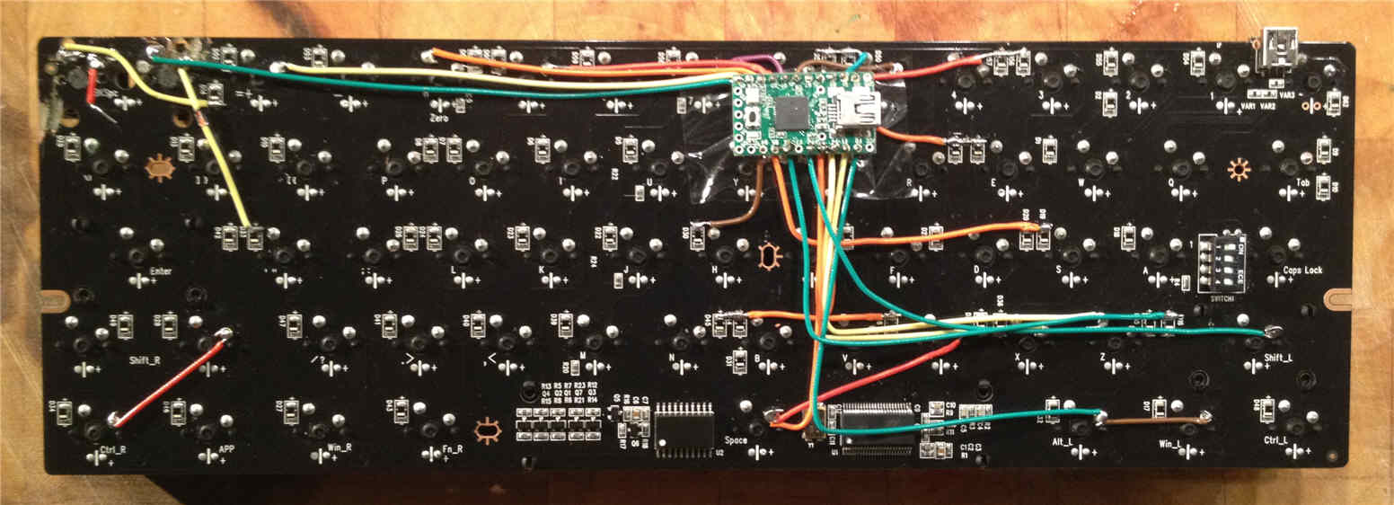

After connecting all the rows and columns to the Teensy I get the following result:
- Teensy added
- IMG_2543.JPG (92.82 KiB) Viewed 23327 times
