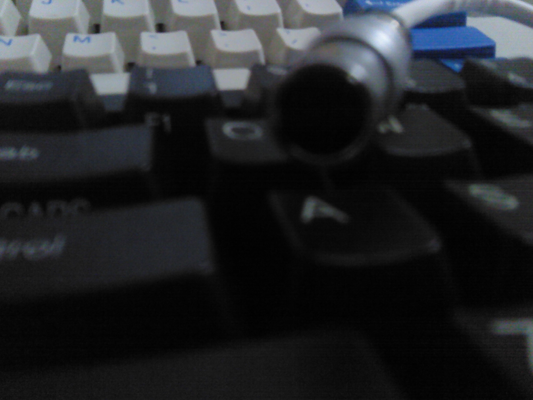

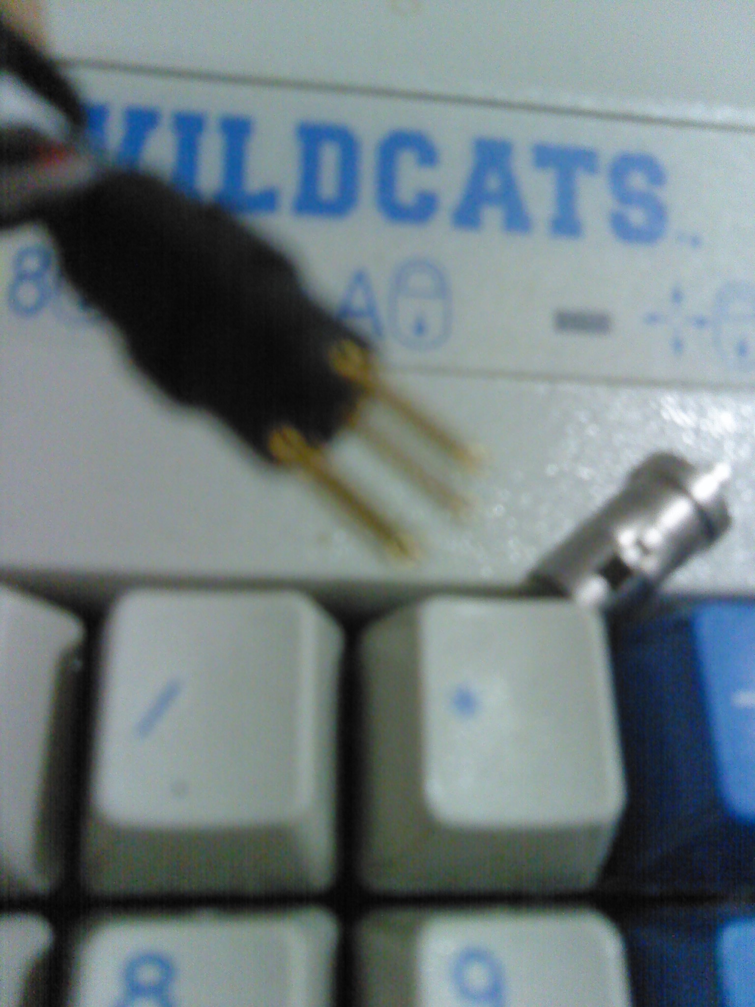

it's definitely five pin. not four. customized. got the casing shell off of it. whether it will fit, remains to be seen.
i don't have a digital ps. just a phone. sorry
- Image0 (1).jpg (415.51 KiB) Viewed 6444 times
rodtag mind the background. besides, since when unicomp customize (electrical components) its wildcats version?rodtang wrote:HHKB? What you have there is a Unicomp Model M...
let me try another picture guys. my apologies.

That almost looks like 270 degree DIN-5. What an odd connector to find.
Is the connector physically larger than a PS/2 connector?

That's a 270 degree DIN 5-Pin. They can be found e.g. on 122-Key Terminal Model Fs. After looking more closely on the picture it really seems to be one of these. The 270° plugs I've encountered were really heavy duty, full-metal, with a screwring on. Looking on the second picture, that looks like full-metal with a screw ring.Daniel Beardsmore wrote:http://deskthority.net/workshop-f7/xt-a ... 0-120.html

The last pic shows it to be less than the width of the top of a keycap, which means it's probably mini-DIN sized.

Could you shine a flashlight into it when taking the photo, or hold it up facing a window?chimborazo wrote:still not good.
And keep back from it – cameras can't focus up close (less than 30 cm/12 in or thereabouts) unless they have a macro mode.
daniel. the picture doesn't work. the pins sit at the bottom and with this phone theres nothing i can do...
one way to describe it- think ps/2 just slightly smaller.
is there a list with clear pictures (haha the pot calling the kettle black) so i can see all adapters that have been made so far.
heck. looking at it one more time, one of the six holes is empty. and probably one of the pins could have broken off
soarer. im far sighted. but i just looked at it. and i guarantee you that there's none. unbelievable.
