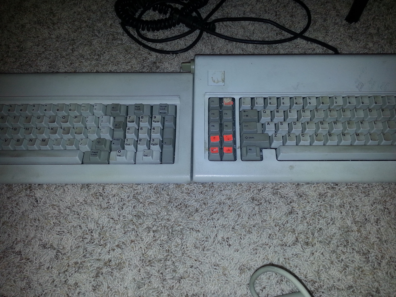

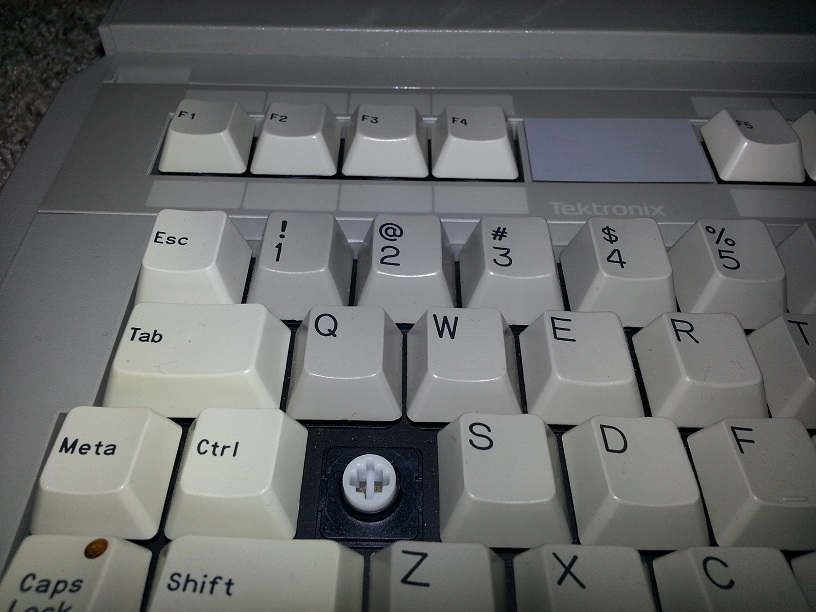

Wasn't sure what all I was getting. Need a bath obviously. I guess 5 is a Brother Switch. Very heavy. Picked up another IBM not in these shots that's not as heavy but bigger. Same switch.

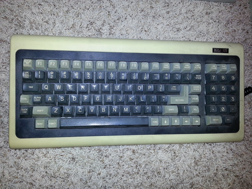

Not sure about 4. I've seen one posted somewhere. It's stiff and linear.

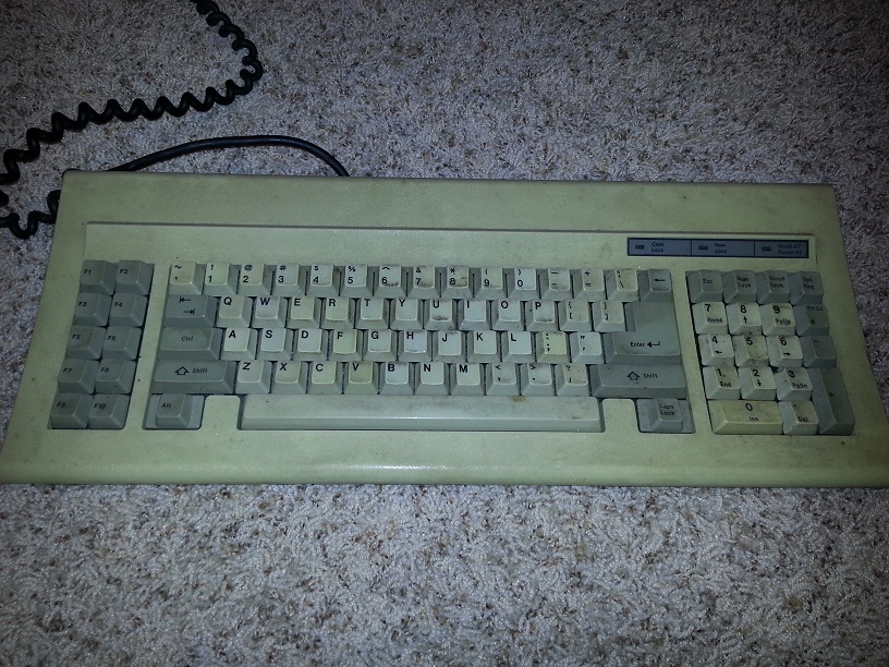

- tactile but very stiff
- 8a.jpg (161.29 KiB) Viewed 9876 times
- Chicony KB-5160AT Taiwan

#4 is a heavy variant of linear Futaba (though might be a George Risk version).

The "Model 925" has the same switches as many BBC Micros (it's the "Type 1" Beeb switch, the most common type). No clue who made it; it's a rock solid reliable medium weight linear switch with a virtually silent downstroke and loud upstroke that gives you a "lagged" sensation (every keystroke emits a delayed sound).

5/5a is an IBM Model F with capacitive buckling springs – you've even got a photo of the buckling spring. You should find that it pings like crazy. The difference between the Model F (capacitive) and Model M (membrane) is the electrical contact mechanism.grave00 wrote:I thought those were Brother Switches, not like Model M.

It actually feels pretty good. Probably the nicest after the Alps or the springs maybe depending on preference. It's missing the uppermost right key though. I'm having trouble getting the slash to the left of it on correctly after pulling it. Those two are different than the majority of the keys.Ascaii wrote:Middle row, third from the Top. Its an old apple keyboard.
The keycap has a slide that drops and a small spring sits down inside. I can't quite get it back the way it was. Right now it's sitting up too high.
So I think I figured out that the one IBM is a model F from an XT? What is the other one typically called? Just IBM model AT? Too bad the emblem is off it. Wonder if you can find just that piece somewhere. I see Daniel has beat me to the punch on the F.

The one with the IBM badge is the Model F AT: the PC/AT keyboard protocol introduced with this keyboard is bidirectional and it provided support for the LEDs on the keyboard which you can see. Very desirable board!grave00 wrote:So I think I figured out that the one IBM is a model F from an XT?

The one with the badge will be an older model F — requires a converter from (presumably?) XT to USB, someone like Soarer or HaaTa should be able to advise.
The one with the badge missing is the PC/AT model F, that should just work with PC/AT→PS/2, PS/2→USB. In theory anyway. I know the Model M is infamously flaky over PS/2 to USB. (Never owned one — they sell for more than I'd want to pay for something I would only use for fun.)

Here's a pic of some of the Futaba switches, the white one is from a Model 925, and the black "sealed" one is from a mini keyboard of sorts (that I forgot to take pics of...). Internally, they are the same switch.
Which has the same internals as:
Which I know as Futaba MD-4PCS as per http://www.electronicsurplus.com/Item/1 ... 20MD-4PCS/
Now, I do have some more variants around somewhere...
Oh, here's a mini version of the switch
Bah didn't get any more pics...
Anyways, I sent Icarium a bunch of the loose switches I had. He should have examples of all of the variants on hand. Mine are in a box in Canada.

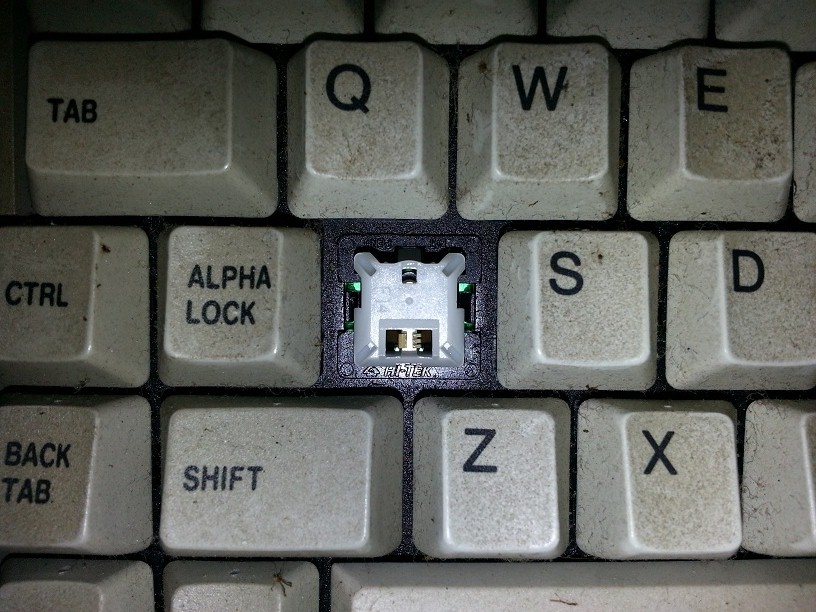

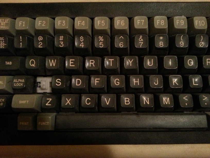

I'm wondering, what are the switches of the TeleVideo keyboard (picture #6 and #6a)? I've just received a verrrry dirty Philips board having the same switches.
edit: ....... ah, I have to look more closely. It's Hi-Tek.

I meant the switch. According to HaaTa they're (really old) Futaba switches.
HaaTa: you get to do the honour of splitting up http://deskthority.net/wiki/Futaba_switch into multiple pages for the different switch types ;-)
- Daniel Beardsmore
- Main mouse: MS IMO 1.1
The large white and large black switches have quite different internals according to your photos. The metal parts for example aren't close to the same shape.HaaTa wrote:…
Also, the version on the BBC Micro is different again — it's a lot more like the mini version (long screw-in pins, bulky bottom plug) but with the tall, round style.

Interesting. I guess it's time to start hunting for patents! And manufacturing dates.
Not in my pics, but there is definitely a George Risk branded version as well.
I think it was this one, but it was a different colour, definitely had GRI branded on the side.
http://www.grisk.com/pushbutton/kbm-lp.html
