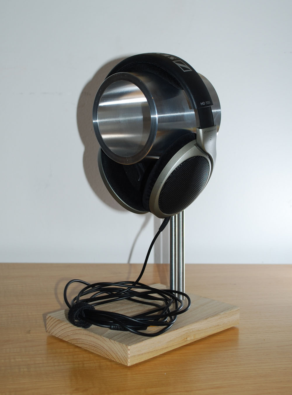

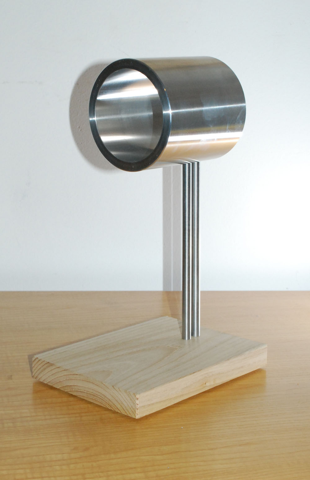

Took a bit longer but here are some photos.
Headphone stand empty
Headphone stand with Sennheiser HD555
Aluminium is a fingerprint magnet :). It would be even worse if I had polished it.

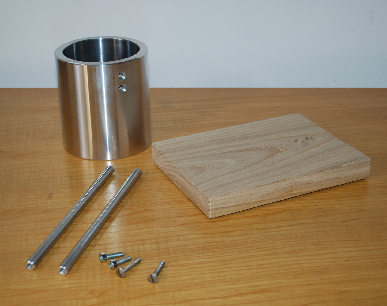

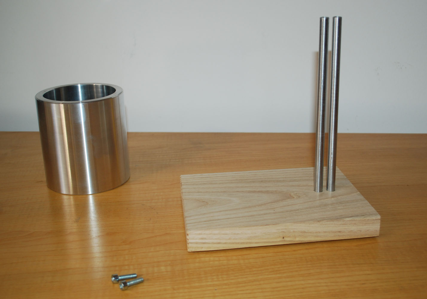

Some more photos of it in assembly.
All parts
All parts

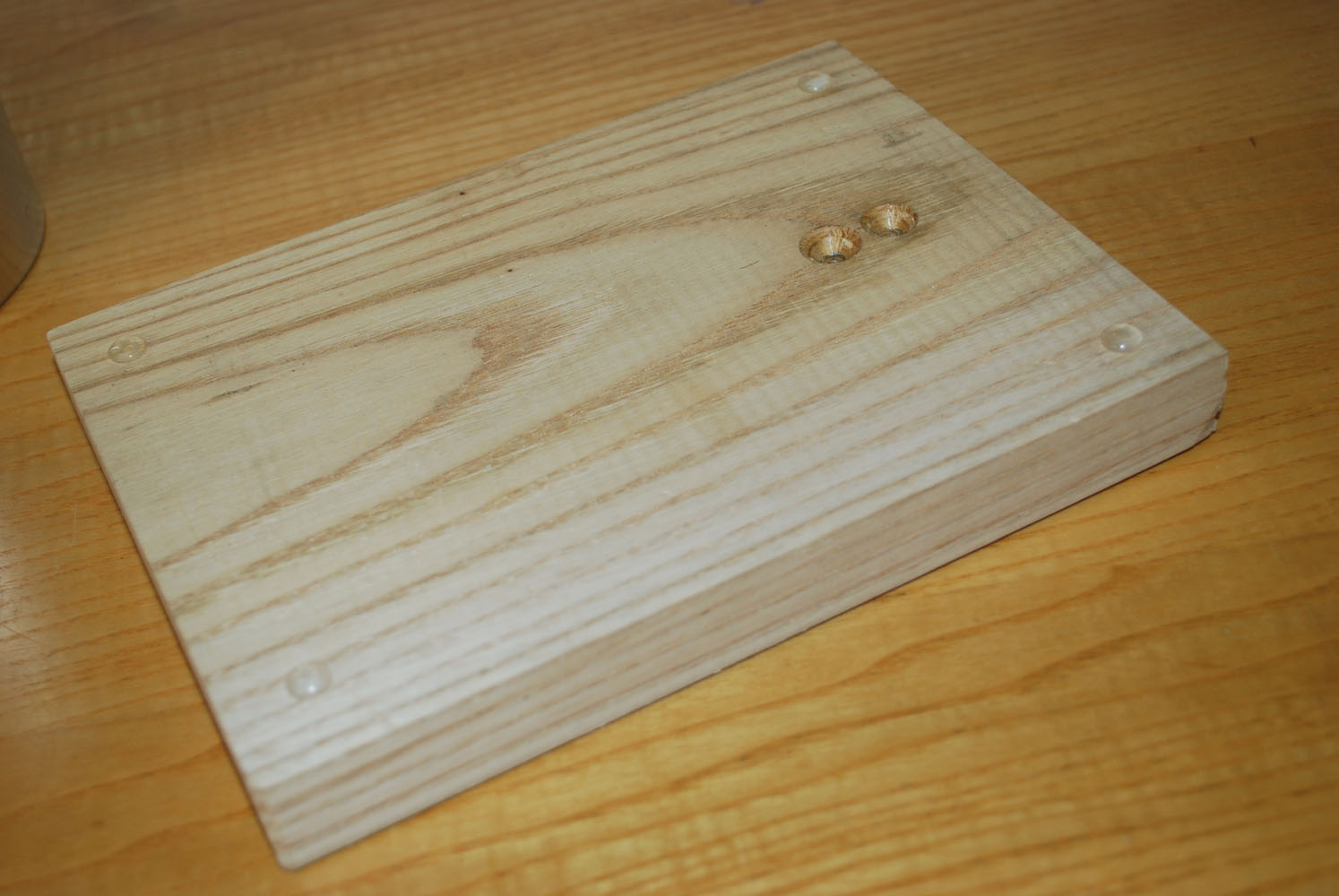

Base is made of beech wood. Its about 200x150x25mm in size. Holes for supports were made with counterbore drill for M5 socket bolts. On bottom side I used countersink drill so bolts don't stick out.
Bottom view
Bottom view
Supports are made from aluminium 10mm stick with M5 thread on both ends. Supports are about 200mm long.
Partially assembled
Partially assembled

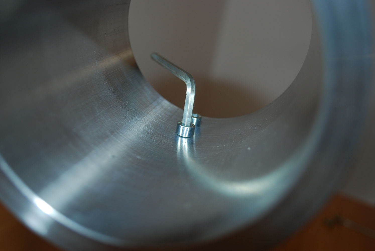

Upper portion is made out of 110mm thick-walled aluminium pipe about 120mm in length. Holes for bolts were made with same counterbore drill.
Bolts
Bolts
Aluminium pipe was in bad shape when I found it but I was lucky enough that my father knows a guy at workshop and he made it a bit nicer for free :) I had all materials at home but hex socket bolts.
Total cost was 0.09€ (for hex socket bolts)

zoidbergslo - looks Brilliant and it cost you next to nothing!
Great work, i might try something similar soon once i get rid of the backlog of other projects!

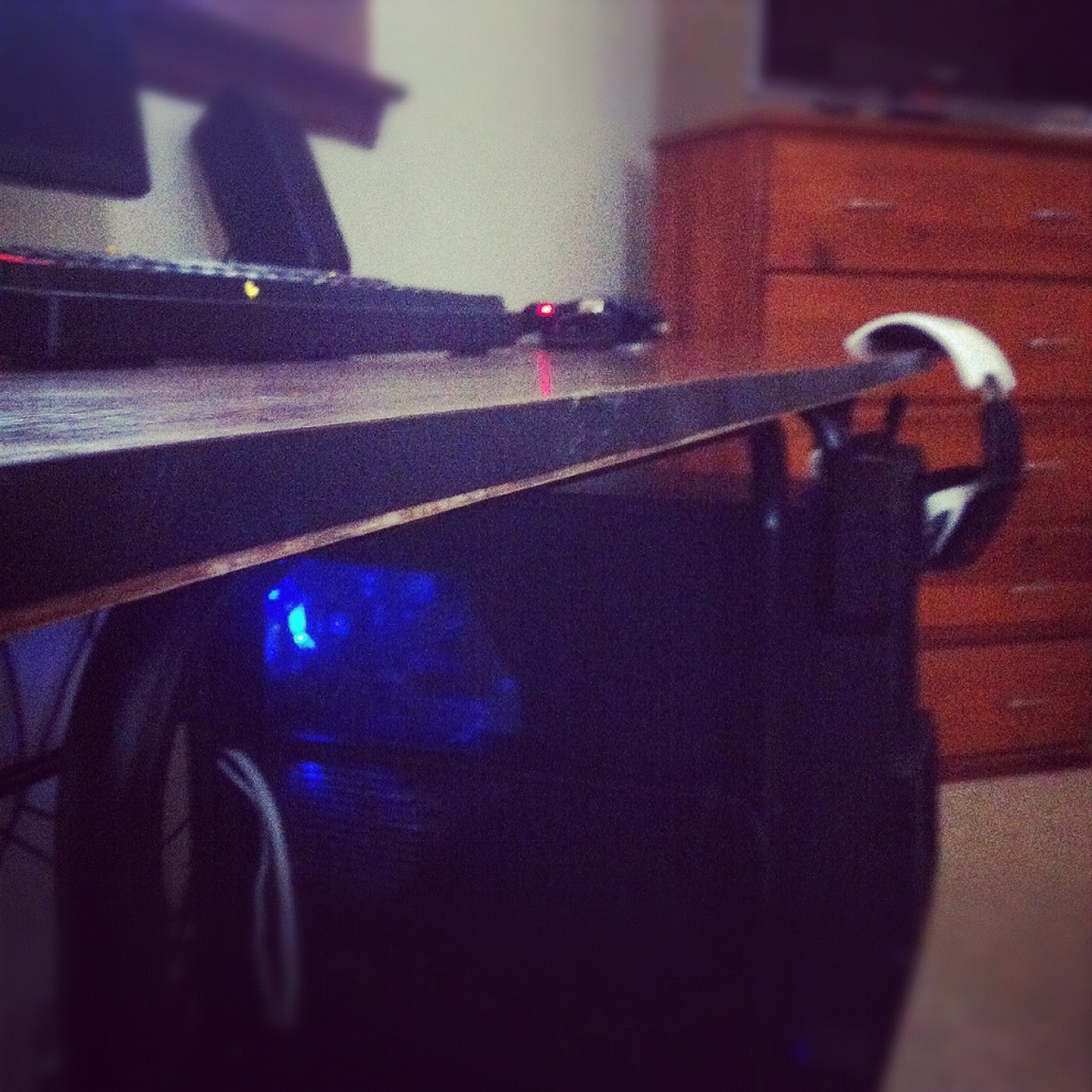

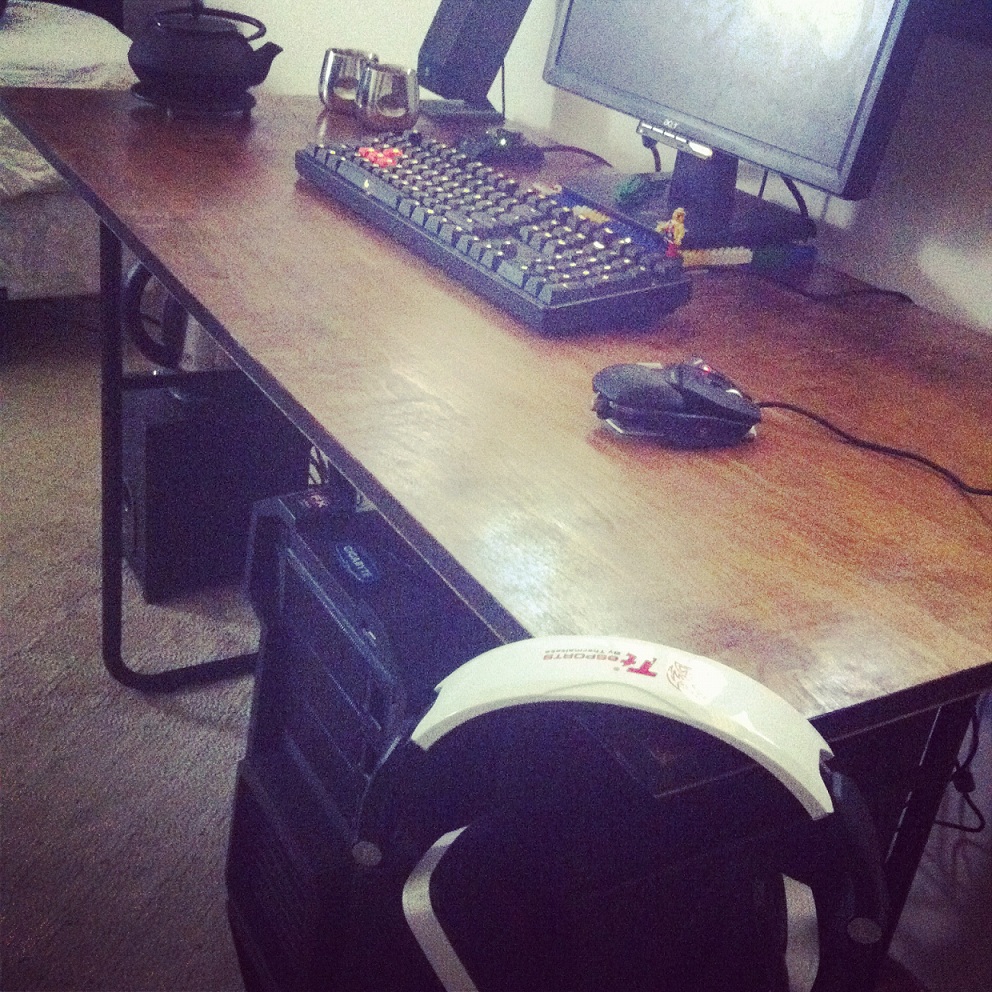

instagram cant save my bad photography skills.
ShuttleMunky
26 Jul 2012, 15:30
Theres my Ducky shine! Orange leds.. And Brown switches?
Smoothers
26 Jul 2012, 20:53
ShuttleMunky wrote:Theres my Ducky shine! Orange leds.. And Brown switches?
blues to be exact lol

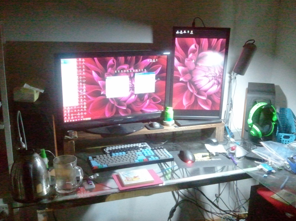

this is mie.
ah slightly different than mine then :P
how do you like the feel of keycap surface? For me they feel great and i thikn they are better than most gratified pbt caps.
Smoothers
29 Jul 2012, 21:17
plastics great, love the matte black dry feel over glossy keys I'm used to. I hope they never get glossed from wear.

imsto wrote:this is mie.
Very nice, what are your specs? (especially monitors)
